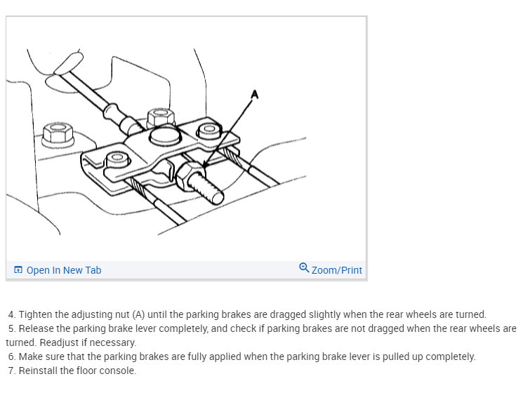

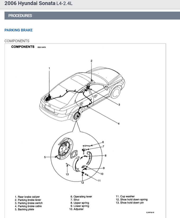

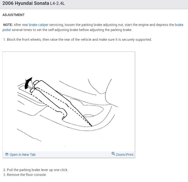

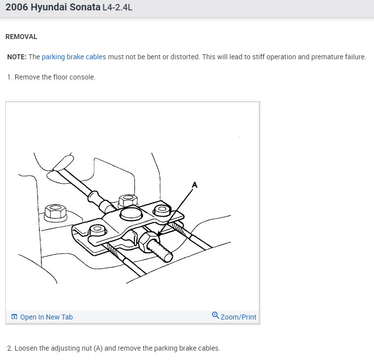

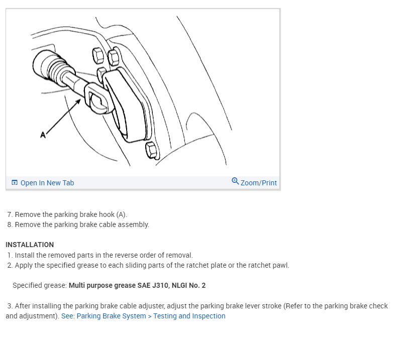

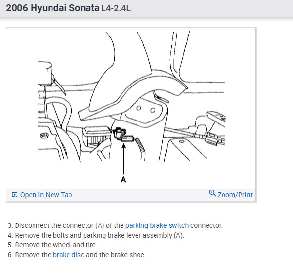

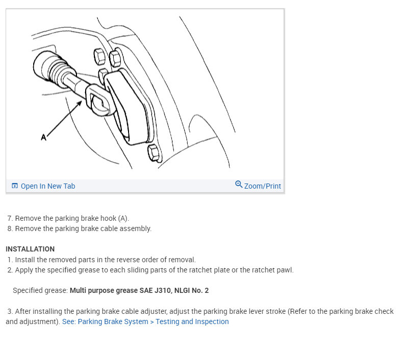

I recently replaced my rear pads and rotors, as a result I ended up having to replace my parking brake shoes and hardware. I can no longer get my parking brake to engage. I have adjusted the star nut as well as the adjuster at the hand brake. While adjusting at the hand brake I noticed there is play in the cable running to the driver's side. is there a way to adjust this cable or will it need to be replaced?

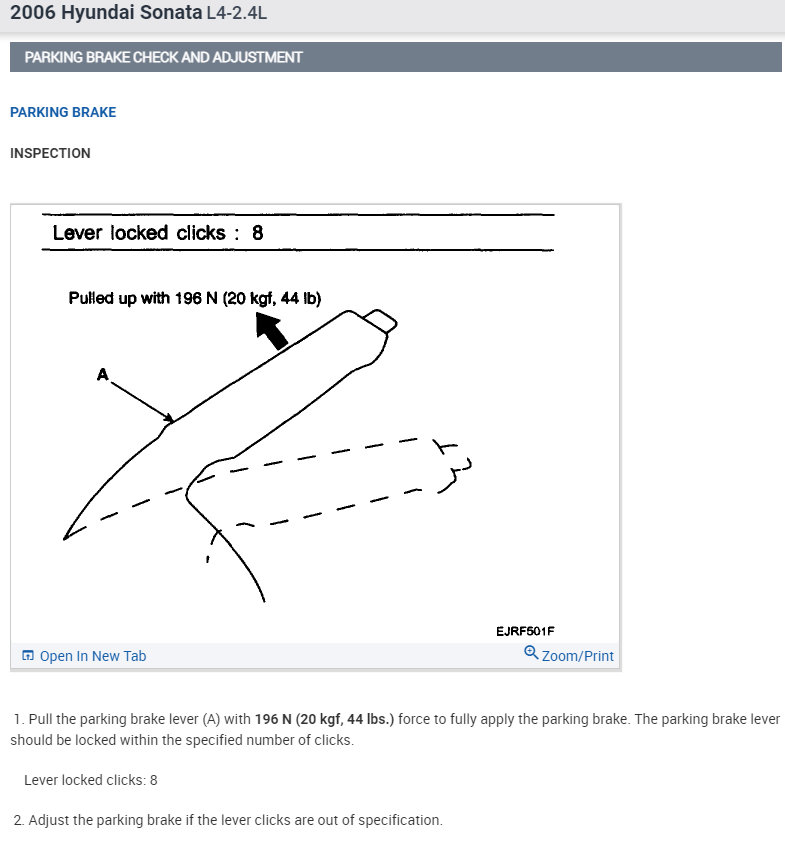

It is possible that you could have missed a step and that's why it is not engaging.
Here is a helpful guide:
https://www.2carpros.com/articles/parking-brake-shoe-replacement
I have attached the parking brake adjustment as well as cable diagrams below. Take a look at it and see if you have missed any step.
