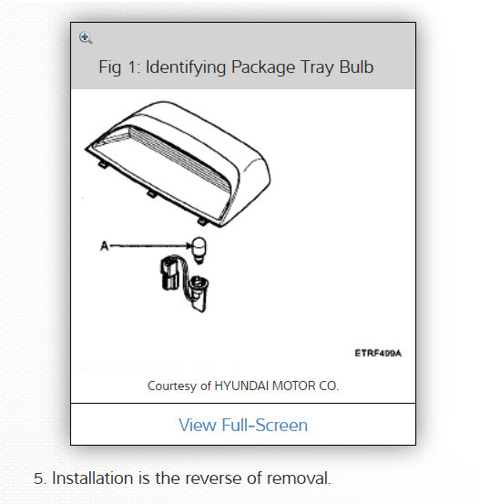

Hi, How do I gain access to the bulb on the rear window for the brake stop light?
Tuesday, August 31st, 2010 AT 12:19 PM
5 Replies
BLUELIGHTNIN6
  • 16,542 POSTS
This guide can help with instructions below for your car.
https://www.2carpros.com/articles/brake-lights-not-working
1.) unplug the connector in the trunk.
2.) remove the 2 gold-colored screws with a phillips head screwdriver from inside the trunk. They can be seen from the trunk. 1 is thru the larger square opening where the wire connects to the 3rd brake light. The 2nd is on the right side thru a small (screwdriver width) hole covered by a piece of foam tape stuff.
3.) after removing the 2 screws, go inside the cabin and the brake light housing pops right up.
4.) disconnect the bulb from the housing while inside the cabin.
5.) in the trunk remove the wire and bulb. (it's about 5 inches long. the wire from the connector to the bulb socket)
6.) reverse steps to install.

9. Change the single 3rd brake light bulb ( p/n 912)
