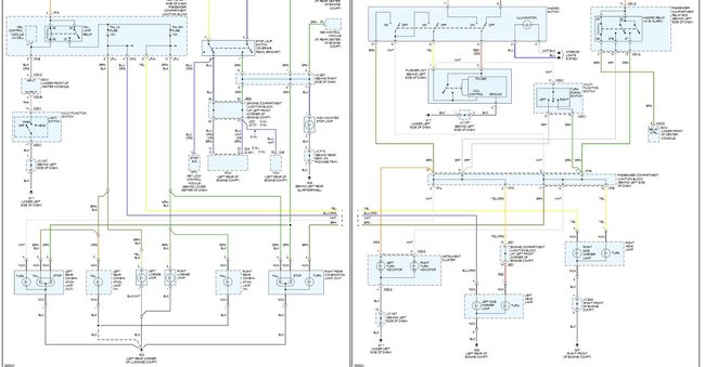

The third brake light works but the other two do not. fuses look ok. I'm looking for a wiring schematic so that I may pinpoint some common areas . Any help on where to find the info? or where to start looking?

Could be something as simple as the brake light switch, but test the fuses with a test light, don't just look at them
Read the guides below on testing wiring and using a test light, they will help

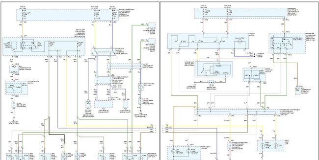

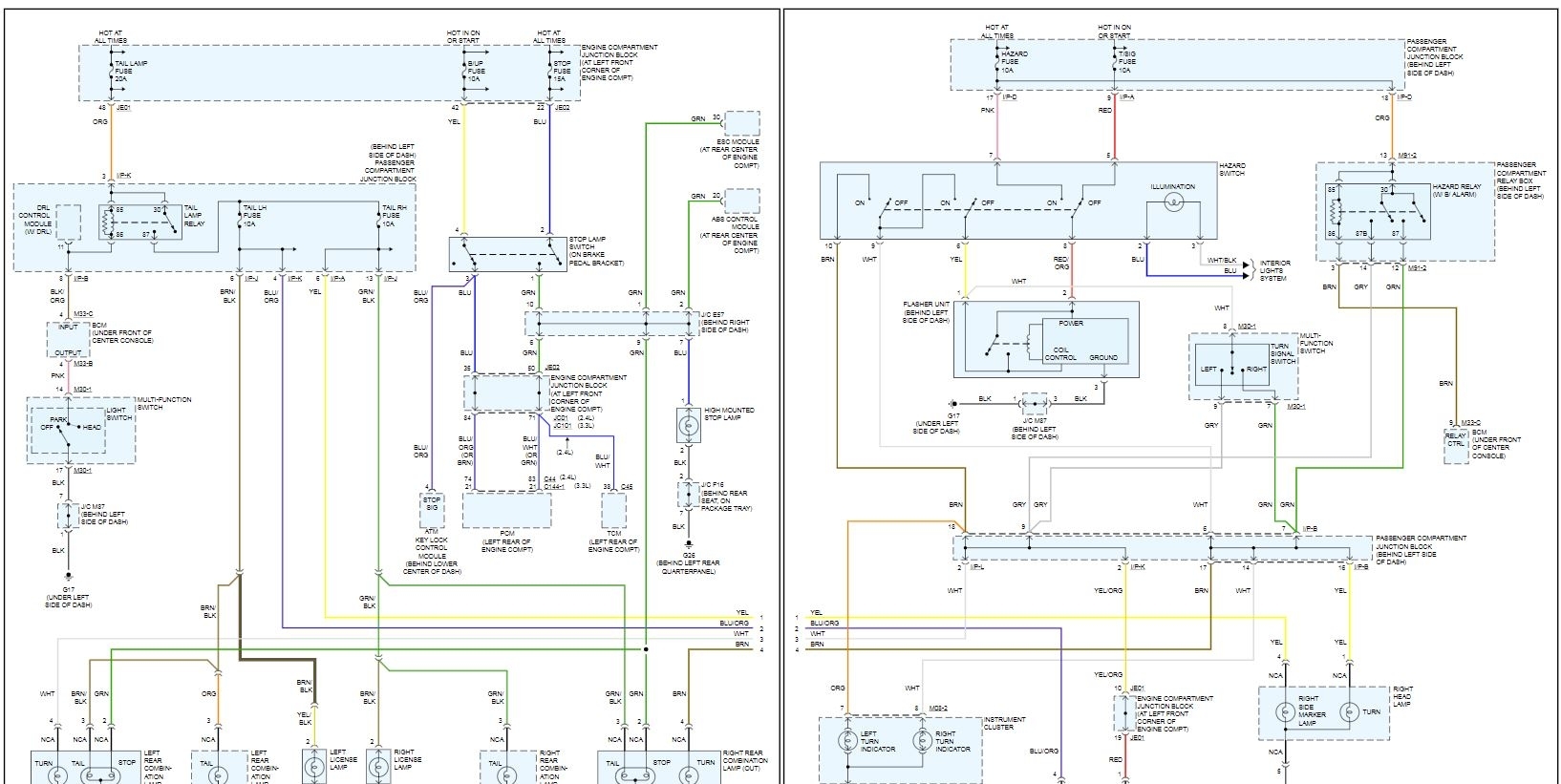

The wiring diagrams for all of the exterior lights in your car area attached below
