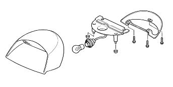

Lt the Rt brake lights burned out and then the center high at the rear window went out. I cannot find how to get at this light to install a new bulb. I would like to get information as to how to resolve this problem

2006 > G 2.7L V6 > Body Electrical System Removal 1. Disconnect negative battery cable. 2. Open trunk lid. 3. Remove two nuts that attach light assembly to vehicle. 4. Disconnect electrical connector from light assembly; remove light assembly.
https://images.2carpros.com/forum/automotive_pictures/55316_bt1a365a_1.gif
Replacement 1. Disconnect negative battery cable. 2. Open trunk lid. 3. Remove socket from light assembly. 4. Remove bulb from socket. 5. Install replacement bulb in socket. 6. Connect negative battery cable. Installation 1. Connect electrical connector to light assembly. 2. Position light assembly on package tray. 3. Install two nuts attaching light to vehicle. 4. Connect negative battery cable.
