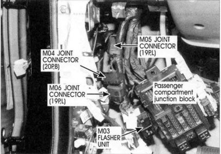

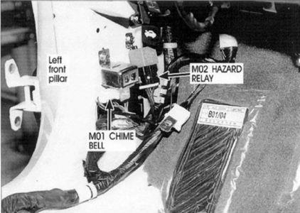

My Directional signal and 4 way flashers died this morning. I checked the fuses and both the 10 Amp fuses under the dash were blown. The only thing that I can think of that will cause that would be the flasher to go bad and I see the santa fe has 2, but I can't find where to install them. Where do I find the flashers so I can replace them?
Feb 18, 2010 at 4:37 PM
BLUELIGHTNIN6
  • 16,542 POSTS
the flasher unit is located behind the passenger compartment junction block, on bracket. the hazard relay is located behind the left kick panel.

this should clarify things a bit more..
https://images.2carpros.com/forum/automotive_pictures/261618_Noname_1709.jpg
https://images.2carpros.com/forum/automotive_pictures/261618_Noname2_540.jpg
