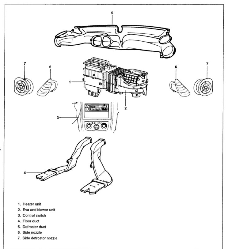

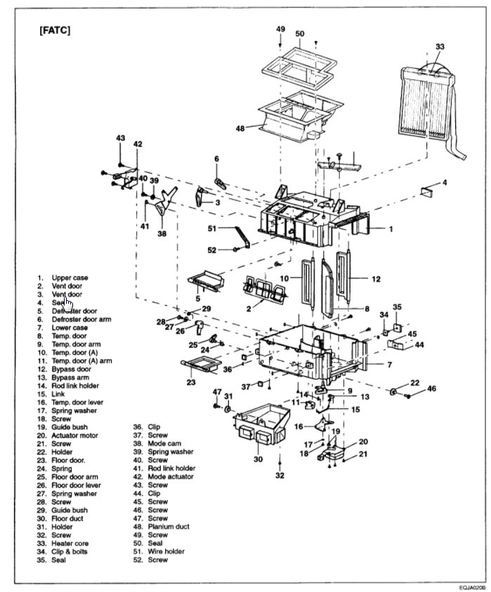

how to replace heater core what i need to do ? does whole dash need to come out? Can you help me?
Aug 15, 2010 at 10:33 AM
Unfortunately you do. Here is a video that will help with this. This is for an evaporator but it is the same basic area and process.
https://youtu.be/25QqPO0SQsU
I also attached a number of documents that show the same material. Let us know if you have other questions. Thanks
