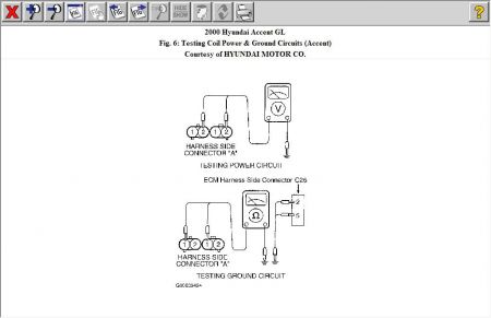

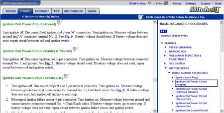

Can you tell me if there is a way to test the coils on a
2000 Hyundai Accent, 1.5 SOHC. I have a NEW computer installed and someone else told me NO FIRE at the plugs was likely the Crank Position sensor, so I replaced that also with the same result. I am running out of ideas to try but would surely be BLESSED to have this gas saver going again.

Do below
https://images.2carpros.com/forum/automotive_pictures/12900_2000_Hyundai_coil_testing_1.jpg
https://images.2carpros.com/forum/automotive_pictures/12900_2000_Hyundai_coil_power_testing_1.jpg
All you got left is the ICM after this.
