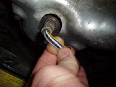

I need to replace my o2 sensor. Looking at the front sensor I can clearly see there are 5 wires coming out of it. However, when I search various auto parts websites, most are selling o2 sensors with 4 wires and yet they claim that these are the correct items for my vehicle. Could these 4 wire sensors work and what is the difference? I have found some that sell 5 wire sensors but they are considerably more expensive. Is the difference worth it? I live and drive in AZ if that makes a difference.. Thank you

Your car is probably the SULEV type they use a leniar O2 where others use heated 4 wire. You should check with dealer Federal Law states Mnaufacture must repair any polution devise for 10 yrs. 100K miles.

Thanks, but actually the engine is not the SULEV type but a 2.0 L DOHC 16-Valve CVVT engine. In this case, would a 4 wire o2 sensor work?
I did speak to the dealer, but they said it was not covered.

On that engine my info shows both front and rear O2 are four wire. Should be a black-Green-White_Pink wire
What colors are yours?

The colors are White, Black, yellow, Gray, and Blue. I attached a picture if that helps. Thanks

Follow harness to connector what is wire color after connector?
