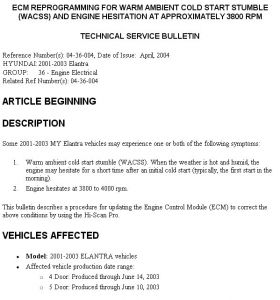

I have noticed twice today that, after starting, the engine will sputter for a few seconds and then die. When I try again the second time it is OK. So far, this problem only occurs after the car has not been in use for several hours. I have no problem as I drive.
I should also note that a few days ago, I experienced that after starting, the car will not accelerate for a few seconds after stepping on the gas pedal for the first time. After it "kicks in", there are no further problems. This also occurred only after the car has not been in use for several hours.
I took the car to my dealer and they scanned for any codes but found nothing. They checked the induction system and found it clogged up. They cleaned it up and also added a fuel injector cleaner. Things were fine for a few days until today's problem.

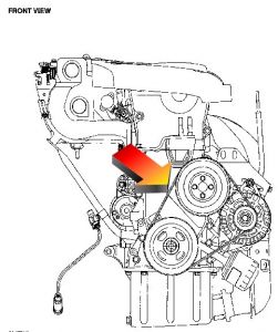

P.S. Forgive me for this stupid question since I am not a mechanic, but are timing belts and serpentine belts totally different things? Also, what else should I look out for with such high mileage on my car? I recently had to replace all four struts, the intake manifold gasket and the valve cover gasket.

See if the technical service bullitin applies to you:
https://www.2carpros.com/forum/automotive_pictures/30961_hyun_1.jpg
IF the car falls into this, then a reprogramming may take care of it.
The serpentine belt is on the outside of the engine that runs your accessories.

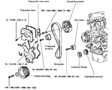

The timing belt is behind the serp belt and covered with the timing belt cover.
https://www.2carpros.com/forum/automotive_pictures/30961_hyuntim_1.jpg
The timing belt should be replaced every 60,000 miles. If it breaks, good chance it will cause serious damage to the engine pistons, valves or cylinder head as the engine is what is called an interference engine.
