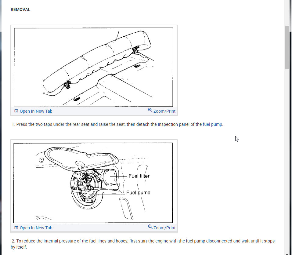

the car will turn over and fire but wont start. I think the fuel pump went out. how can i check it and replace it?
Sep 29, 2008 at 4:02 AM

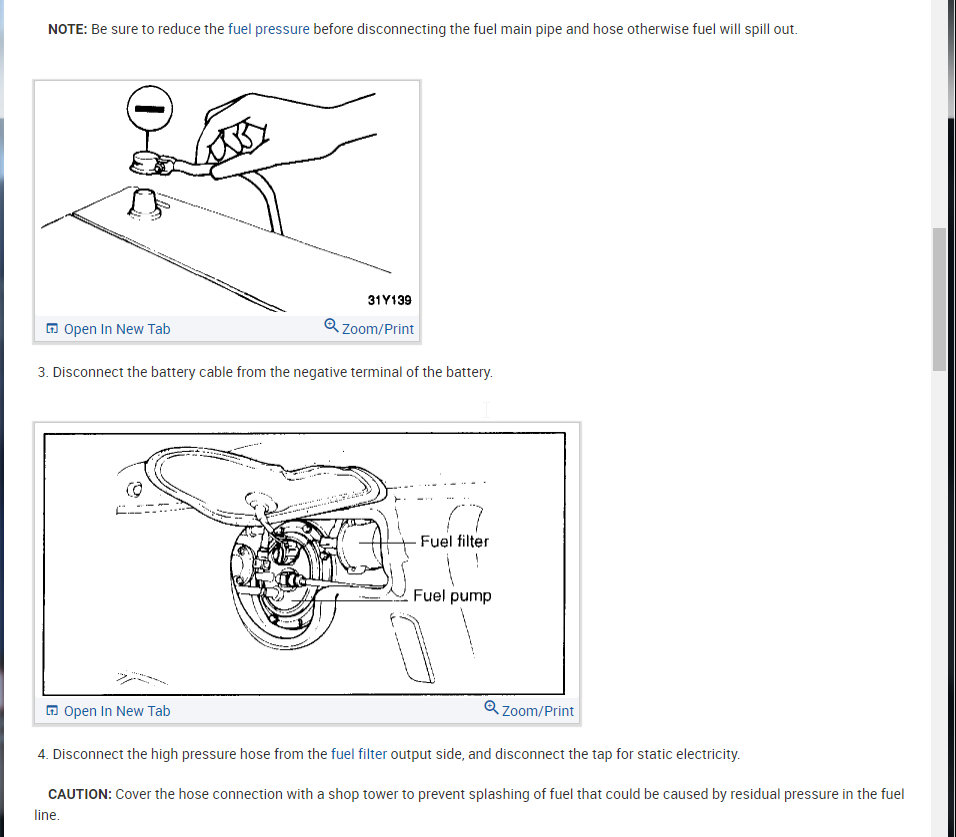

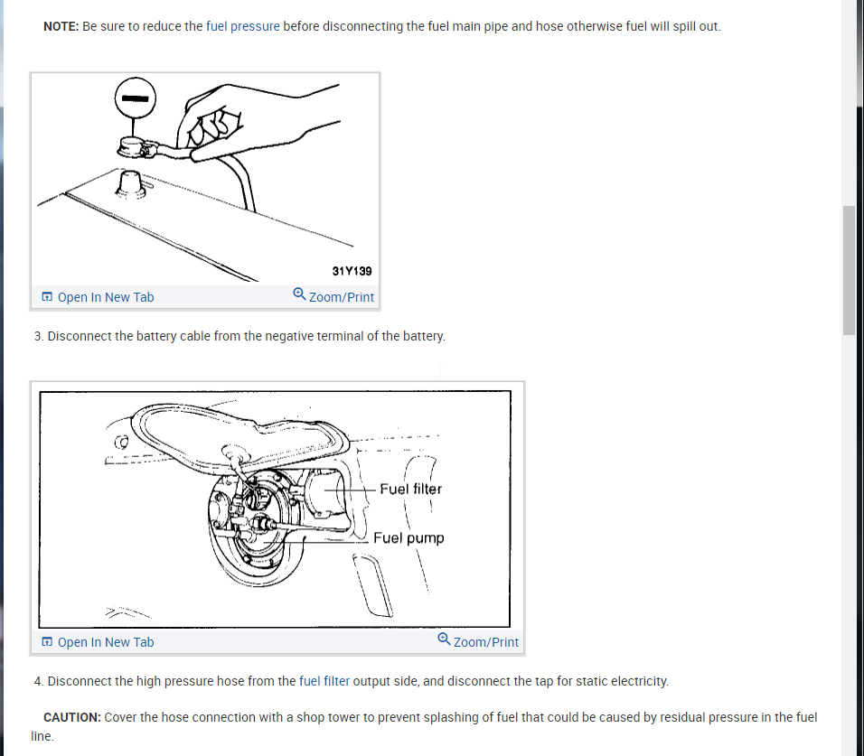

We need to start with checking the fuel pressure. That is a clear sign that the pump is not working. Here is a guide on how to do that. It is located under the rear seat so it is not too bad to do.
Once you confirm this is a pump, I attached the process on how to replace it. Let me know if you have other questions or if the pressure is okay. If it is we need to review this guide and start checking things off the list.
