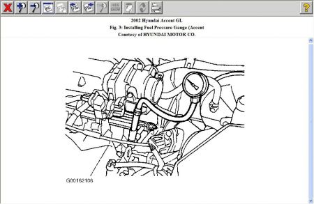

Dear all,
Could you help me with following two questions? I do appreciate your help.
1. I have a fuel pressure gauge, but I can not find the interface to connect to it. Is there anybody know the location to connect the fuel pressure gauge?
Thank you very much.
Sep 28, 2008 at 5:17 AM
  • 75,992 POSTS

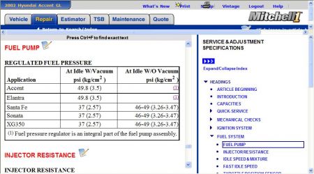

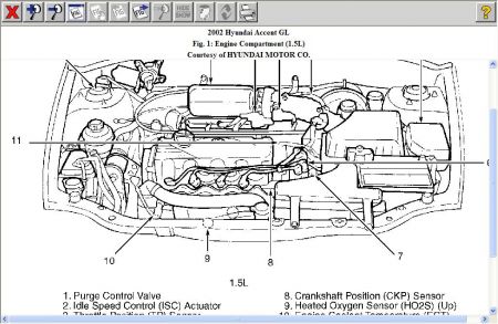

On this car you must use an adapter to read the fuel pressure. Here is a guide that will show you how to use the gauge one the adapter is in place. There are some diagrams (below) that will help as well. https://www.2carpros.com/articles/how-to-check-fuel-system-pressure-and-regulator On Accent and Elantra, the fuel pressure regulator is a located in the fuel pump. On all other models, the fuel pressure regulator is located on the fuel delivery pipe. The fuel pressure regulator maintains a constant pressure at the injectors during all engine operating conditions. The crankshaft angle sensor is number 8 in the diagram below.

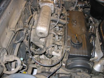

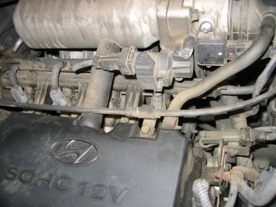

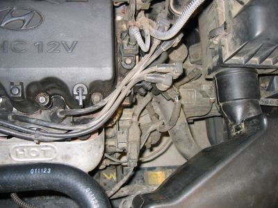

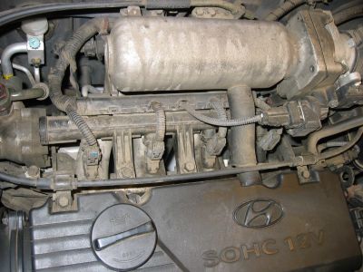

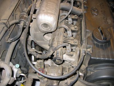

Thanks for the reply and picture, rasmataz. I tried to location those on my car. It seems like that my car is a little bit different from the picture. I took several photos of my car. Could you point out the delivery pipe testing port and cranshaft position sensor on my photos? Thanks a lot. I appreciate your help.

I don't think your car has a test post you will need to use the adapter like the one in the diagram above.
