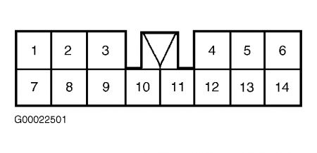

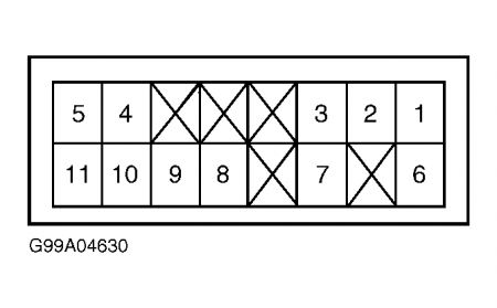

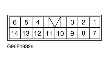

Well Ben My first thought is to please go to Auto Zone (AZ) or O'Reilly's (OR) and for FREE they can pull the codes to the car. Most important: Once they check your codes, if they find something and you don't get it fixed and need to get back with us, please make sure you tell us exactly what the code was, number and all. Example, if the code was E0568 O2 Sensor bad. Then make sure you give us all of that. While there for FREE also they can bring their tester out and check your battery and alternator. Let's see if the trans threw a code. Next - I did attach troubleshooting for the switch. OVERDRIVE SWITCH 1. Disconnect electrical connector for overdrive switch and note switch terminal identification. See Fig. 26 , Fig. 27 or Fig. 28 . Overdrive switch is mounted on driver's side of gearshift lever.
https://images.2carpros.com/forum/automotive_pictures/248015_26_1.jpg
https://images.2carpros.com/forum/automotive_pictures/248015_27_1.jpg
https://images.2carpros.com/forum/automotive_pictures/248015_28_1.jpg
2. Depress overdrive switch to ON position. Using DVOM, ensure continuity exists between terminals No. 1 and 2. Depress overdrive switch to OFF position. Ensure continuity exists between terminals No. 1 and 3. Replace overdrive switch if continuity is not as specified.

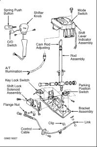

I have hooked the car up to a computer and no error codes have came up. Upon further trying to solve the problem I have noticed that the overdrive sensor turns on and off in Park, Reverse, Neutral, 2 and L. The only one it has problems with is drive. There is a noticable difference in play with the shifter in drive compared to the other. Is there a nut that holds this in place? Thanks for the help I look forward to hearing from you.

Hi Ben I have attached a pic of that area.......as you see there is hardware that can be loose. Also the wiring at the switch can be loose also. It is obvious there is something right there that is causing you the problem.
https://images.2carpros.com/forum/automotive_pictures/248015_Picture1_64.jpg
The switch may need to be replaced if you cannot find anything loose etc. I hope this helps.

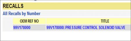

Hello - Also, it looks like you may have a recall on your vehicle. The dealer may fix this for free. Please contact the dealer service department, give them the VIN number of your car and have them check on this to see if it applies to you.
