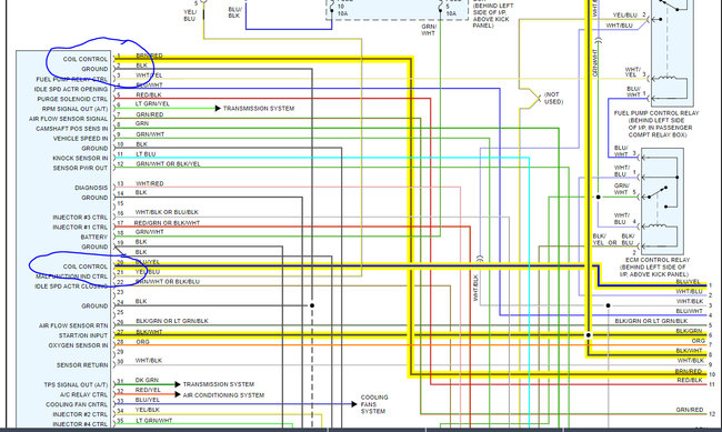

Please Help. There's no 12 volt supply to coil pack for #2 #3, only coil for #1 #4 have 12 volt supply from ECU. Car in running condition but low power because only #1 and #4 spark plug are working. We have replaced new coil pack and camshaft sensor still no 12 volts supply to coil #2 #3. Thank you

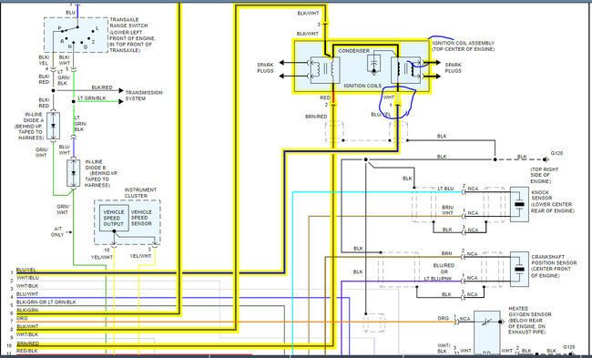

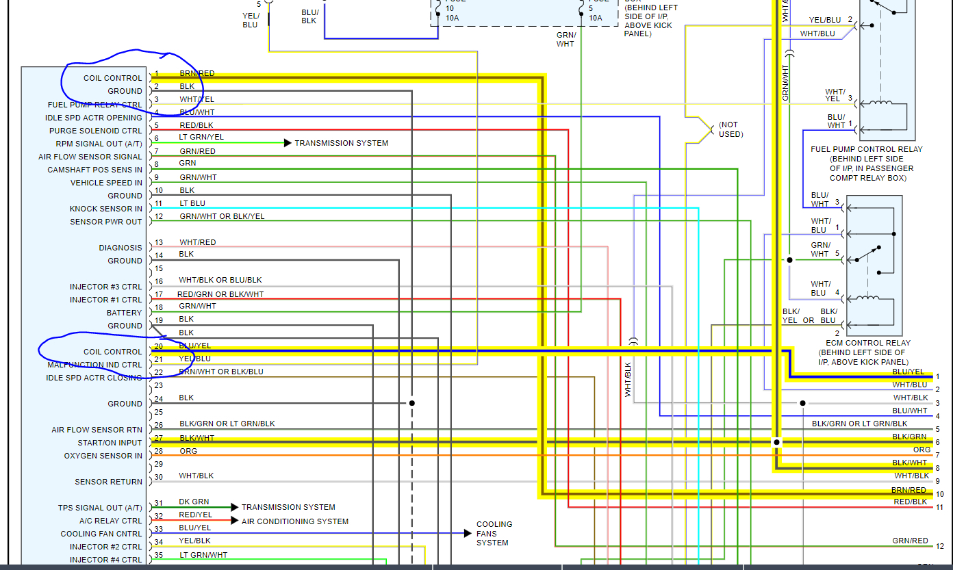

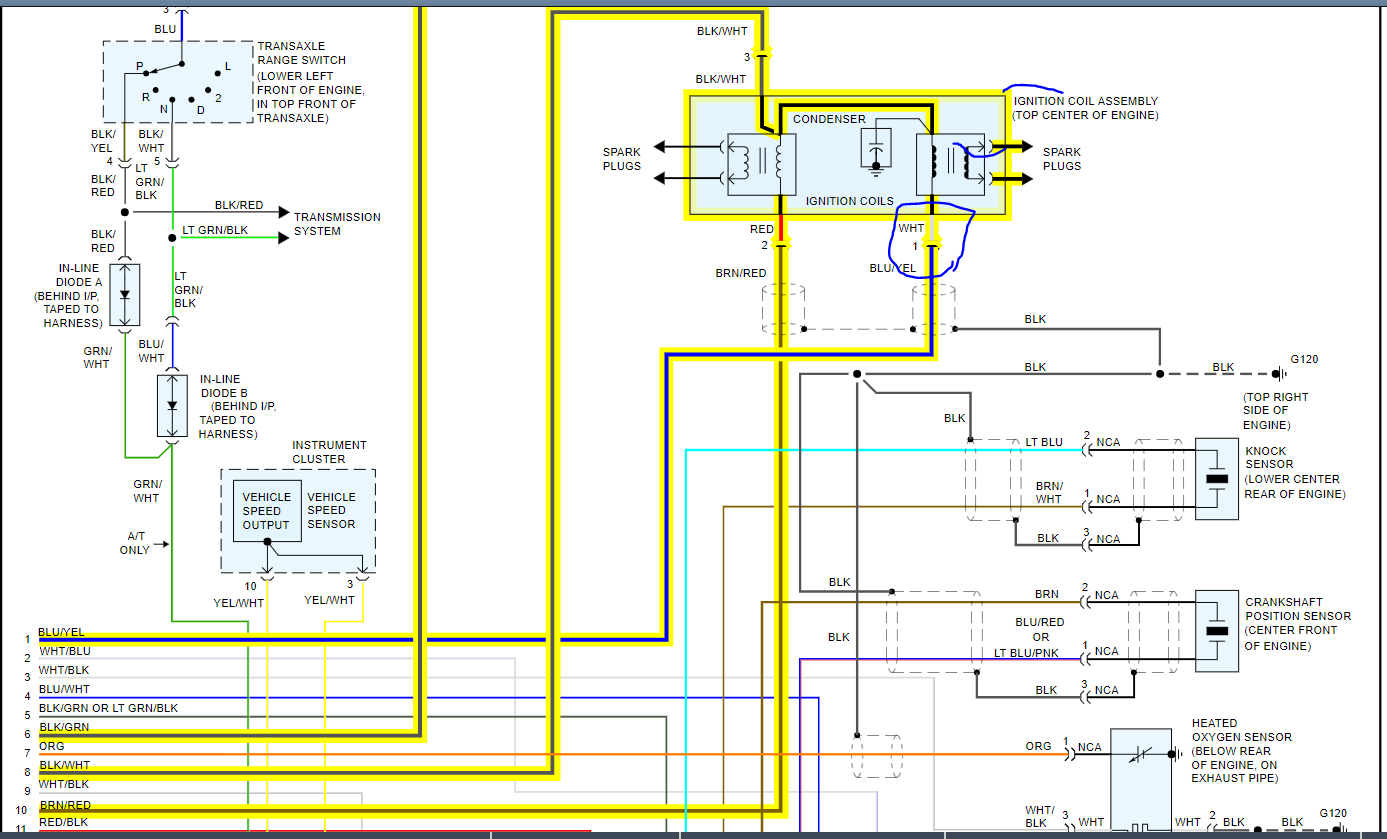

Good afternoon,
This could be either the coil assembly itself or wiring and the ECM.
I attached a wiring diagram for you to view.
The 2 wires at the ECM that I circled are grounds for the coil to fire the spark plugs. You need to test for voltage at those 2 wires with the key on.

Good day Sir Roy. Thank you for you reply. Probably it's not the coil sir because it's new and have it checked and it's good. We've checked the voltage from the ECU and read brown/red (coil#1 #4)= 12 volts, and blue/yellow (coil#2,#3)= only less than 2 volts. We also found out that the original 3 wire crankshaft sensor has no ground itself and still the other two wires produce both 5 volts. does it have something to affect? what shall we do next Sir? thank you in advance.
Nov 21, 2020 at 6:01 PM
Okay, the blue/yellow wire should have 12 volts as well. You have power from the red wire which powers the coil. The 3 wires to the ECM are grounds for the coils, not powers.
Since you have no power to that wire, it means either you have a bad new coil assembly or the wire from the ECM to coil is open.

We have cleaned the contact pins of the coil pack. We now have 12 volt supply From the 3 wire coil pack both blue/yellow and brown/red to ECU and the 12 volt for black/white from ignition to coil pack, but still no power from the coil pack (#2,#3) to spark plug. please advice us what to do next. Thank you so much.
Nov 22, 2020 at 1:43 PM

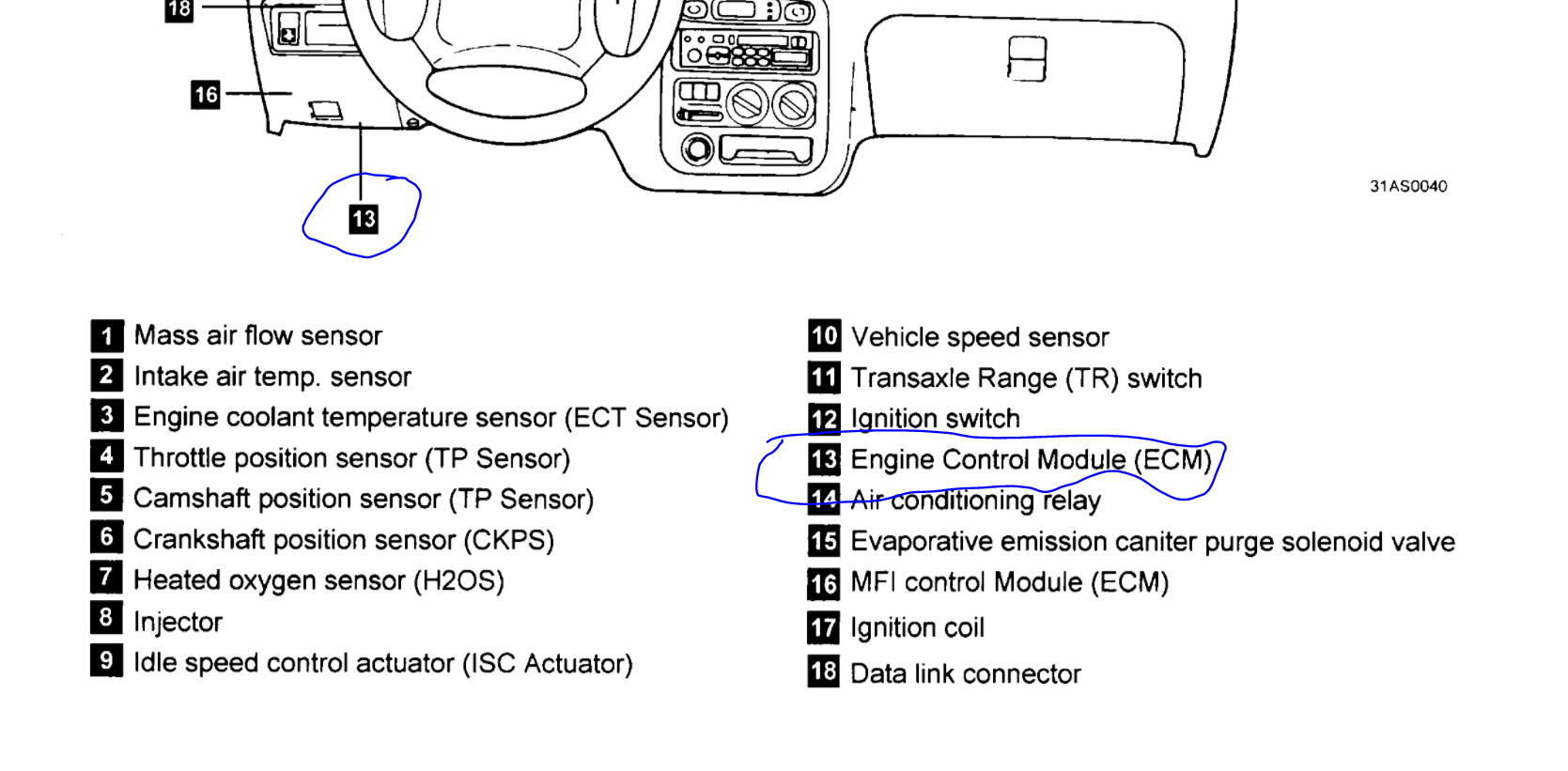

If you have power from the coil to the ECM on both wires for coil 2 and 3, then you need an ECM.
