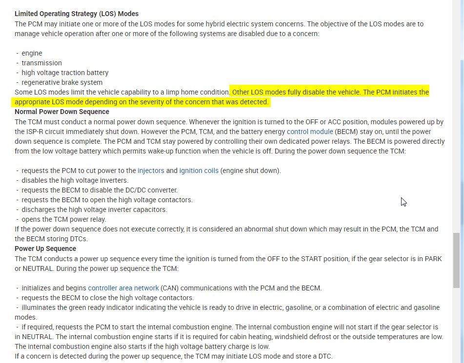

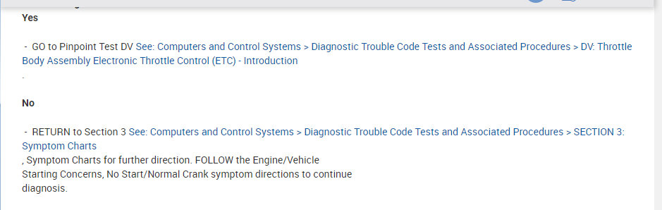

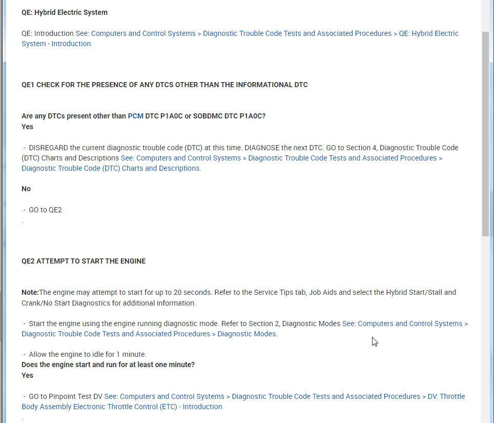

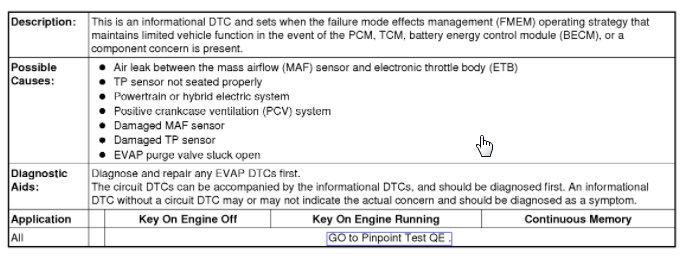

Let's start with this info on this code. Does the engine crank but not start? If so, try cranking it continuously for 30 seconds and see if it starts.
Take a look at this material and let me know. I suspect we are going to have to move onto the other codes as we most likely have something that the PCM is not liking and preventing the start.

No.
When it has sat for 24 hours or longer, no "Stop Safely Now" message is displayed and the engine cranks and starts but can't rev. 10 seconds later it dies, the message appears and the car won't crank again at all no matter what we do.

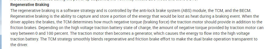

Your screenshots state it is possible that something else triggers the engine to shut off and not start again but I can't make any sense of it being alright when the car got here. Everything is connected as it was back then. We had a vacuum leak from a broken Vapor Canister Purge Valve/Solenoid and a cracked intake manifold. If the no-start was due to vacuum leak, it would have been there then and not now. Now the vacuum is repaired so we should probably exclude it.
I'm thinking, how possible is it that the car won't start because the hybrid batteries are completely discharged right now?
And let me just say that when the "Stop Safely Now" message kicks in the car does not maintain a limited function so one could pull over safely. It just shuts off right away. So it's not in limp mode. I know limp mode could display the same message but this is definitely no limp mode because the engine just shuts off. No time to even change lanes if you're on the road.
May 8, 2021 at 7:06 AM
Okay. Maybe I missed this before. If the hybrid battery is completely drained then that is going to cause the immediate stall like this. The gas engine is meant to suppliant the battery system. It will not operate unless the gas motor has the ability to maintain a minimum level of charge in the hybrid battery.
This vehicle will not just operate on the gas engine if the electric drive side is inoperable. So if the battery is below this level then the gas engine will not be able to recharge or sustain that level so it shuts the vehicle down.

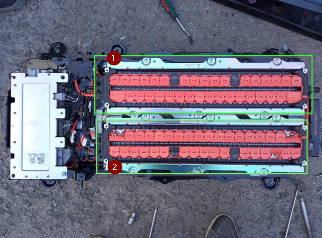

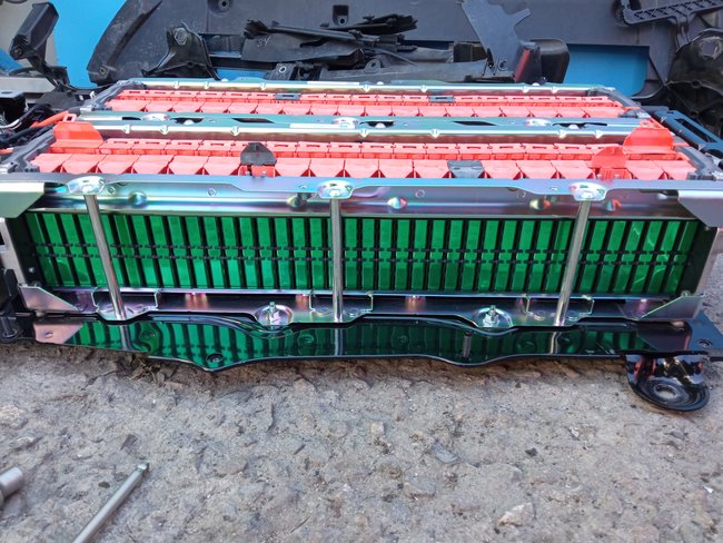

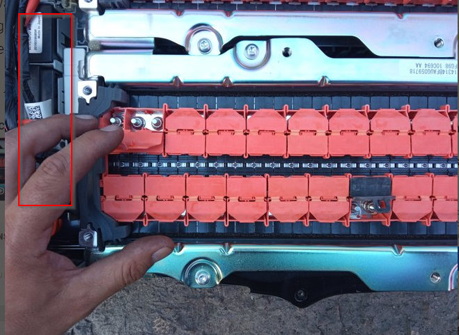

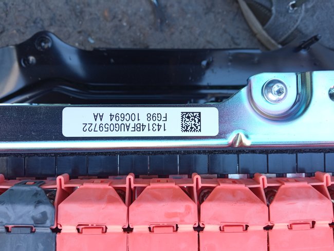

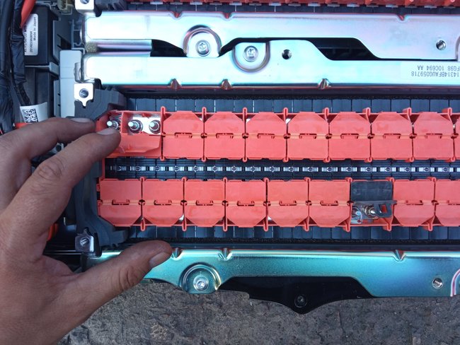

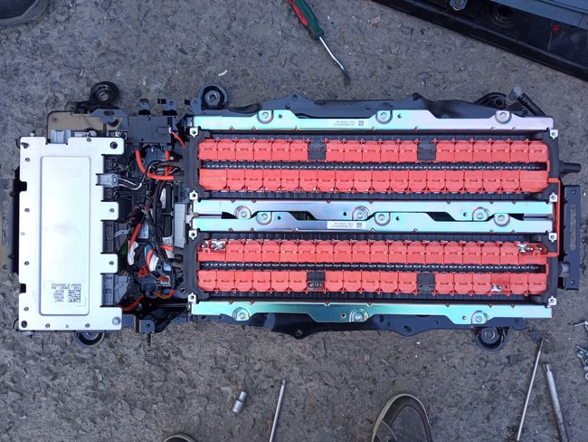

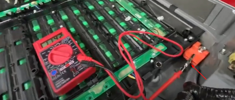

The hybrid battery is out. Please find attached some photos.
Please let me know where I hook up the charger. You can circle the right terminals and shoot the pic right back to me.
I'm working on getting a slow charger. It's the only shot I have here. No service techs around. I can try calling someone in the States but people tend to be somewhat reserved when they see a weird unknown phone number.
P.S.: What are the black-capped cells as opposed to the red-capped?
May 20, 2021 at 2:14 PM
I can't stress this enough. Please be careful. If your batteries are drained at this point then you may be safe but once you charge them you are going to have enough voltage to seriously hurt you or worse.
I have not been this far into a battery pack but I know that you have two sets of batteries here.
I circled them below. You are going to have to charge them separately most likely, depending on what type of charger you get. A popular one is called Prolong but it only charges up to 250 volts and it appears each one of these batteries are 150 volts.
Also, all those individual caps are to connect all the individual plates. You need to find the positive and negative for all the plates and connect the charger to these.
As for where to connect, you are going to have to find the positive and negative terminals for the entire batteries and you can find this by testing for voltage and when you find that you have around 150 volts per battery pack then you can use these points to connect the charger.
I attached some pictures of a battery off an Escape which is going to be similar to yours.
If you are not using hybrid battery insulated gloves then I would invest in a pair and remove any jewelry when working on it.

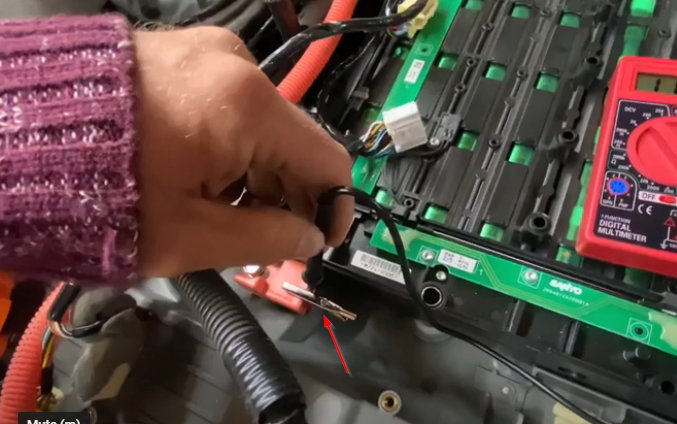

So when I check a dead battery for voltage, should there be any? To find the correct terminals to connect the charger, that is. The way I see it, right now I detect no voltage so I'm guessing the outer terminals of the cells with the triple caps would be the right ones to work with, please see photo.
No need to mention rubber gloves, of course.
Jun 1, 2021 at 4:04 AM
If you have no voltage then I suspect you have a circuit issue with the battery. I have never seen one of these batteries have 0 volts so I would think you are not checking it on the stud that has all the cells connected to it.
Usually these posts/studs are to the left of this location. I circled the general location.
