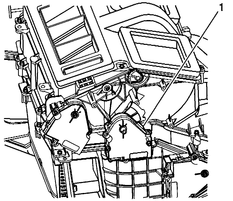

The back vents are still working fine. I can hear the blower running and feel a little bit of air at the front vents but not working properly I have located the actuators under the dash on drive side and I think that is the problem but not sure which one is the problem. the lower actuator has movement and the top didn't when I went through the modes. then they did. Not sure if was a full range of motion. Thank you in advance for any you could give.

When air flow directions is not working, chances are it is the mode door actuator. That actuator is responsible for where the air comes out from the vehicle.
Here are the directions for replacing that actuator. I am giving the directions for replacement, but the pictures should help you locate the actuator and confirm it isn't working. The pictures attached correlate with the directions.
__________________
2004 Chevy Truck TrailBlazer 2WD L6-4.2L VIN S
Mode Actuator Replacement
Removal Procedure
1. Remove the left side sound insulator screws.
2. Remove the left hand floor duct. Refer to Floor Air Outlet Duct Replacement - Left Side See: Air Duct > Procedures.
pic 1
3. Disconnect the electrical connector from the mode actuator.
4. Remove the screws from the mode actuator (1).
5. Remove the mode actuator.

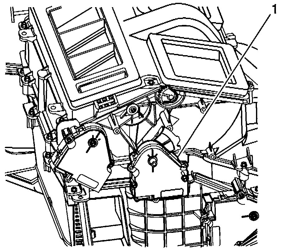

Installation Procedure
pic 2
Important: The new actuator is in Bi-Level mode. Place the door in the middle of the travel position before you install the actuator.
1. Install the mode actuator (1).
Notice:
2. Install the screws to the mode actuator (1).
Tighten
Tighten the screws to 1.9 Nm (18 lb in).
3. Install the left hand floor duct. Refer to Floor Air Outlet Duct Replacement - Left Side See: Air Duct > Procedures.
4. Install the left side sound insulator screws.
5. Recalibrate the mode actuator. Refer to Actuator Recalibration See: Heating and Air Conditioning > Programming and Relearning.

Thank you for your quick response and your time. I later found that it was not the actuators at all. in fact was the blower resistor. I was not aware this vehicle had two blowers and what was hearing was the back blower. But once again I apologize and thank you for your help and quick response. I would recommend you guys to anyone in need help with repairs thank you. God bless you.
