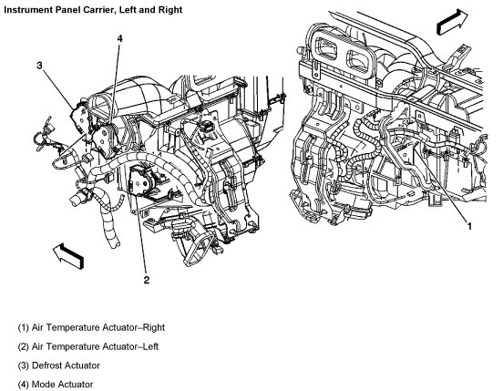

When I turn the A/C on the driver side vents are putting out warm air. The passenger side vents are putting out cold air. Both controls are all the way down to max cool, blower is operating at 5, help.

You have two different problems here. For the blower speed replace the blower resister and connector, that will fix the blower speed problem. the other problem is a mode door actuator problem, on these vehicles they have a left and right side actuators. I would start by checking the left side.
May 24, 2010 at 9:47 AM
  • 110,244 POSTS
Hi and thanks for using 2CarPros.com. Brian 1 is exactly right. There are two different systems, automatic climate control and manual. I am going to start with automatic.
Here are the directions specific to your vehicle for replacing the right blend air door actuator:
AIR TEMPERATURE ACTUATOR REPLACEMENT - RIGHT

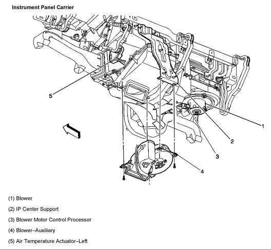

The first two pictures show the location of the component.

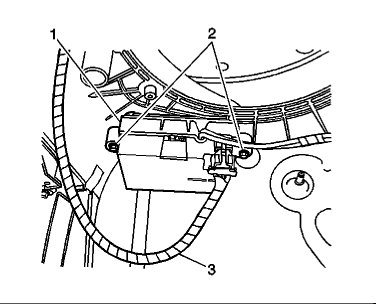

Here are the directions for the manual climate control system which are specific to your vehicle.

The 3rd pic is that of the manual system.

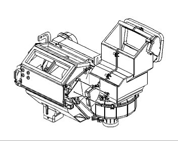

As for the blower motor resister, here are the directions for removal and replacement specific to your vehicle. Picture 4 shows the resister location.
BLOWER MOTOR RESISTOR ASSEMBLY REPLACEMENT

All aforementioned components are located under the dash of the vehicle on the passenger side. It will require removal of dust cover which is above where your feet set. Additionally, removal of the glove box will help. Finally, I recommend disconnecting the battery and waiting for at least fifteen minutes prior to starting. There is an air bag on the passenger side and I do not want anything to happen.
