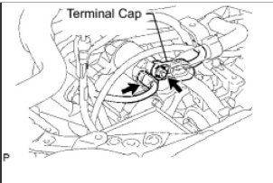

It sounds like you have either a starter that is out or the security system has kicked in.
Lets test for power at the starter trigger wire to see if it is getting power also is the security light flashing?
Here is a guide to show you how to test the starter look toward the bottom.

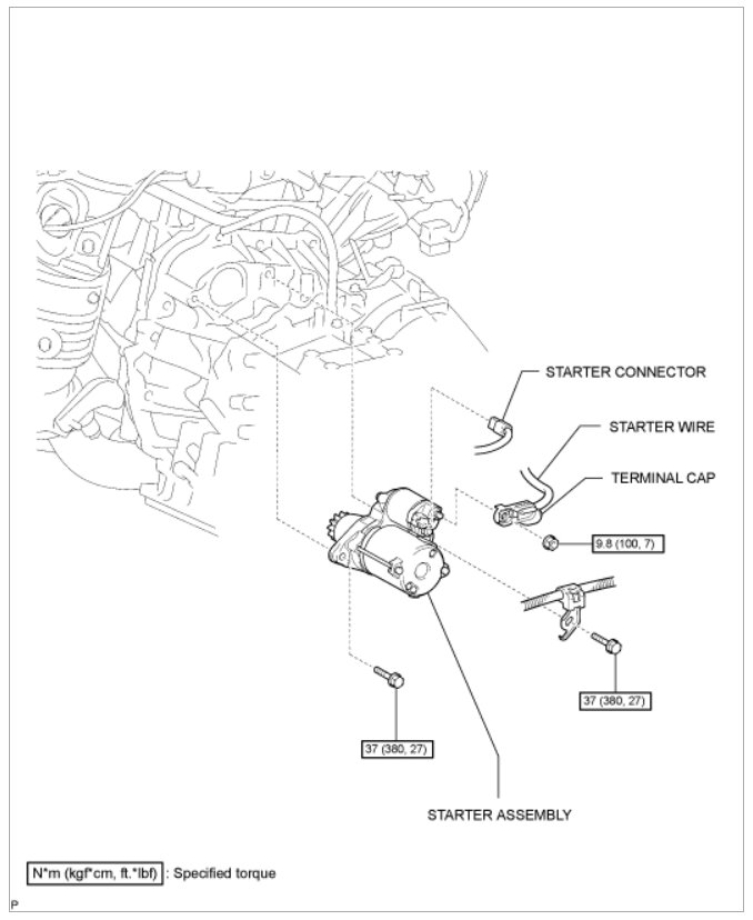

So i got a new battery and still nothing just a little noise comming from the starter so i will go through the starter test and see if thats what i need

Yep it sure sounds like you need a starter. Here is a guide to help you see what you are in for when doing the job.
Here is what it will be like for your car (below)
