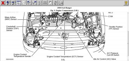

Hi lsc14006, Welcome to 2carpros and TY for the donation Clean out the idle air control valve and also clean the MAF sensor with an electronic cleaner and see what happens

I cleaned up the Mass Airflow Sensor and replaced the IACV and it fixed the problem for a little while. Then it came back "very rough idling." If I tap on the IACV it idles smoothly, Is it possible that I bought a bad IACV?
Aug 20, 2020 at 4:10 AM (Merged)
  • 75,988 POSTS
Could be try recleaning the passages and the valve again and see what happens-don't work replace it

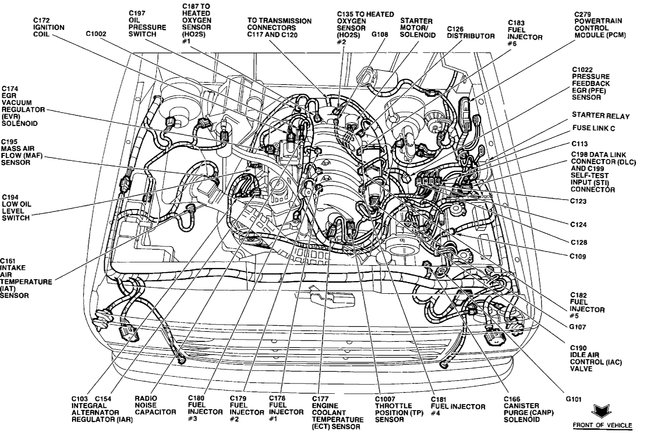

BLADEBOY2025
I have a 91 Ford ranger that will start and die. If I bounce the gas I can keep it running. The truck will run with the MAF disconnected, but I've replaced this and it still has the same issue. Any ideas?
Aug 20, 2020 at 4:12 AM (Merged)
  • 75,988 POSTS
Check and test the Idle air bypass valve, PCV and EGR valves, BMAP sensor /throttle position sensor
WINDY ENGLOF
the high idle stops when the truck warms up but than it drops really low and idle searches even well underload,could it be the EGR and is there one on my truck,i didnt find one.
BLADEBOY2025
[quote:dc9e1a04ae="rasmataz"]Check and test the Idle air bypass valve, PCV and EGR valves, BMAP sensor /throttle position sensor[/quote:dc9e1a04ae]
Those were my next guesses, I really need a chilton. Maybe I could just carb it, HA! EGR is under the manifold, so I think I will check for that last. Any place online I can get resistance and voltage specs for a 91 ranger?
