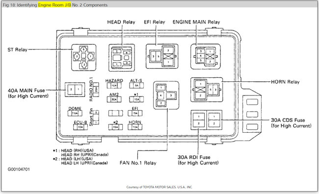

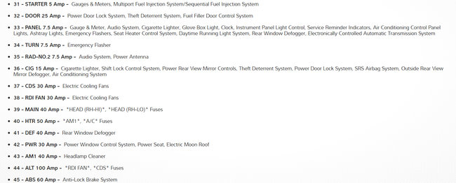

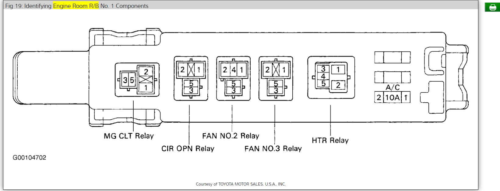

I have toyota 98 camry and I have somehow blown the ALT (100A) fuse. I bought the new fuse but I am unable to replace the blown one. The fuse seems to be hooked to something below. I searched on the web and found that I need to open the box and then I can replace the fuse. I tried hard to lose the box somehow but all in vain. I found some youtube videos for 96 and 2000 camry but their fuse box is different. Can someone help me with specifically the 98 camry.
Its been 10 days , the car is on its own :(
Thanks
Mar 15, 2014 at 11:55 AM
KHLOW2008
  • 41,814 POSTS

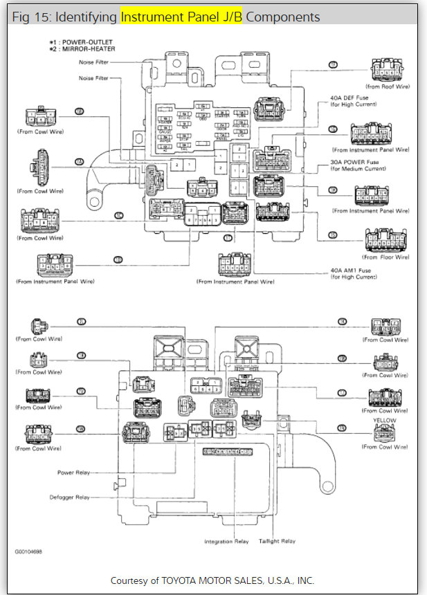

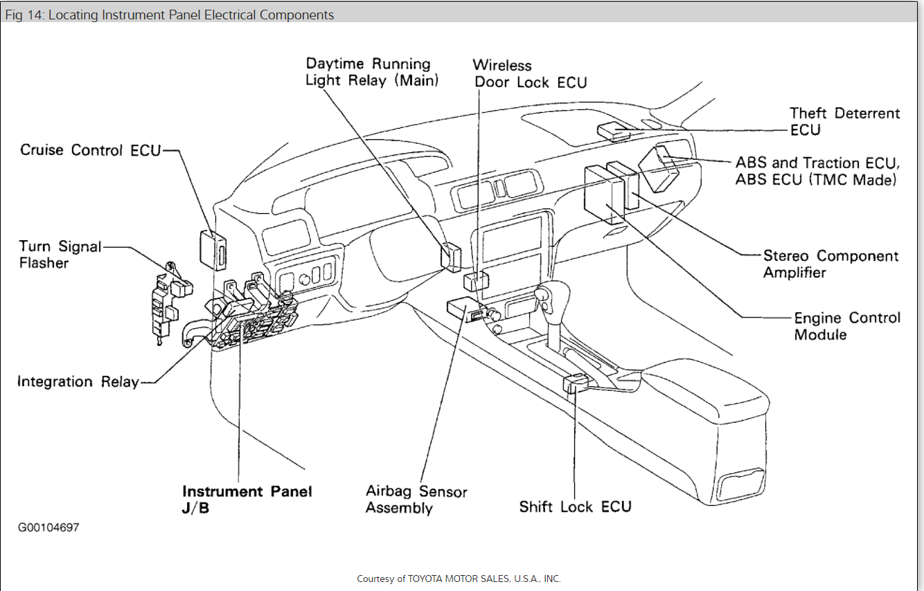

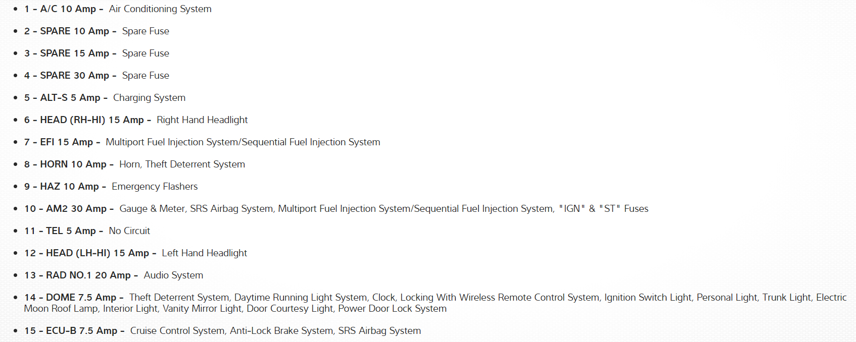

At the side of the fuse you need to pry open the covers to get at the holding screw. It is a 10 and/or 8 mm hex head. Here is the location in the diagrams below
This guide will help you test it
