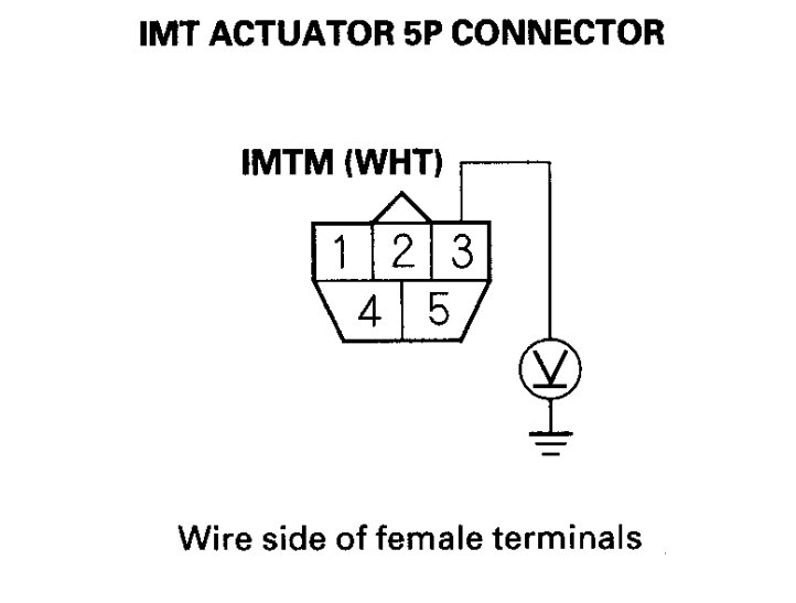

Code P1077, reset it and run car for fifty miles turn off then turn on and check engine lights on with same code p1077.
Dec 2, 2018 at 11:35 AM
Good morning,
I attached possible causes for the code below.
Clearing a code does absolutely nothing. The issue is still there and must be addressed.

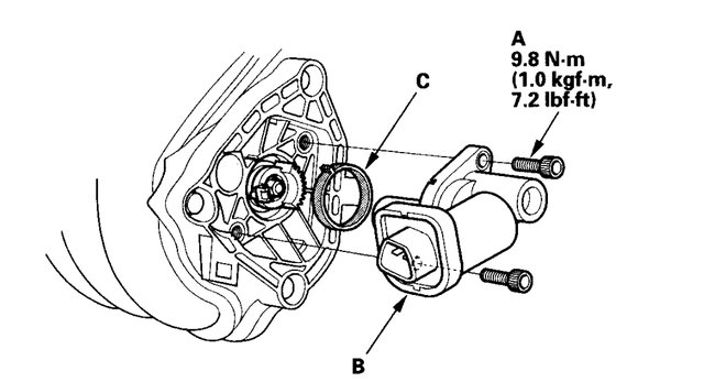

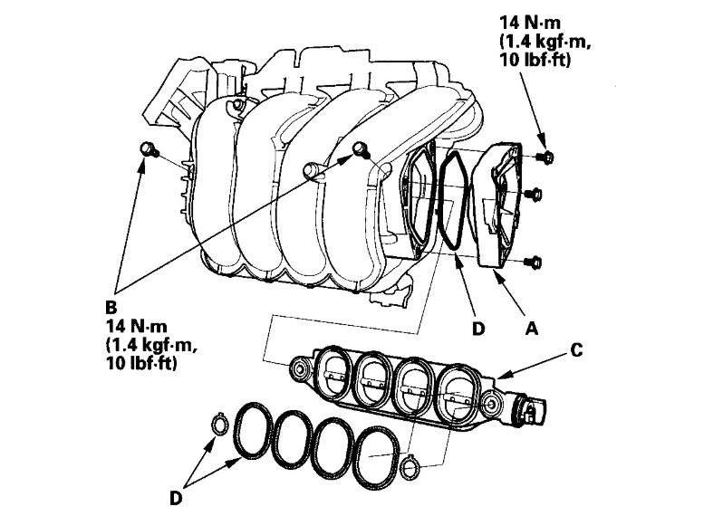

The IMT valve is inside the intake manifold. I attached a picture for you.
P1077
Descriptor
Probable Causes
Engine Control Module (ECM)/Powertrain Control Module (PCM)
Engine Control Module (ECM)/Powertrain Control Module (PCM) Update Needed
Intake Manifold Tuning (IMT) Actuator
Intake Manifold Tuning (IMT) Valve
Poor Connections or Loose Terminals At Intake Manifold Tuning (IMT) Actuator and Engine Control Module (ECM)/Powertrain Control Module (PCM)

This is the flow chart for the code
DTC P1077: IMT Valve Stuck in High RPM Position
NOTE: Before you troubleshoot, record all freeze data and any on-board snapshot, and review the general troubleshooting information.
1. Turn the ignition switch ON (II).
2. Clear the DTC with the HDS.
3. Do the IMT TEST in the INSPECTION MENU with the HDS.
Is the result OK?
YES - Intermittent failure, the system is OK at this time. Check for poor connections or loose terminals at the IMT actuator and the ECM/PCM.
NO - Go to step 4.

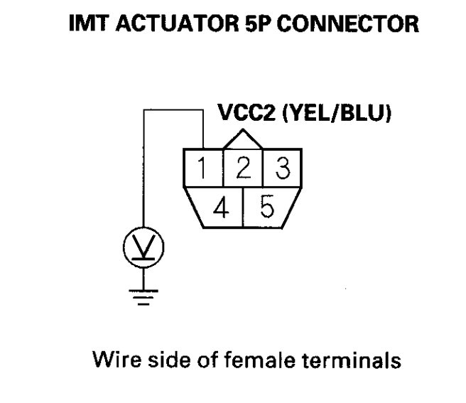

7. Measure voltage between IMT actuator 5P connector terminal No.1 and body ground.
Is there about 5 V?
YES - Go to step 12.
NO - Go to step 8.

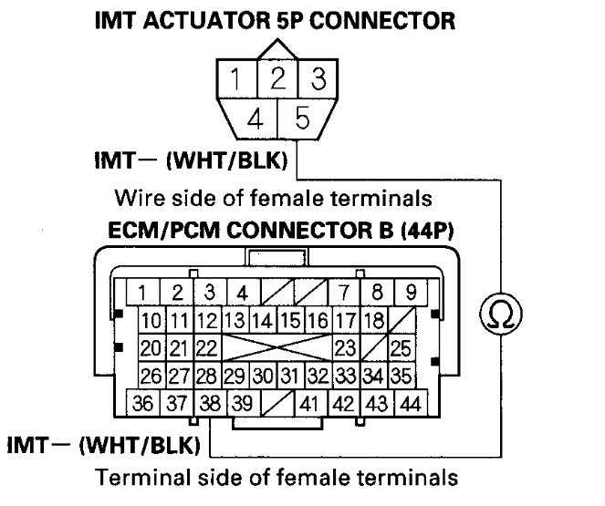

8. Turn the ignition switch OFF.

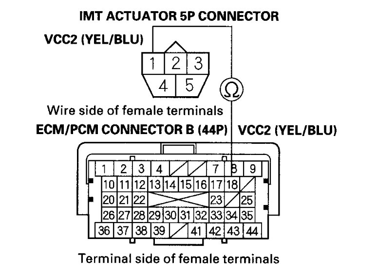

9. Jump the SCS line with the HDS.
10. Disconnect ECM/PCM connector B (44P).
11. Check for continuity between IMT actuator 5P connector terminal No.1 and ECM/PCM connector terminal B18.
Is there continuity?
YES - Go to step 36.
NO - Repair open in the wire between the ECM/PCM (B18) and the IMT actuator, then go to step 30.
12. Measure voltage between IMT actuator 5P connector terminal No.3 and body ground.
Is there about 5 V?
YES - Go to step 17.
NO - Go to step 13.

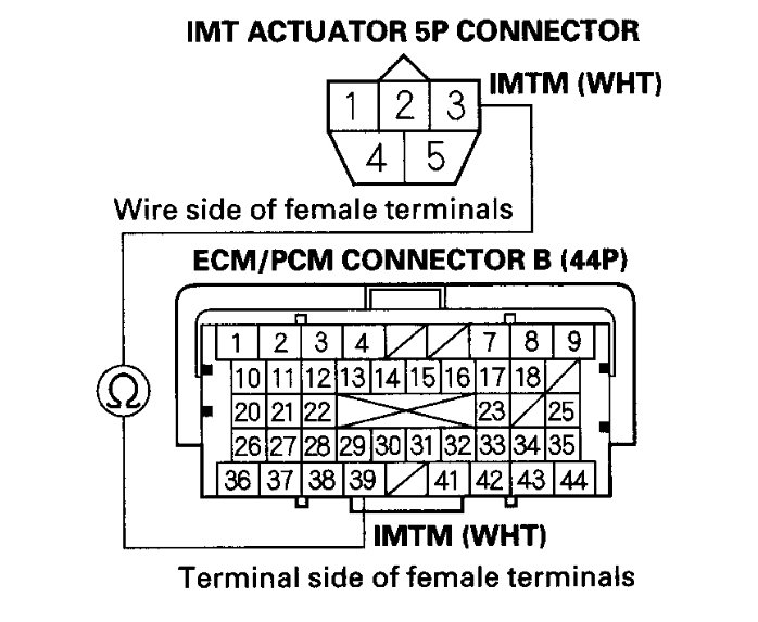

13. Turn the ignition switch OFF.
14. Jump the SCS line with the HDS.
15. Disconnect ECM/PCM connector B (44P).
16. Check for continuity between IMT actuator 5P connector terminal No.3 and ECM/PCM connector terminal B39.
NO - Repair open in the wire between the ECM/PCM (B39) and the IMT actuator, then go to step 30.

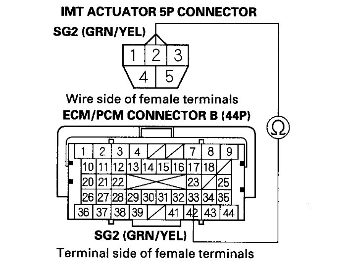

17. Turn the ignition switch OFF.
18. Jump the SCS line with the HDS.
19. Disconnect ECM/PCM connector B (44P).
20. Check for continuity between IMT actuator 5P connector terminal NO.2 and ECM/PCM connector terminal B33.
YES - Go to step 21.
NO - Repair open in the wire between the ECM/PCM (B33) and the IMT actuator, then go to step 30.

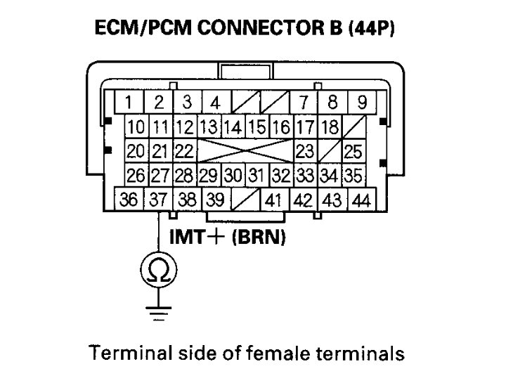

21. Check for continuity between ECM/PCM connector terminal B37 and body ground.
YES - Repair short in the wire between the ECM/PCM (B37) and the IMT actuator, then go to step 30.
NO - Go to step 22.

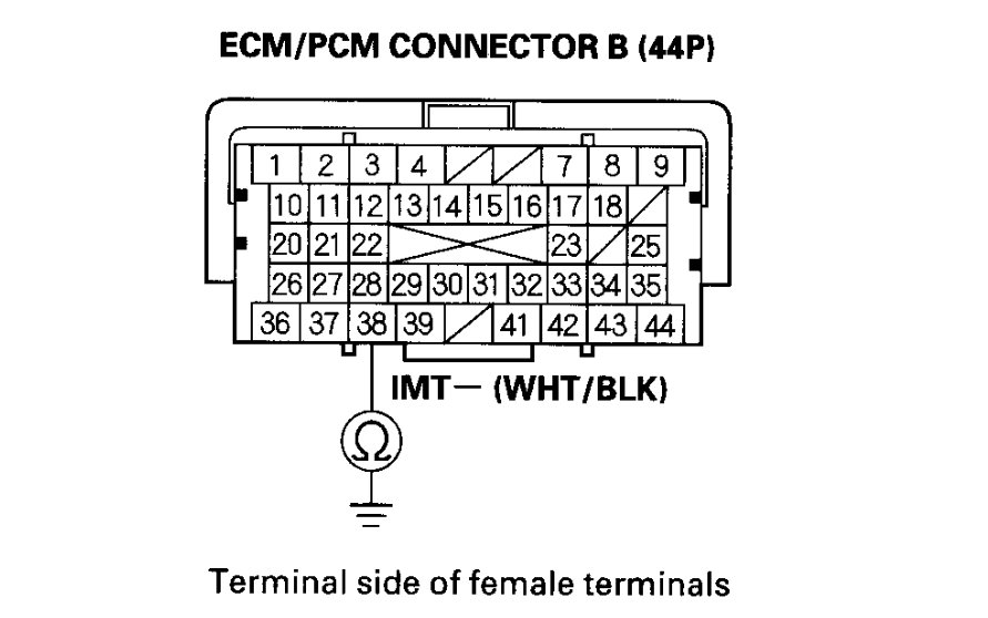

22. Check for continuity between ECM/PCM connector terminal B38 and body ground.
YES - Repair short in the wire between the ECM/PCM (B38) and the IMT actuator, then go to step 30.
NO - Go to step 23.

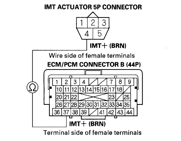

23. Check for continuity between IMT actuator 5P connector terminal No.4 and ECM/PCM connector terminal B37.
YES - Go to step 24.
NO - Repair open in the wire between the ECM/PCM (B37) and the IMT actuator, then go to step 30.

25. Remove the IMT actuator.
26. Move the IMT valve by hand.
Does it move smoothly?
YES - Go to step 27.
NO - Replace the IMT valve, then go to step 30.
