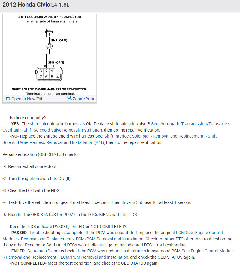

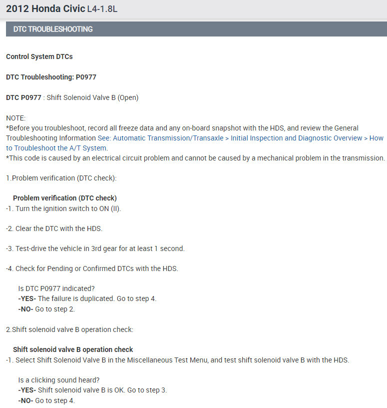

The "D" indicator light keeps flashing so I had it scanned and received two different codes from two different places (auto parts store and a mechanic). P0977 came from the auto parts store after the mechanic scanned and got a different code at first and then received that code with a different scanner. My question is, where is problem and is there a diagram or video I can follow to fix it?
Car listed above is a DX model.
Oct 1, 2021 at 3:25 AM
SQM
  • 6,383 POSTS

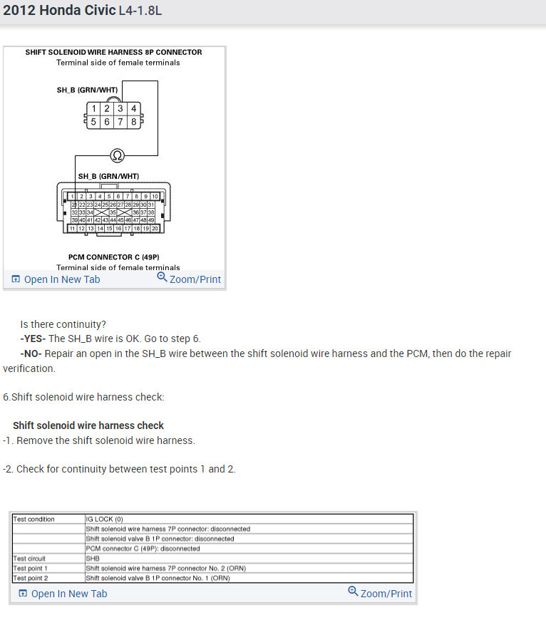

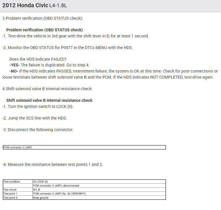

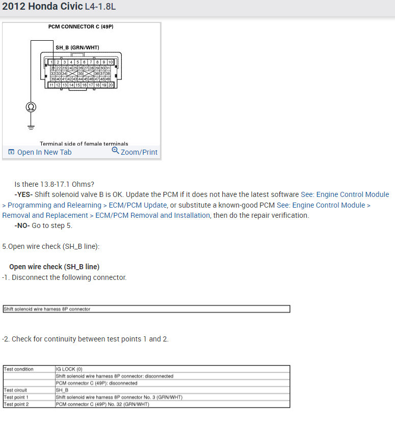

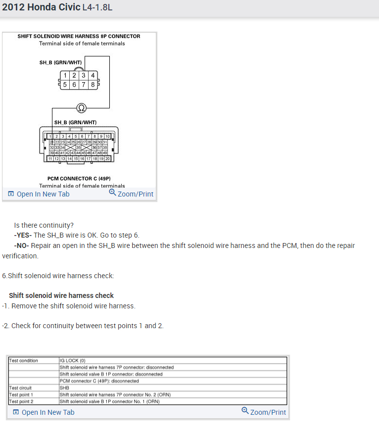

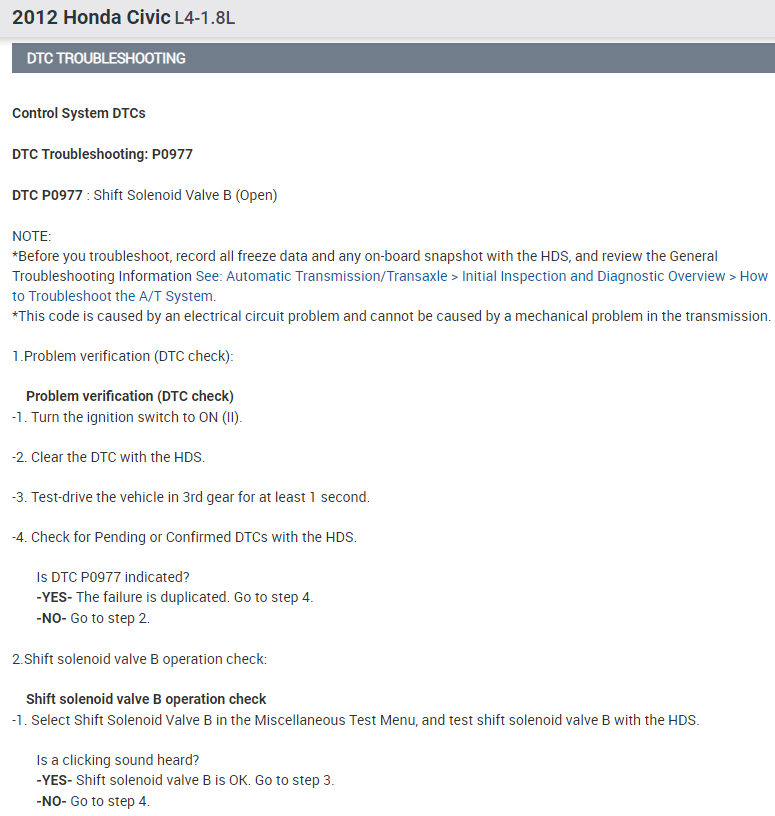

The code - P0977: Shift Solenoid Valve B (Open)
This can be triggered due to a faulty shift solenoid in the transmission. It can also be an issue with not getting proper signal from the PCM.
I have attached the troubleshooting steps for the code P0977 below. Try following those steps to figure out the issue.
Oct 1, 2021 at 4:21 AM

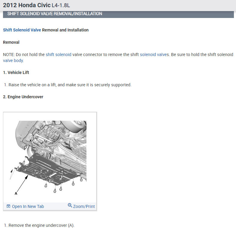

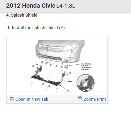

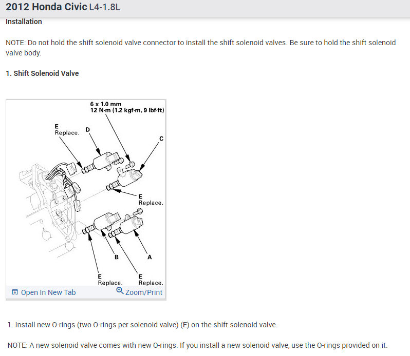

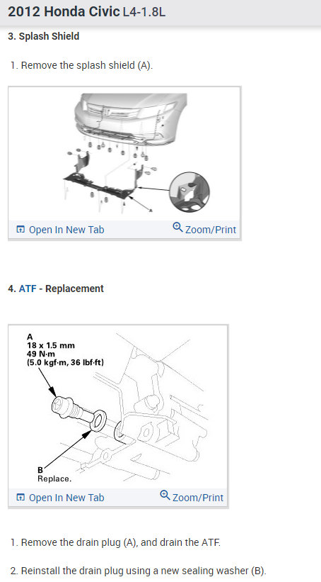

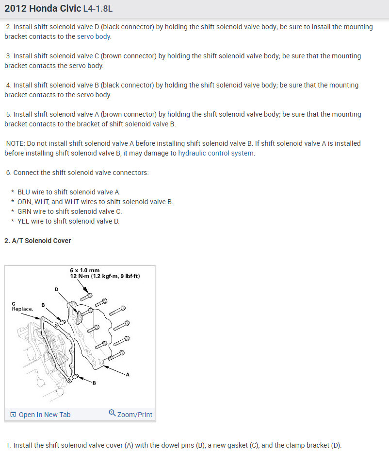

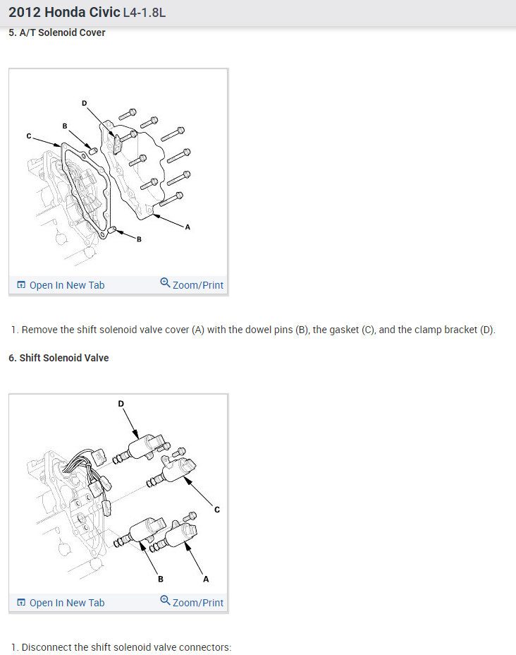

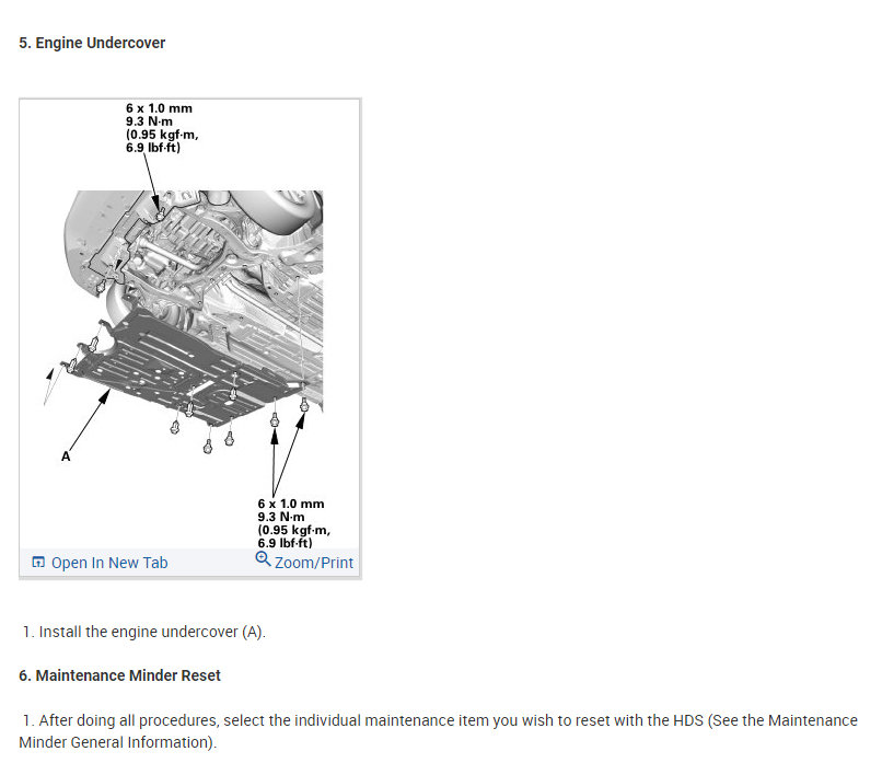

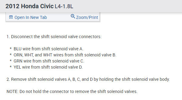

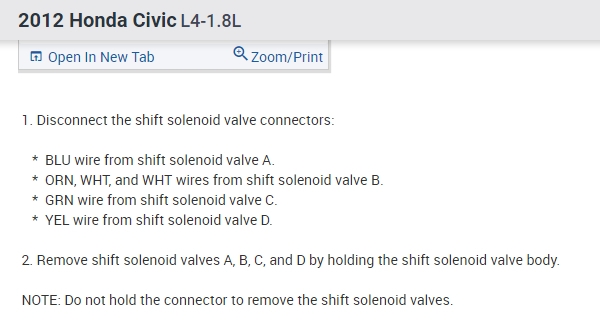

Regarding the last slide, is there a way you can send me the link on changing the solenoid?
Oct 1, 2021 at 5:03 AM
SQM
  • 6,383 POSTS
I have attached the shift solenoid replacement procedure below.
Let me know of any questions.
Oct 1, 2021 at 5:36 AM
CHICKENRACER2020
  • 11 POSTS
Awesome thank you. I am having trouble with solenoid B. This has helped a lot. Thank you
