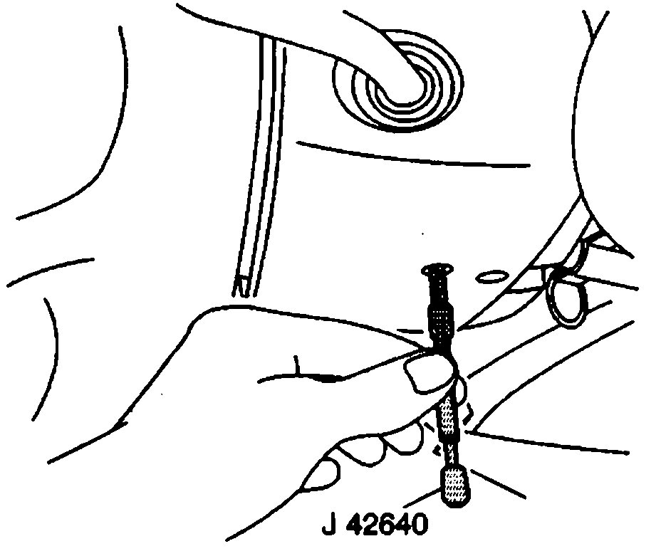

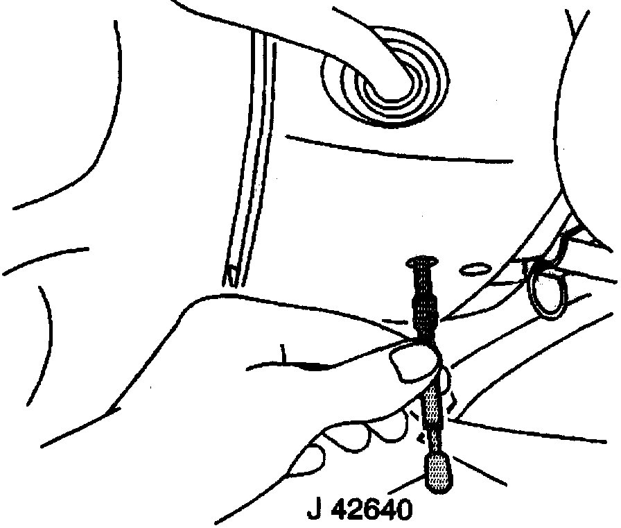

1. Lock the steering column by installing J42640 into the underside of the steering column.

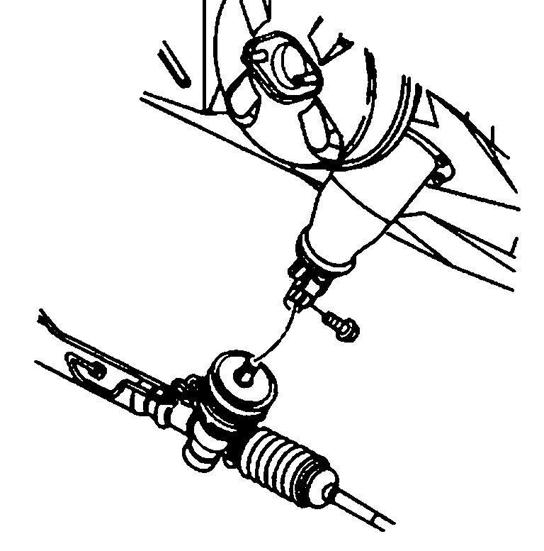

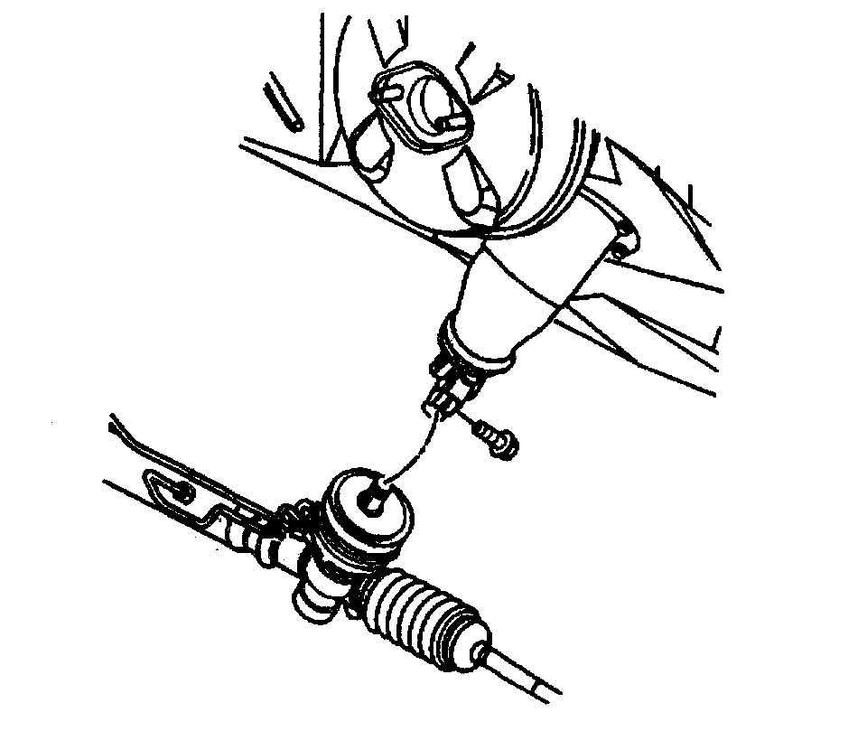

5. Remove the intermediate shaft lower pinch bolt coupling.
6. Disconnect the intermediate shaft from the power steering gear.

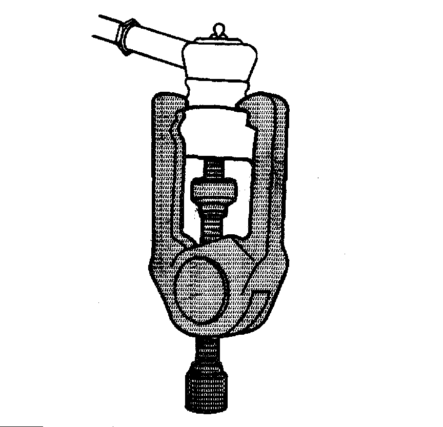

7. Remove the outer tie rods retaining nuts.
8. Using the J24319-B separate the outer tie rods from the steering knuckles.

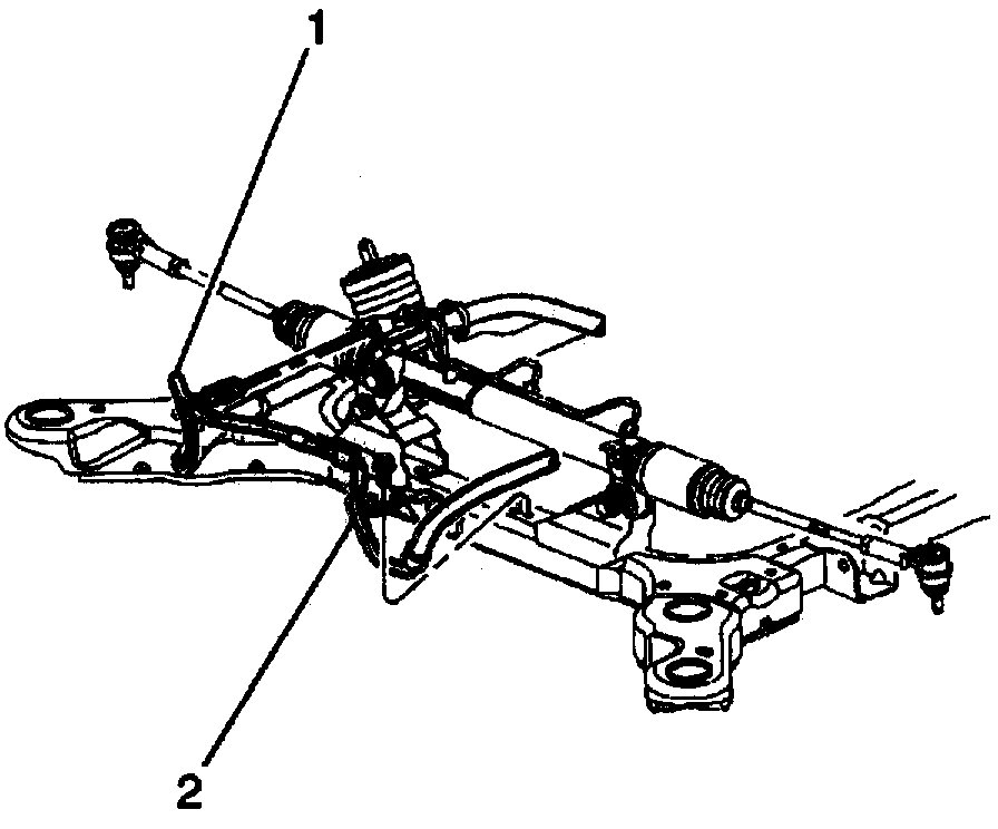

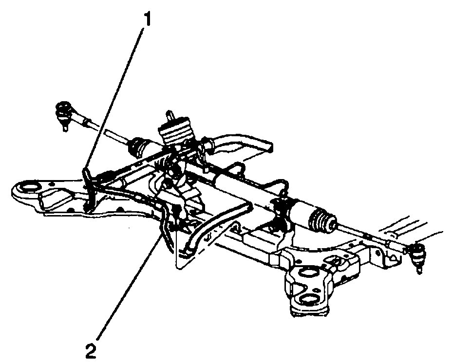

9. Remove the power steering pressure and return hoses (1 & 2) from the power steering gear.
10. If equipped, disconnect the variable effort steering electrical connector.
11. Remove the left stabilizer shaft insulator.

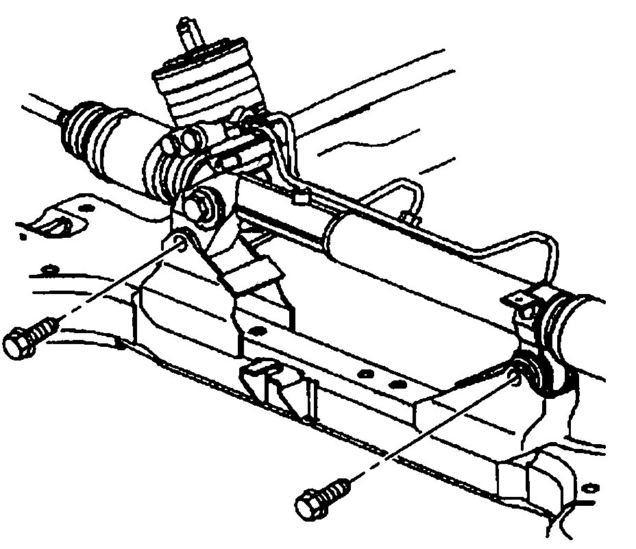

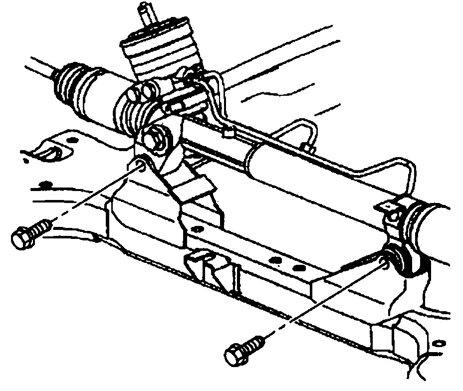

13. Remove the power steering-gear mounter bolts.
14. Remove the power steering gear through the left wheel opening.
15. Transfer the outer tie rods if replacing the power steering gear.

2. Install the power steering gear mounting bolts.
Tighten the power steering gear mounting bolts to 95 Nm (70 ft. Lbs.).

4. Install the power steering pressure and return hoses (1 & 2) to the power steering gear.
Tighten the power steering pressure and return hoses to 30 Nm (22 ft. Lbs.).
5. If equipped, connect the variable effort steering electrical connector.

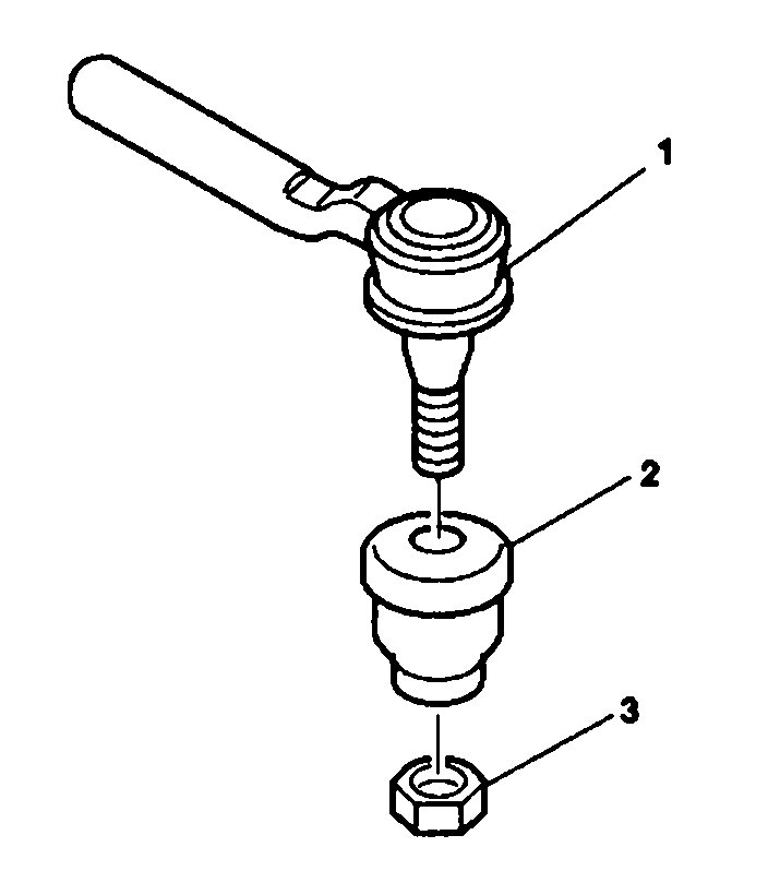

6. Install the outer tie rod (1) to the steering knuckles.
7. Install the outer tie Rod retaining nuts.
Tighten the outer tie rod retaining nuts to 70 Nm (52 ft. Lbs.).
8. Connect the intermediate shaft to the power steering gear.

12. Remove the J42640 from the steering column.
