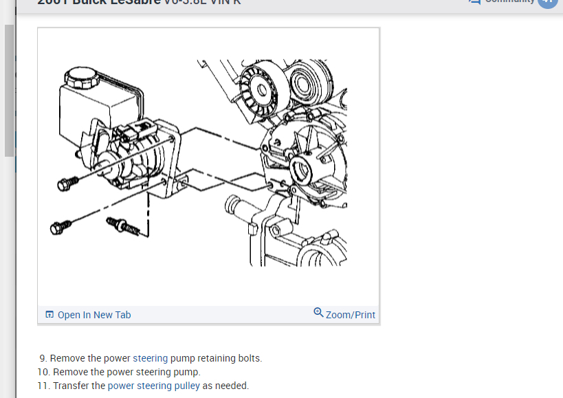

More than likely this is a pump that is failing or has air in it. A lot of times when a pump is pushing air instead of fluid it will cavitate which feels like it is vibrating or shaking.
https://www.2carpros.com/articles/power-steering-problems
I would start with changing the fluid using this guide to help:
https://www.2carpros.com/articles/power-steering-fluid-flush
If that does not work then you are going to have to change the pump.
Here are a couple guides that will help with replacing the pump:
https://www.2carpros.com/articles/how-to-replace-a-power-steering-pump

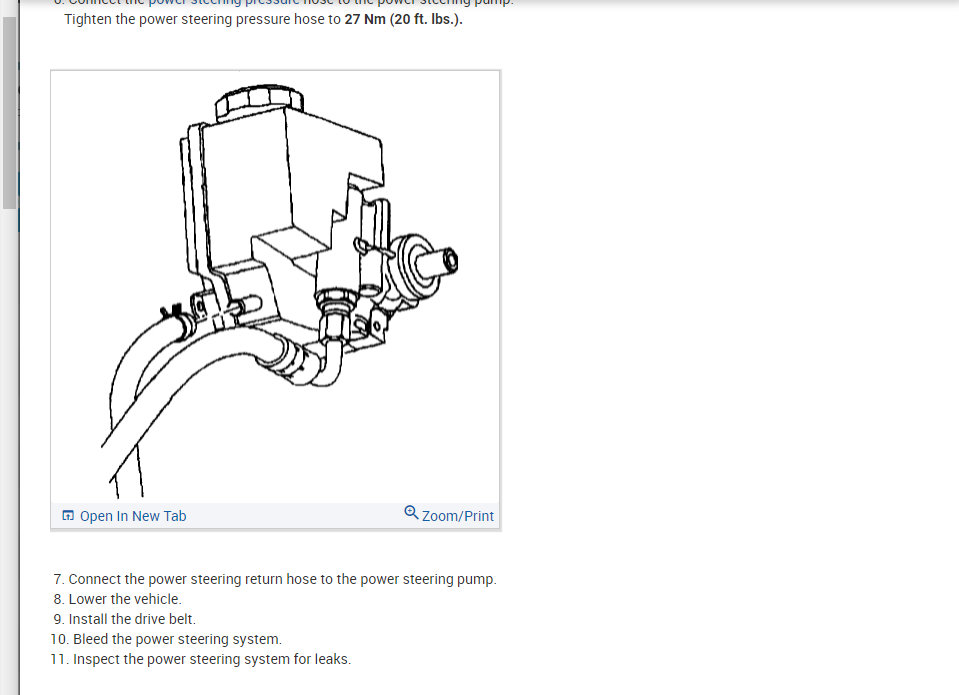

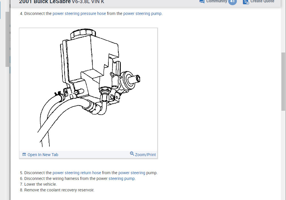

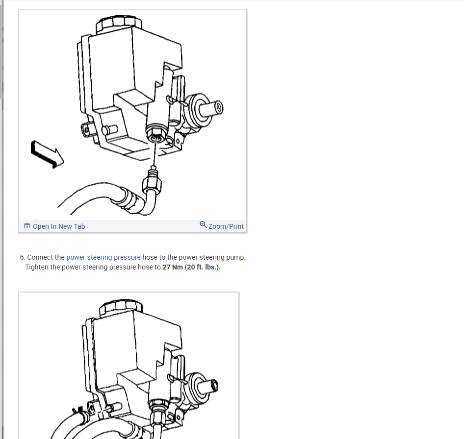

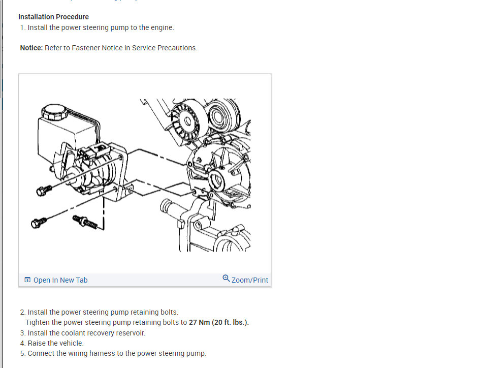

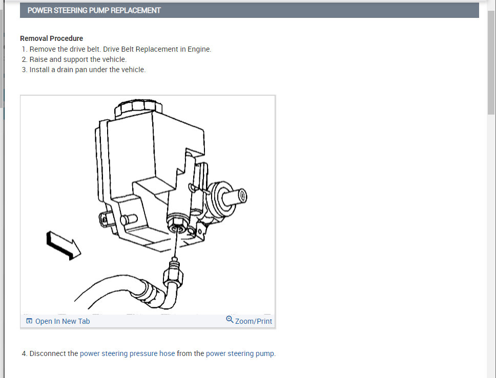

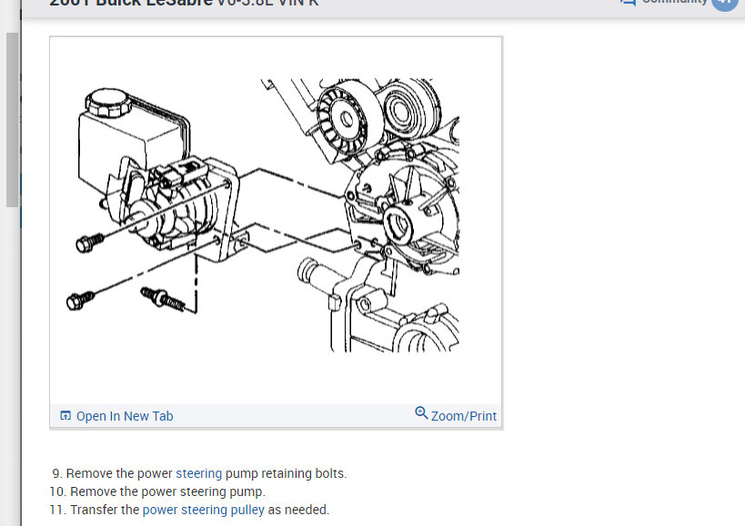

Please see the process below from the manual that will help with getting this replaced. Please run through this and let us know if you have questions on this.
