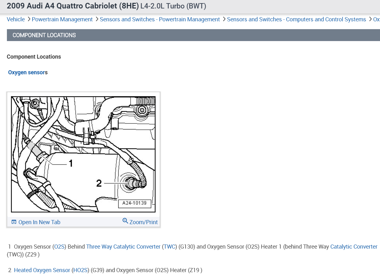

I have seen oxygen sensor short out causing the problem you have described. Let's disconnect the sensor and drive the car to see if check engine light acts the same.
Here is a guide and diagrams below to show the oxygen sensor location:
https://www.2carpros.com/articles/how-to-replace-an-oxygen-sensor
Please run down these guides and diagrams and report back.
