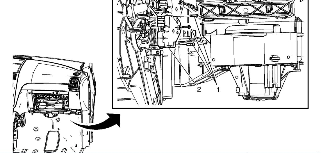

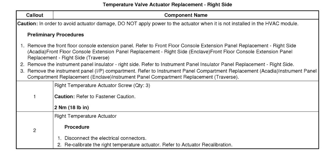

Yes, it could be the blend door actuator, not the mode door actuator.
They are different.
I have attached the location and the procedure for the passenger side actuator for temperature control. Remove that and see if you can manually turn the door and get cold air.

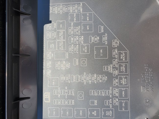

I did not. I'm new to this. I've added a pic of my panel. Which one would I pull?
May 1, 2020 at 3:46 AM
The one marked HVAC. remove it for 2 minutes.
