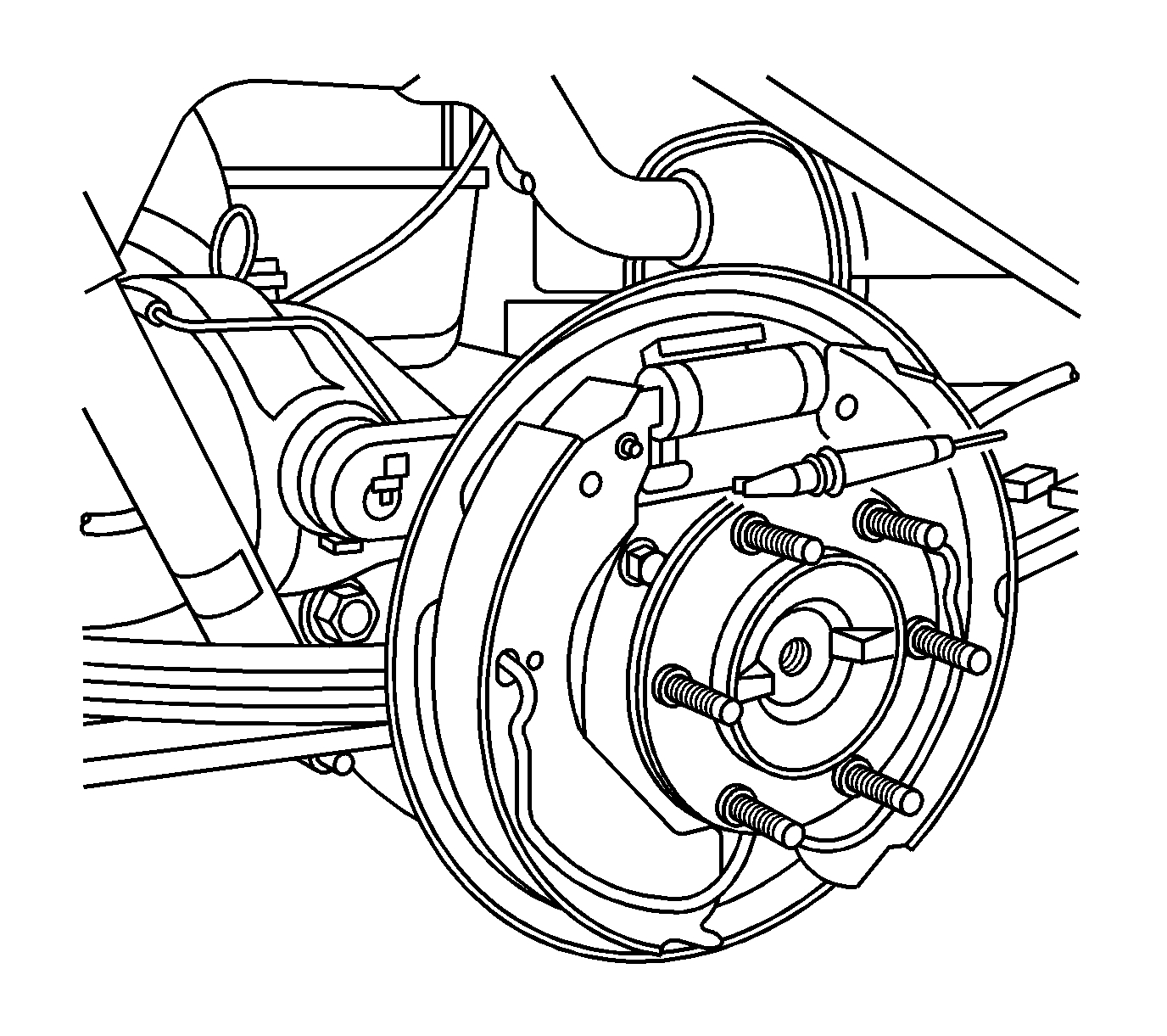

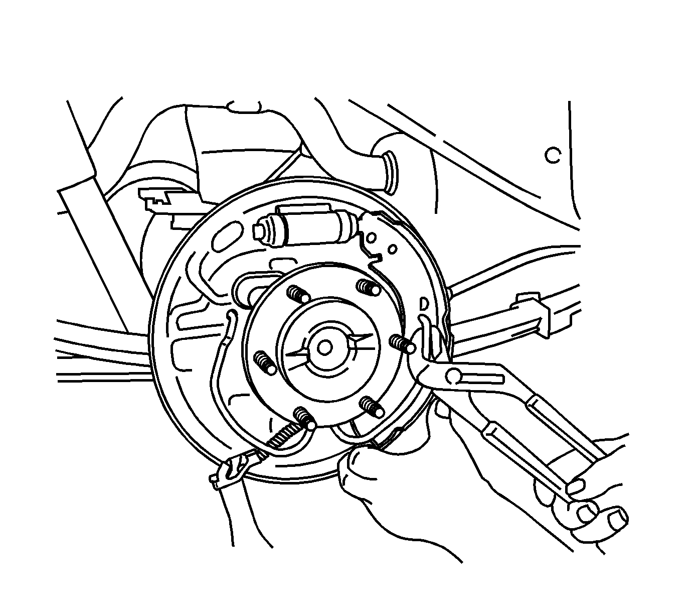

I don't have enough arms to get the horse shoe spring in place on my rear drum brakes. Any tricks or special! Tools that could help?
Sep 15, 2019 at 7:50 PM
  • 110,194 POSTS
Welcome to 2CarPros.
They are a pain. I agree. You have two choices. Use a good set of channel locks or there is a specific tool. It is a brake spring spanner. The brake tool part number is J 38400. You can get them at any parts stores.
I attached a pic of one being used on your vehicle. See pic 1.

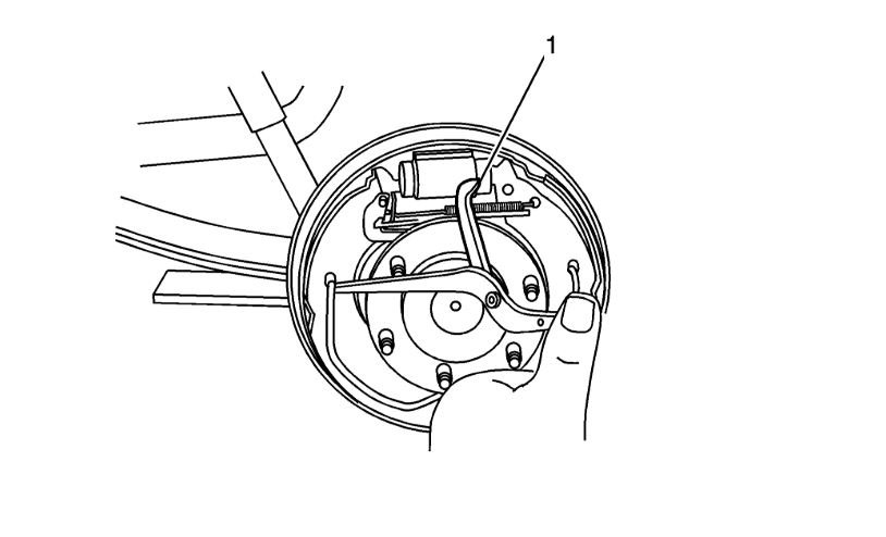

Also, here are the directions for that portion of the brake job. The remaining pics correlate with these directions.
2. Install the park brake cable in the lever.
pic 2
Important: Ensure that the retractor spring is properly seated in the retaining bracket at the bottom of the backing plate.

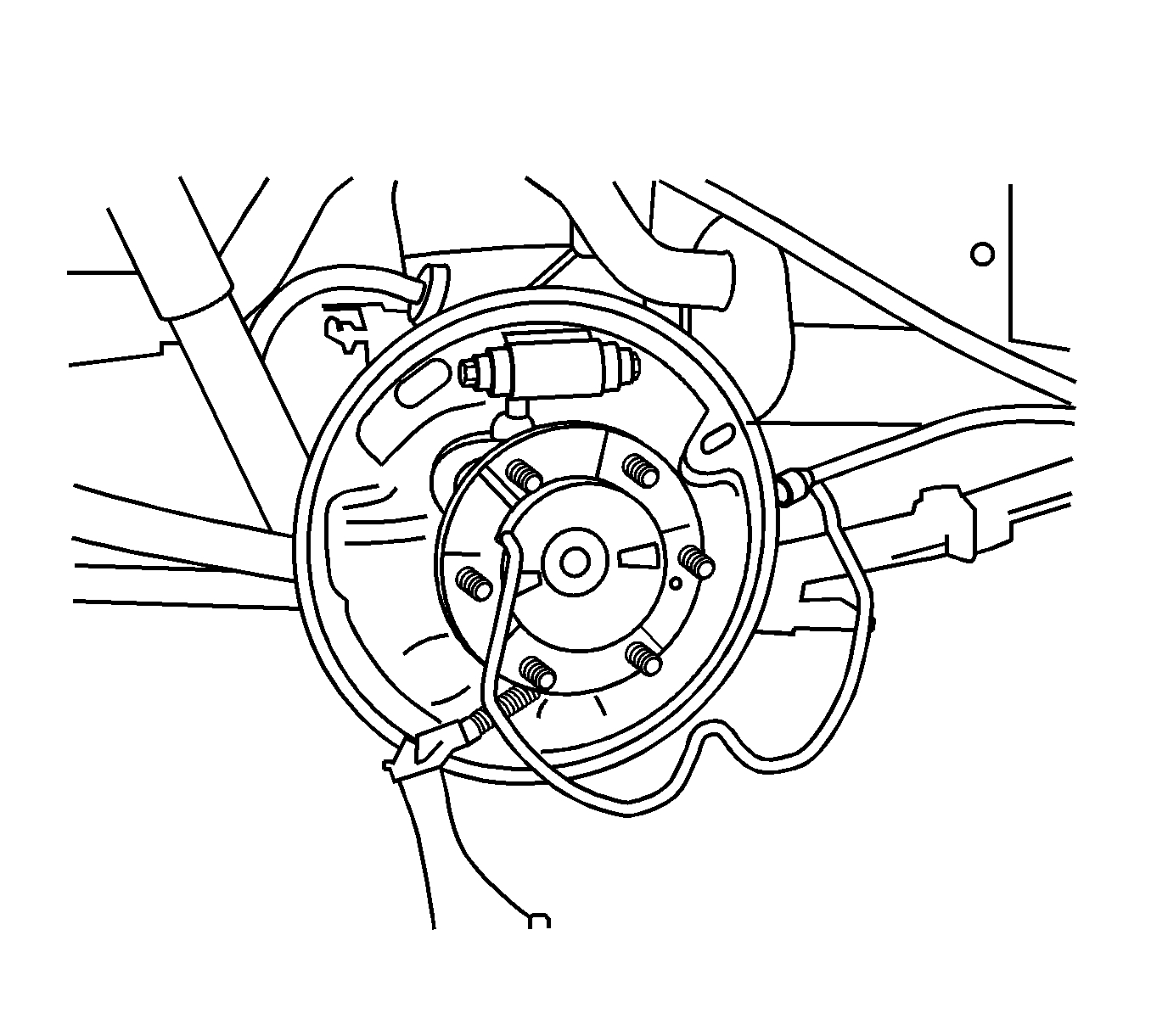

3. Install the retractor spring on the backing plate.
pic 3

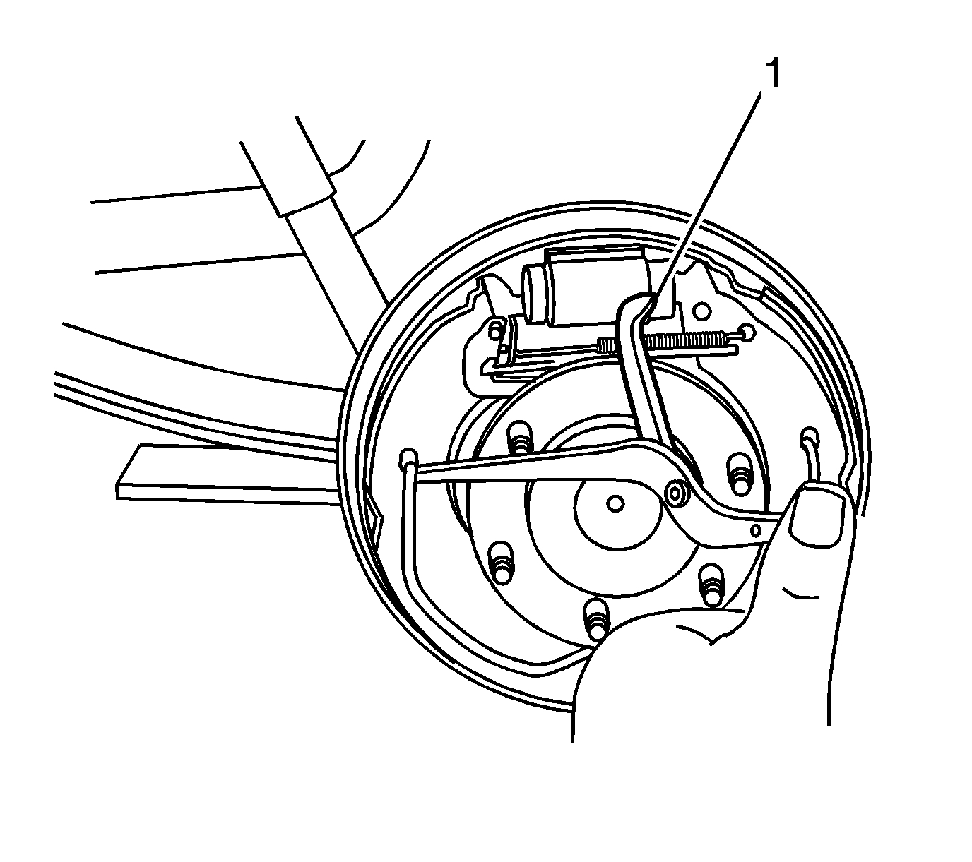

4. Using a pair of channel locks, install the retractor spring in the primary brake shoe.
pic 4

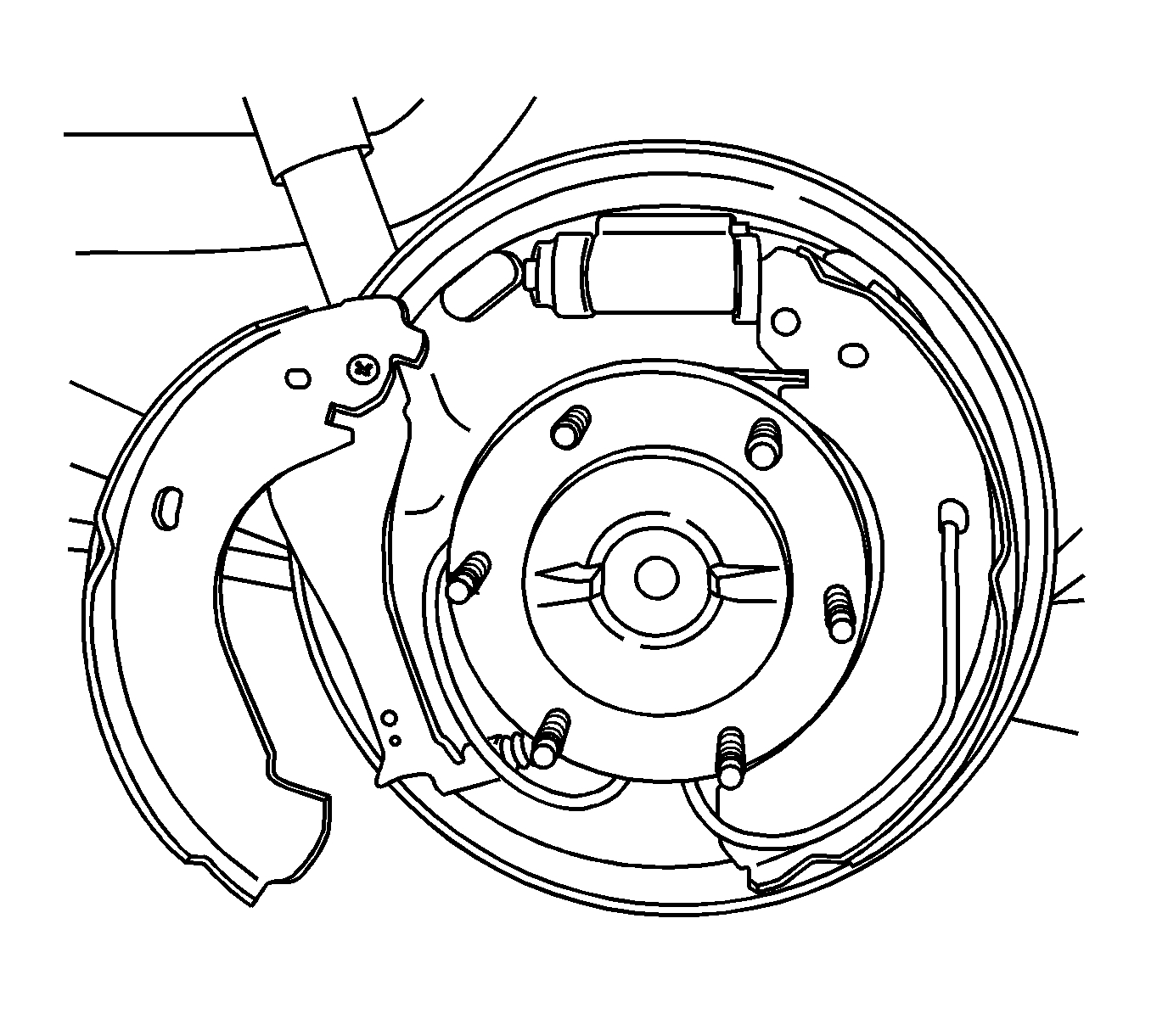

5. Install the secondary brake shoe on the backing plate.
pic 5

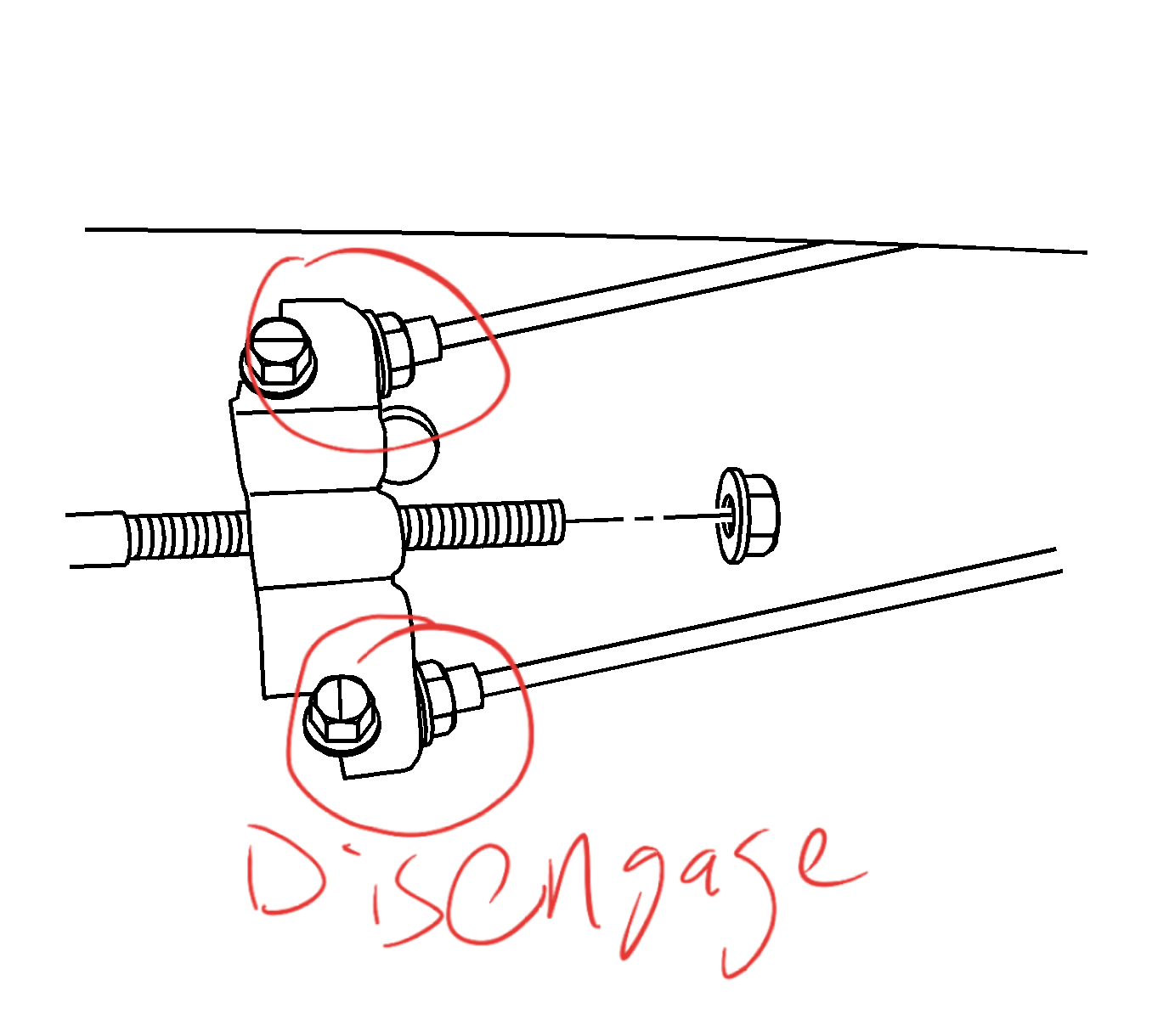

Important: In the following service procedure, the retractor spring can be installed by the use of either the special tool called out or by the use or a pair of channel locks.
6. Using the J 38400 (1) or equivalent, install the retractor spring in the secondary brake shoe.
pic 6

Hello and welcome to 2CarPros. As JACOBANDNICKOLAS stated this repair can be complicated and the special tool is needed. Even with the special tool is difficult. I usually disengage the parking brake cable under the middle of the vehicle on the driver side. I do it one side at at a time depending on which side I do.
Do not mess with the adjustment nut. There is a spring on the cable where you can actually pull to release it from the equalizer which will make life easier.

Thank you so much for the help. The info was helpful and the job is complete. Do your experts have any recommendations regarding sealing material to use on headlight and parking light lenses? I have tried super glue, windshield mastic, caulk, and the 3m black rubber goo that is supposed to be the best. None lasted more than a couple weeks. I wonder if the wind speed or maybe vibration is more than the adhesives/sealers can handle. I also haven't found any lens restorer that last, any advise on that will be appreciated. Thanks again, Ted
