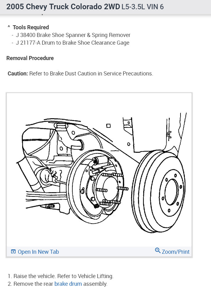

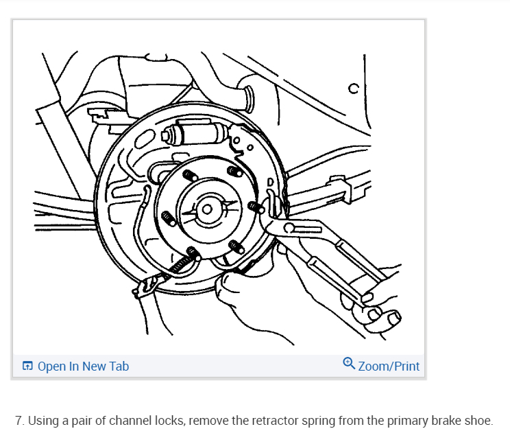

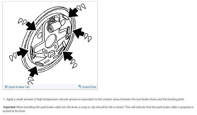

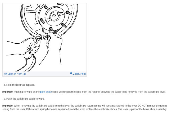

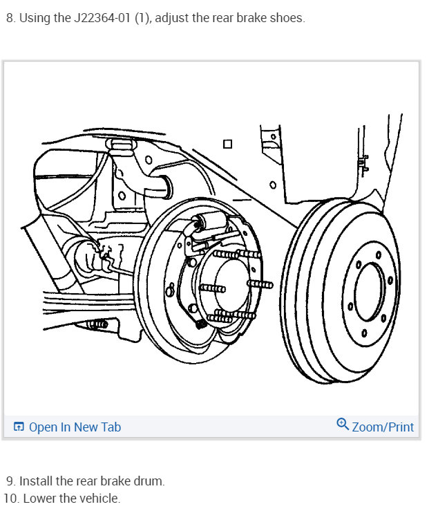

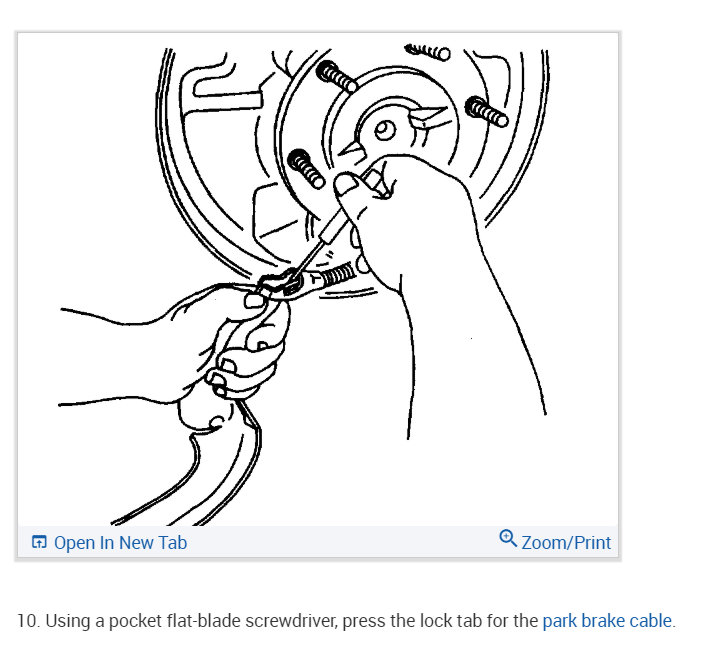

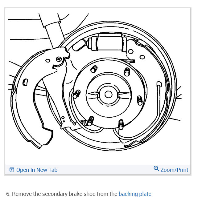

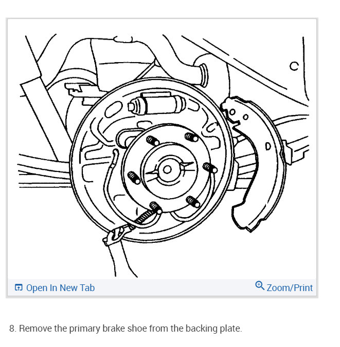

Looking for rear drum brake diagram
Tuesday, April 6th, 2010 AT 8:07 PM
3 Replies
BLUELIGHTNIN6
MECHANIC
16,542 POSTS

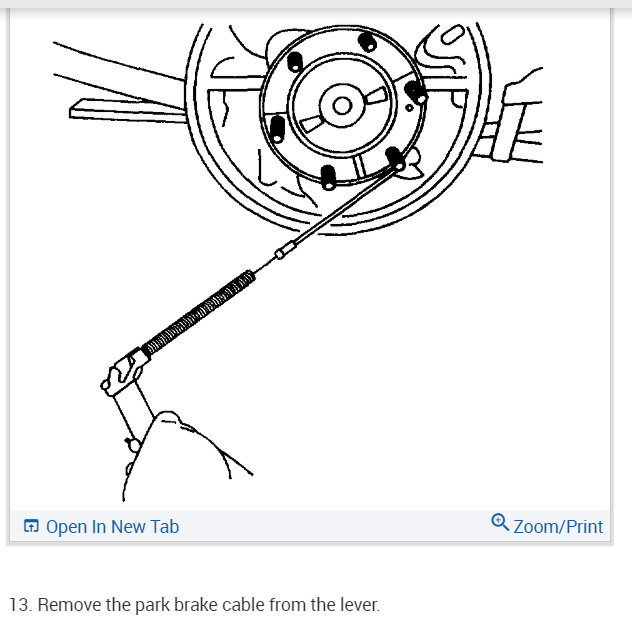

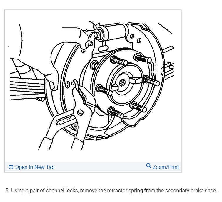

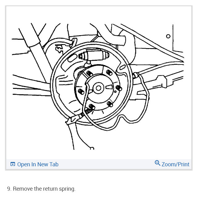

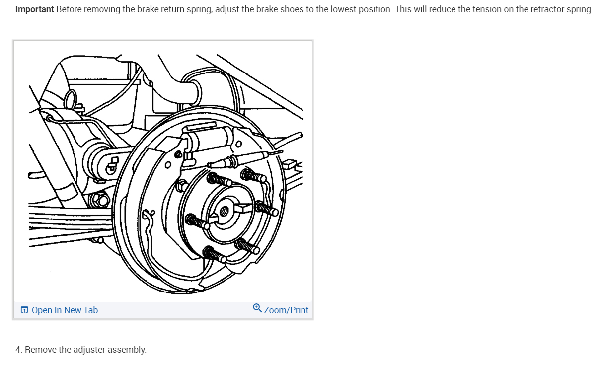

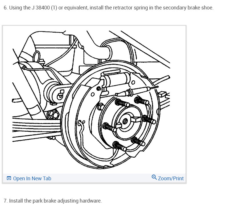

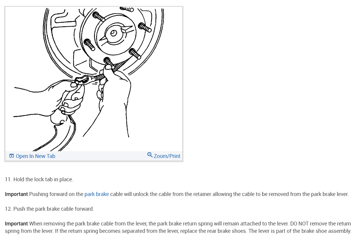

This guide will help you change the brake shoes out because they are the same style but I have included diagrams for your truck in the diagrams below.
https://www.2carpros.com/articles/how-to-replace-rear-brake-shoes-and-drums
Images (Click to make bigger)
