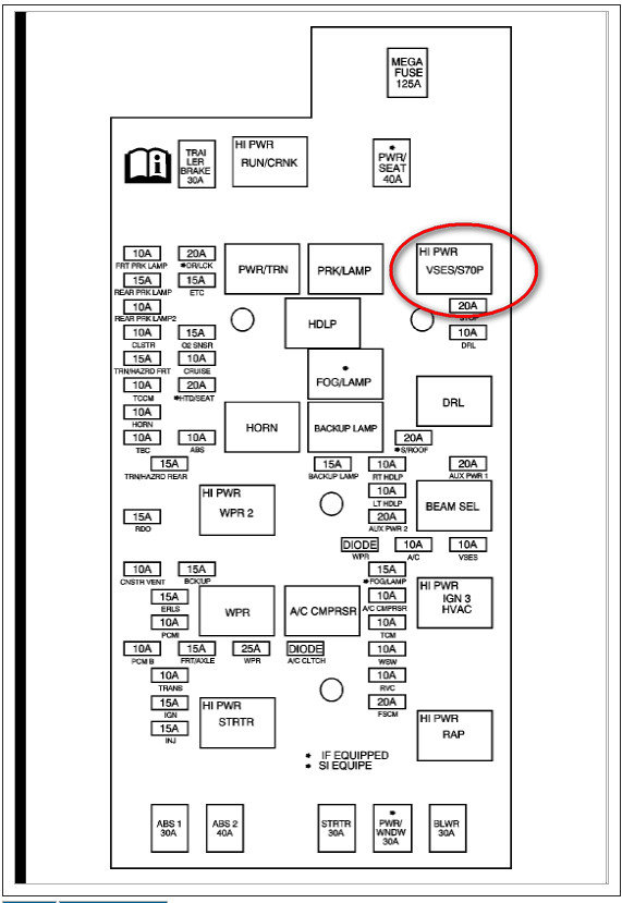

HMAC300
  • 48,601 POSTS
there is a brake light relay in under hood fuse box it's vses/stoplight. also if you have a trailer connection from factory there is a trailer lighting converter as well

WRENCHTECH
  • 20,761 POSTS
You're going to have to do some testing at the relay to find out if the relay is sending power out. All the brake light switch does is provide trigger ground for the relay. Locate the relay and see if you have access to the wires connected to it. http://i1198.photobucket.com/albums/aa448/Wrenchtech/215054037.jpg.gif

Where might the relay be?
Jan 5, 2016 at 7:12 PM
WRENCHTECH
  • 20,761 POSTS
In the relay box. See picture
