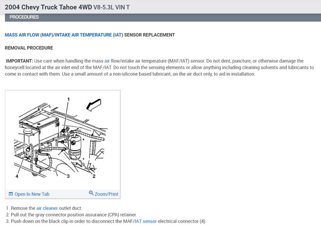

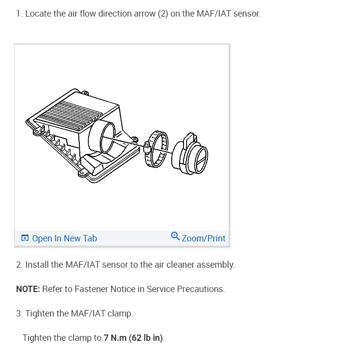

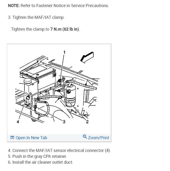

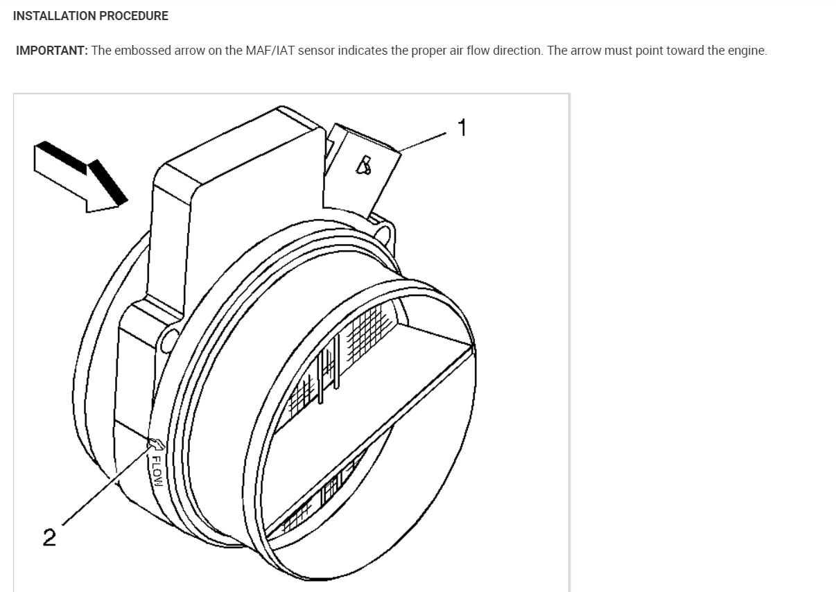

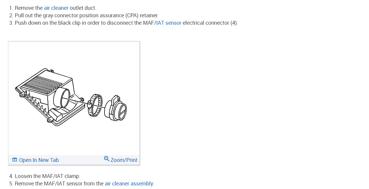

Yep, if the engine is running okay you should replace the MAF sensor, don't try to clean it because it won't work, you need a new one. Also did you use AC Delco parts on the spark plugs O2 sensor and plug wires? If not, this will affect the mileage and engine power as well. Especially the spark plugs. Here is the MAF sensor location so you can change it out. Check out the images (below). Please let us know what happens.

The plugs and wires are AC Delco, the O2’s were Bosch it’s all O'Reilly's had at the time in stock. I will try that next I guess, is there a way to test if it’s bad before tossing another $150.00 at the truck?
