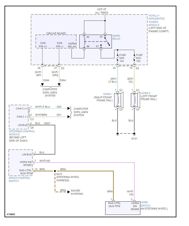

You cannot assume anything today because there are multiple computers hung onto every circuit. You would be right on older vehicles that twelve volts should be at the horn relay. In this case the clock spring is a good suspect, but the repair estimate is way out of line. Thanks to the liability insurance built into the cost of the part, a typical clock spring should cost around $150.00. Unless there's something I am not aware of, replacement should take about an hour.
This wiring diagram below can show you how the system works.
The clue you should look for is if the clock spring is coming apart, other functions on the steering wheel will also fail. That can include cruise control switches, and the airbag warning light will turn on.
If only the horn function is dead, I would recommend using a scanner to see what the Integrated power module is seeing as far as "horn request" signal. If that is showing up when you press the horn switch, that module becomes the better suspect.

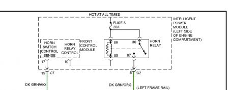

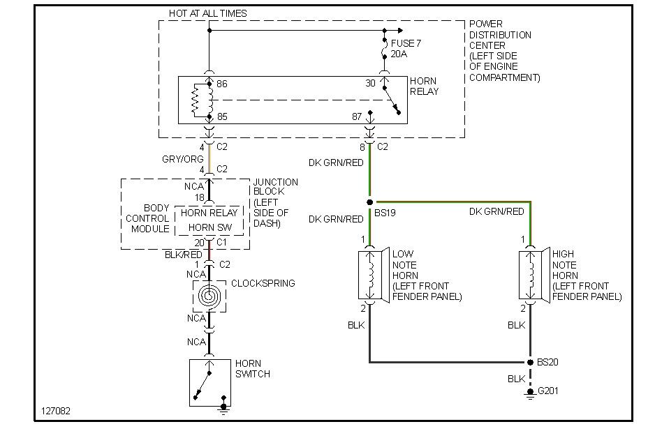

  • 75,992 POSTS
Here you go
https://images.2carpros.com/forum/automotive_pictures/12900_h1_18.jpg
https://images.2carpros.com/forum/automotive_pictures/12900_h2_17.jpg
https://images.2carpros.com/forum/automotive_pictures/12900_h3_6.jpg
May 26, 2020 at 5:01 PM (Merged)

Did you use a testlite at the horn relay? Terminals 30 and 86 are hot all the time. If you use a jumper between cavity 30 and 87, the horn should sound, does it? If it does, the problem is in the steering column or front control module.

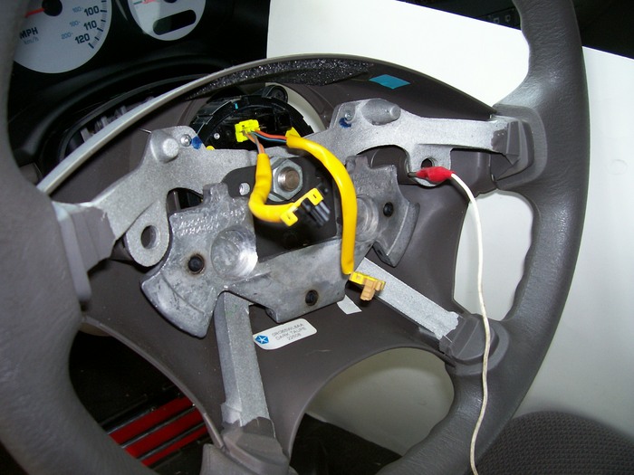

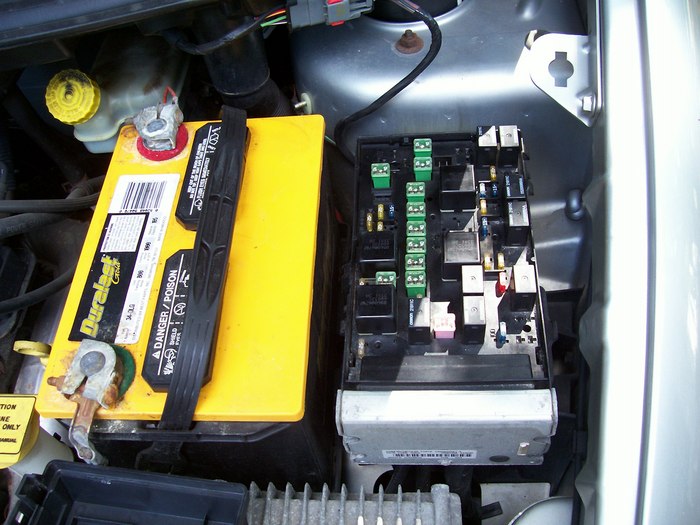

Finally, I found the problem, the printed board where the firing is broken a part in the middle. So I connect it with wiring from the out side. It works great, thank you so much for your help.

Bass, the location of the printed board is beside the battery(please look at first picture). I attach the diagram(picture 2-4) and check the printed board with the multimeter and has a good connection. And make sure the clockspring has not broken. Autozone sells the clockspring ( Part Number: 525-101 )about $ 50. Please let me know if you need more information. BK

Did you check for voltage at the fuse circuit? Even if the fuse is good, if no voltage on the fuse circuit, the circuit is still dead. You could swap that horn relay with another relay, just make sure sure they are the same, note the diagram and reading on the relay, where applicable.
Usually the problem is the wiring in the steering column, but, I'd check everything else first. At the horn relay cavities, if you use a jumper wire between terminal 30 and 87, the horn should sounds, if it does, that part of the circuit is ok. Then you would have to check control side of relay.
Note wiring diagram.
