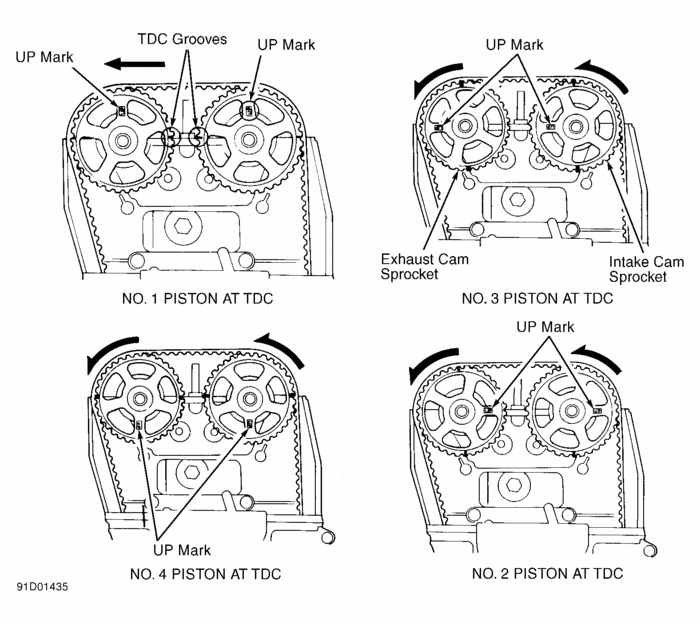

i am replacing my timing belt and the crankshaft moved on me can you tell me how to reset the timing it is an sh motor with dual over head cams thanks.
Aug 8, 2020 at 10:47 AM (Merged)
BLUELIGHTNIN6
  • 16,542 POSTS
https://images.2carpros.com/forum/automotive_pictures/261618_Graphic_676.jpg
https://images.2carpros.com/forum/automotive_pictures/261618_Graphic2_95.jpg

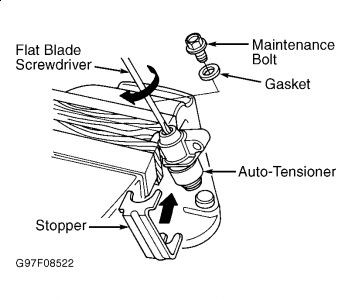

JOHN TERRY JR.
for reasons that i woun't go into now. i had to remove the timing belt covers and check to see if all the timing alignment points were lined up. they are lined up but there is slack in the balancer belt. the timing belt seems ok. what's the best way to remove the slack?
BMRFIXIT
  • 19,053 POSTS
Remove the auto-tensioner from front of engine. Place auto-tensioner in soft-jawed vise with maintenance bolt facing up. See Fig.below. DO NOT grip housing. Remove maintenance bolt from top of auto-tensioner. Use a flat-bladed screwdriver to compress auto-tensioner to bottomed out position. Place stopper on auto-tensioner. Refill any oil that may have spilled out, and install maintenance bolt with new gasket. Install auto-tensioner on engine with stopper in place. Install timing belt around crankshaft drive pulley, adjusting pulley, water pump, exhaust camshaft pulley, then intake camshaft pulley. Ensure crankshaft and camshaft pulleys remain aligned at TDC
https://images.2carpros.com/forum/automotive_pictures/99387_Graphic1_664.jpg
