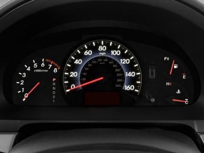

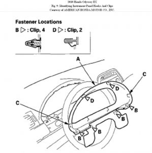

Hi there,
How can I take the black plastic cluster cover off. I can pull the top and it comes off but the bottom will not come off.
Thanks for your help!

The cluster have 8 clips holding it. 2 clips on the top and 6 clips on the bottom. Prabably the lower clips are tighter, you just have to pull it a liittle harder to release the clips. Make sure you adjust the steering column to the full tilte down position and to the full telescopic out position when removing the cluster cover.

Thanks for your reply. I am still can not get the cover off. They are two knops going under the silver dash. Any ohter get it out with breaking the cover.

Hi actv8, Hope the following helps. INSTRUMENT PANEL REMOVAL/INSTALLATION NOTE: "¢ Take care not to scratch the dashboard and related parts. "¢ Use the appropriate tool from the KTC trim tool set to avoid damage when prying components. 1. Tilt the steering column down. 2. Remove the instrument panel (A). A) Gently pull out along the bottom to release the clips (B) and hooks (C). B) Gently pull out the upper portion of the panel to release the clips (D).
https://images.2carpros.com/forum/automotive_pictures/192750_InstrumentPanel10OdysseyFig09_1.jpg
3. Install the panel in the reverse order of removal, and note these items: "¢ Check if the clips are damaged or stress-whitened, and if necessary, replace them with new ones. "¢ Push the clips into place securely.

From the picture above there's 4 B clips on the bottom, put your fingers in the bottom middle guage cover and pull on the bottm of the middle guage cover B clips to release the clips.

Thanks all of you.

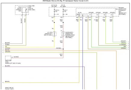

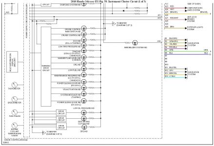

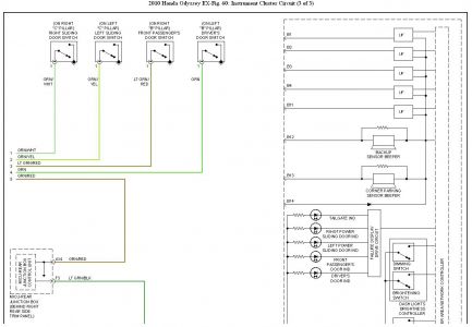

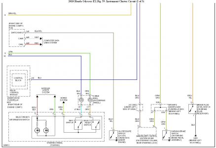

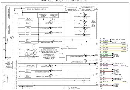

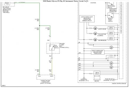

Finally I got it out. When I took the cluster out there were three weirs out of the big green clip.
Do you have the wiring diagram for it?
again thanks for your help.
Aug 28, 2010 at 10:10 AM
KHLOW2008
  • 41,814 POSTS
https://images.2carpros.com/forum/automotive_pictures/192750_InstrumentCluster10OdysseyFig58a_1.jpg
https://images.2carpros.com/forum/automotive_pictures/192750_InstrumentCluster10OdysseyFig58b_1.jpg
https://images.2carpros.com/forum/automotive_pictures/192750_InstrumentCluster10OdysseyFig59a_1.jpg
https://images.2carpros.com/forum/automotive_pictures/192750_InstrumentCluster10OdysseyFig59b_1.jpg
https://images.2carpros.com/forum/automotive_pictures/192750_InstrumentCluster10OdysseyFig60a_1.jpg
https://images.2carpros.com/forum/automotive_pictures/192750_InstrumentCluster10OdysseyFig60b_1.jpg
