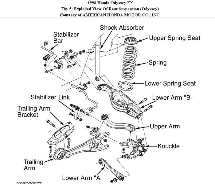

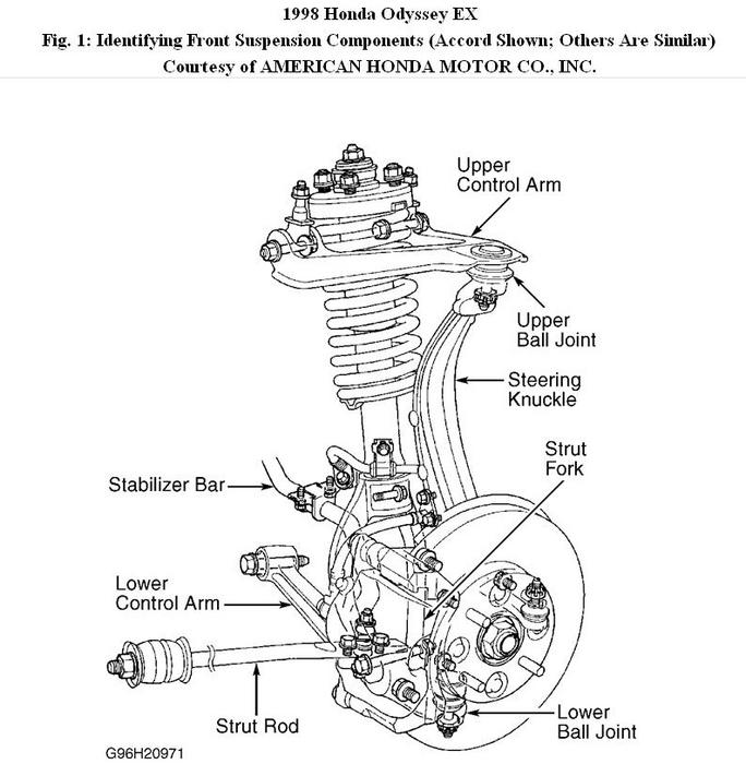

JOVAZ
  • 1998 HONDA ODYSSEY
I have a 1998 honda odyssey and I want to replace the shocks, but I dont know if they have shocks and struts or only shocks?
Wednesday, December 30th, 2020 AT 11:03 AM (Merged)
KHLOW2008
  • 41,814 POSTS
Refer to diagram. Front strut, rear shocks. Check out the diagrams (Below). Please let us know if you need anything else to get the problem fixed.
