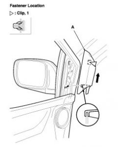

I'm looking for help in replacing my driver's side mirror. I already have the mirror in hand, just need to change it out. Thanks.

Replacement steps for power mirror is below..let me know if you have manual mirrors instead as steps may differ... Remove the mirror mount cover, as follows: Lower the door glass fully. Carefully pry out the mirror mount cover by hand.
