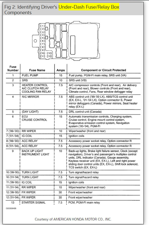

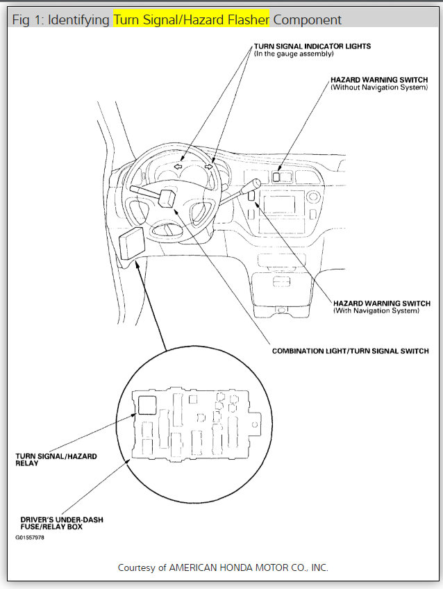

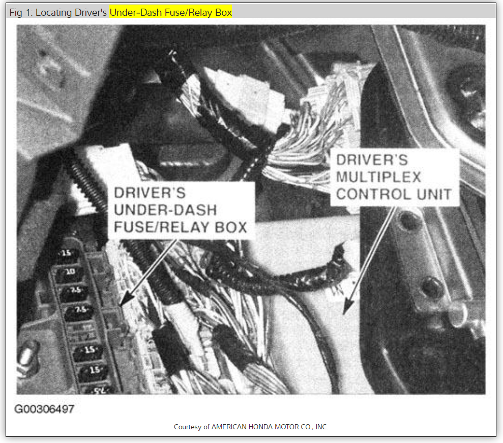

All of our turn signal and hazard lights suddenly stopped working.
May 24, 2008 at 3:59 AM
  • 75,988 POSTS

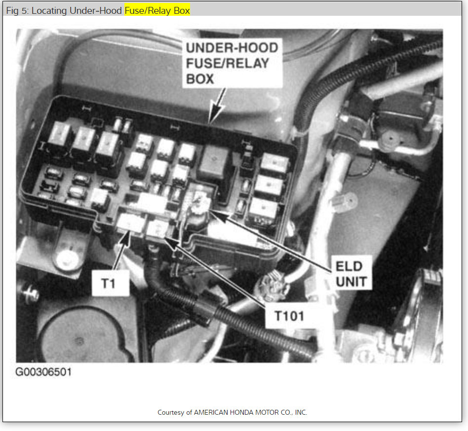

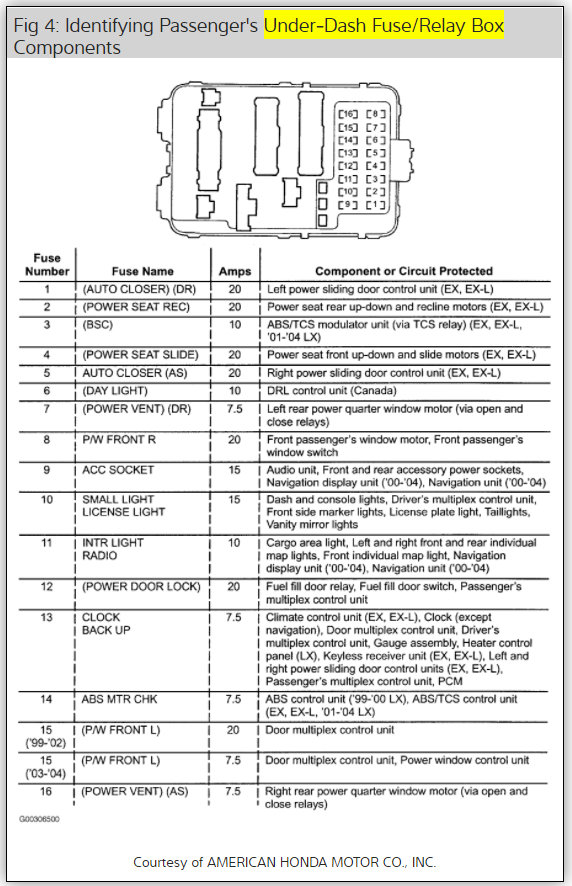

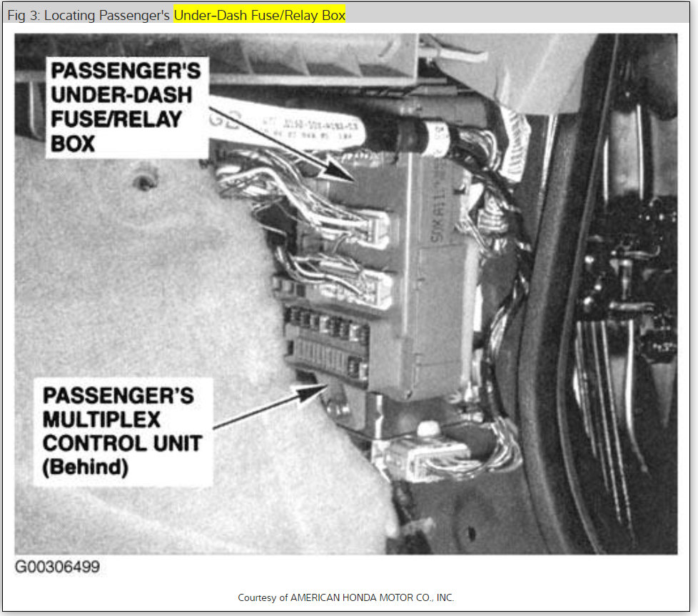

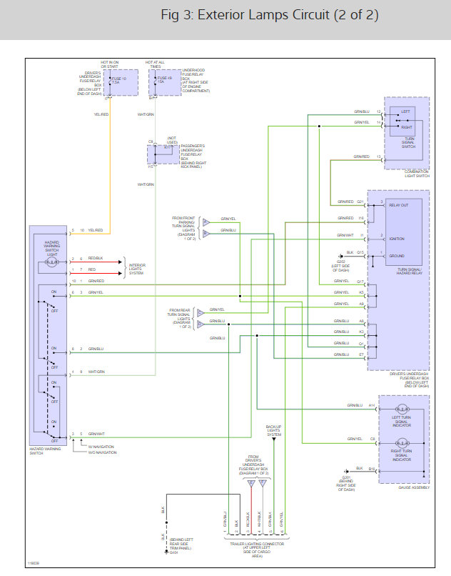

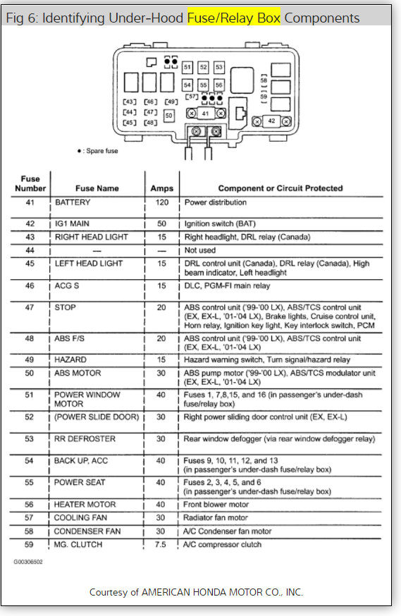

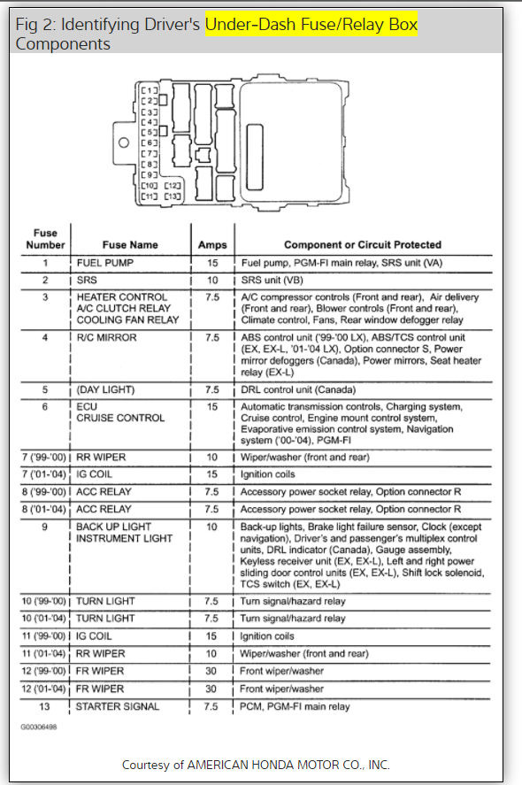

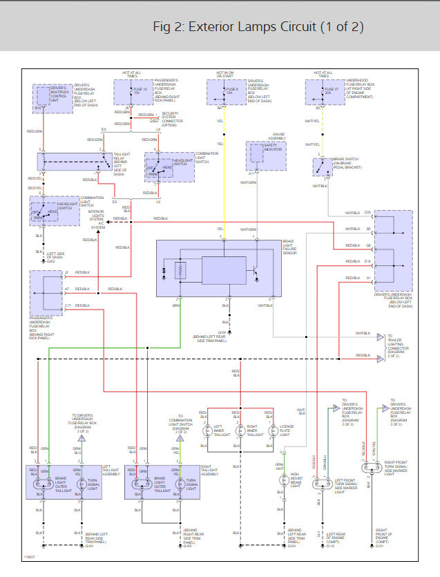

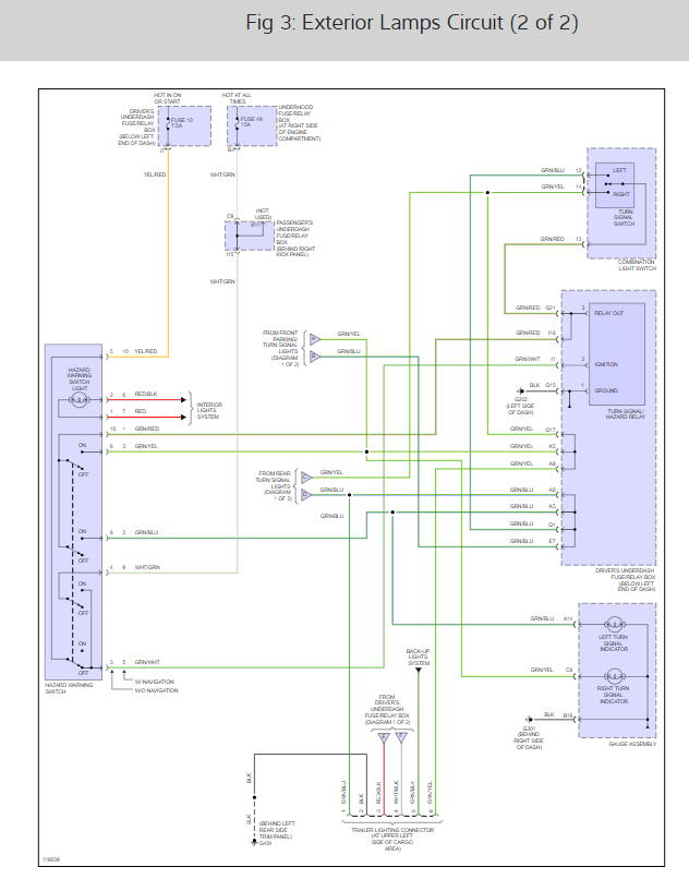

This sounds like a fuse or the turn signal flasher here is a guide to help you test the fuses and the location of the flasher unit which is under the dash on the drivers side.
and
See where you are losing power.
Check out the diagrams (Below). Please let us know what you find.
Cheers
May 24, 2008 at 4:10 AM
BLEUJAEGEL
Thanks you it was the flasher I got a new one for $43.00 works perfect thanks a bunch I love this site.
