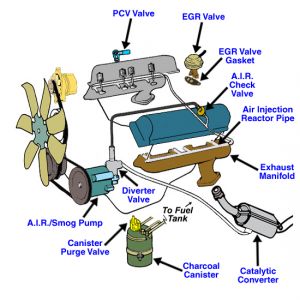

https://images.2carpros.com/forum/automotive_pictures/46384_egr_valve_1.jpg
have you cleaned the egr passages to the intake? there could be hard carbon deposit there. when your car is running, remove the pcv valve and put your finger on it, you should feel strong suction. if not, let me know.

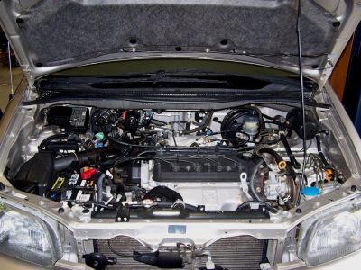

have you cleaned the egr passages to the intake? I don't really know. I stuck a stiff wire up the EGR intake port and poked as best I could. But I can't find a diagram of the manifold internals, and I can't see inside, so I don't really know if they're clear or not. Removing the manifold is beyond my tools, time, and ability. So that would be a very expensive last resort. I'd wanna make [u:94c18fd522][i:94c18fd522]damn[/i:94c18fd522][/u:94c18fd522] sure that's the source of the hesitation before even considering it. there could be hard carbon deposit there. Yes. That's why I tried to clean the passages with spray cleaner, which I know may or may not work. (See original posting.) when your car is running, remove the pcv valve and put your finger on it, you should feel strong suction. Yep. Suckin' strong. Here is the engine compartment:
https://images.2carpros.com/forum/automotive_pictures/424062_Odyssey_70070414_5_Large_1.jpg

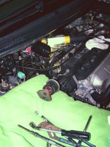

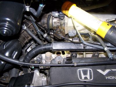

This is with the EGR removed. The round exhaust port is on the left. The rectangular port on the right is the intake. It has a small horizontal hole inside (also on the right). That is where I used the wire and throttle body cleaner:
https://images.2carpros.com/forum/automotive_pictures/424062_egr_004_Large_1.jpg
Here, the old EGR is removed:
https://images.2carpros.com/forum/automotive_pictures/424062_egr_005_Large_1.jpg

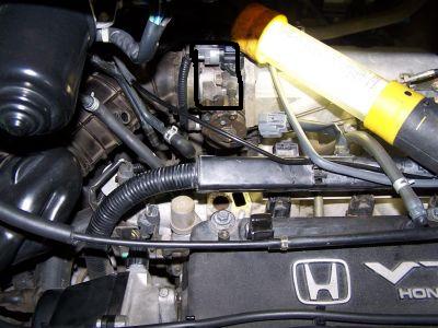

you will need to remove the throttle body to get behind the hole from the EGR valve. it might be hard rock carbon in the middle of that hole leading to the throttle body.
https://images.2carpros.com/forum/automotive_pictures/46384_original2_1.jpg
here is another view of the intake I'm sending the same picture in your email , so you can see it more bigger.
https://images.2carpros.com/forum/automotive_pictures/46384_intake2_1.jpg
