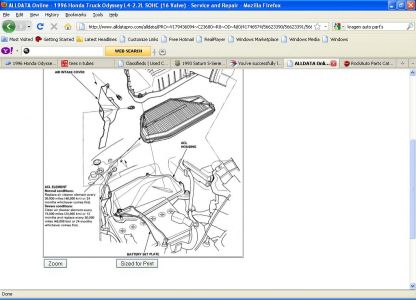

I have been trying to figure out how to replace the air filter, but the manuals that I look at don't seem to correspond to what I see in the engine compartment. I don't really see any retaining clips, or bolts. All I see are four screws on top of the housing. Could you please give me some clear instructions on how to remove the air filter cover?
Thanks

ACL Element Replacement: NOTE: Remove the air intake cover, loosen the battery set bolt, and move the battery set plate before removing the ACL housing cover. So what you do is remove that bar that goes across the top of the battery aka battery seat plate then loosen those four screw's on the air cleaner top and take the top off.
