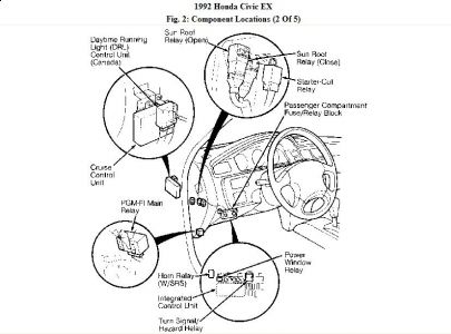

This does not give us much to work on. From the symptoms the most likely cause is a power disruption and it can be caused by : 1. A failing ignition switch. This could cause the ignition system to stop working and engine stalling. When restarted the switch would continue to work. 2. An intermittently failing PGM-FI main relay. This relay is known to intermittently fail and when it happens, it can cause a lot of different symptoms such as difficult starting, jerking, lack of power. It can stop the fuel pump from working and engine stalling. To check and rectify this, remove the relay and resolder all the joints and it should be as good if not better than new.

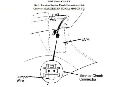

3. A failing distributor. 4. A failing fuel pump. I would suggest checking if there are any trouble codes stored in the ECM. Here are the procedure for checking/rretrieving codes. Bridge the SCS connector, turn ignition ON and if Check Engine Light stays lit, no code is stored. If it starts to blink, then you need to count the blinking to get the code. Note the length of the blinks, prolonged blinks = 10 while short blinks = 1.

I changed out the battery clamps, spark plugs, alternator belt, PGM-FI Relay, Fuel Filter(I heard the fuel pump run after changing the filter and starting the car), Air Filter and it continues to die between 10 and 12 minutes after starting the car. The only other things that happen is the rpms drop when I hit the brakes at a stop and for the first time yesterday it did something wierd, the rpms droped to zero, engine light came on, but when I went an turned the key the rpms went back up to normal and the engine light went off.

Did you check for error codes?
Jun 24, 2009 at 8:10 AM
REDCAR1973
I had someone hook up and look for a code but none was given. It look like the chip was reset do to power loss....?
