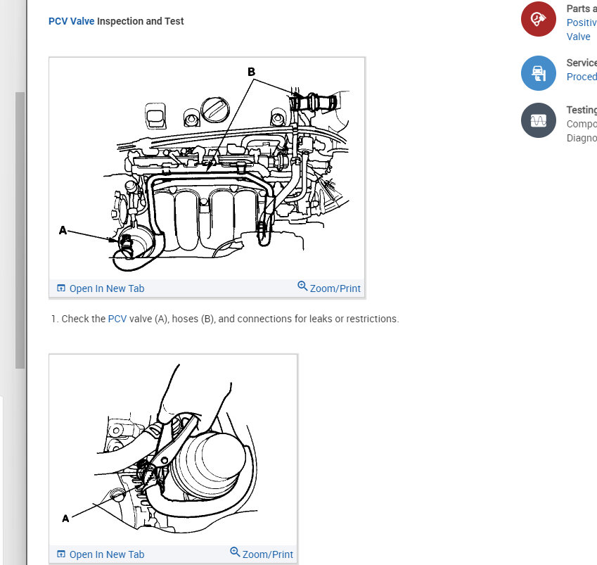

where is the PCV valve located on the 03 honda CRV
Jun 15, 2010 at 3:46 AM

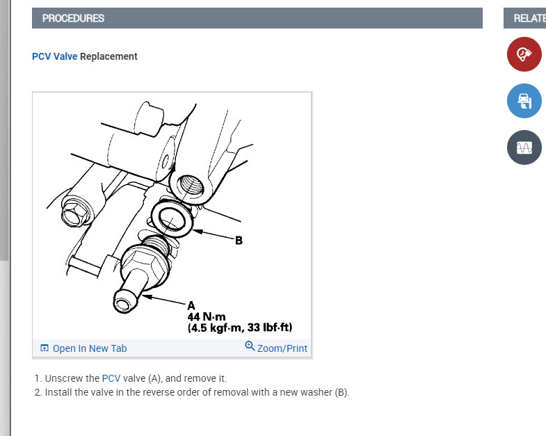

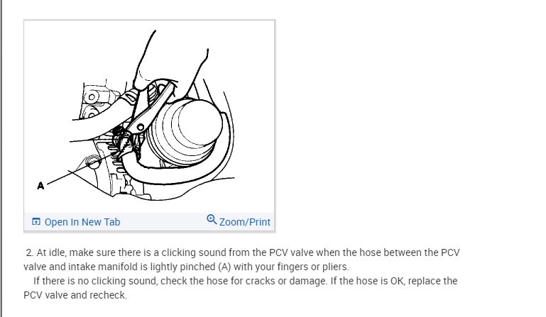

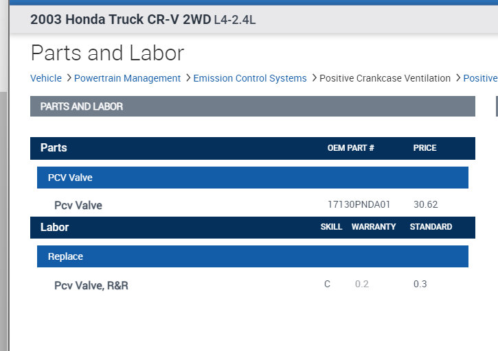

The PCV is located in the front passenger side of the engine, and I am attaching a number of documents that will help with finding it and replacing it.
PCV can cause a number of issues including a high idle if it is stuck open. Also, it can cause oil in the intake if you have high amounts of blow by.
