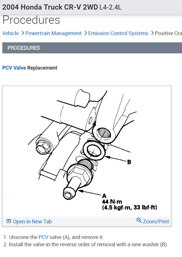

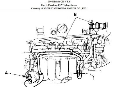

Please tell me precisely where to locate my pcv valve and how to replace it ( what tools to use), thank you.
Feb 21, 2009 at 7:32 AM
KHLOW2008
  • 41,814 POSTS
Hi Fshrman820, There are two designs first the PCV is plugged into a rubber grommet and replacement is rather easy. Only a pliers to remove the clip is required to remove the PCV after unplugging it from the seat. Its on the rear of the engine.
