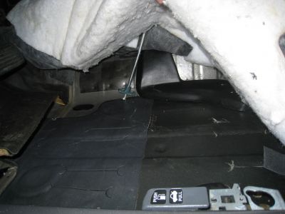

After try 2 didn't work, I ended up taking up the floor siding panels, the foot rest and then took up the carpet. The carpet is still quite wet. There is a body plug under the carpet, which i put silicon on and replaced and a plug just above the foot rest, which i siliconed and replaced. I can't see any signs of where the water could be leaking in cracks.
I did find some sort of what looks like an air duct that comes from the driver side of the shift console and ends up sitting flat on the floor and continues under the driver seat. There is some residual water that is under it - I'm not sure if this just a convenient place to sit or if this could be where the leak is coming from??
Do you know what this black duct is?? Could it be causing the leaking of water/condensation?? How would i test this?

Here is a picture of the duct that I am talking about.

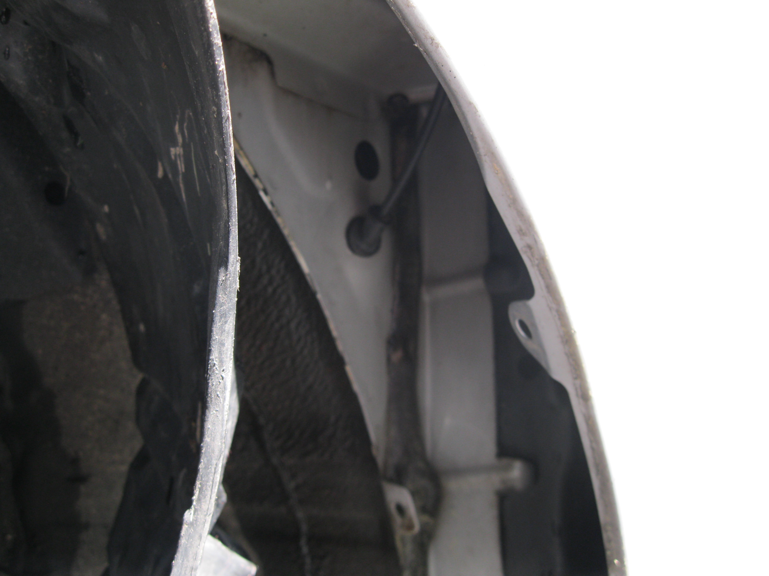

There is a 25mm rubber body plug located on the bottom side of the steel chassis frame member just behind each front tire. On the right side we recently discovered that the plug was missing when we tried to troubleshoot why the passenger floor was (very) wet. When driving in the rain, it appears as though water can accumulate inside the member during a rainstorm and eventually leak into the interior. We also see that the water damage extends all the way back to the trunk and is comming up from underneath. Does my diagnosis make sense, and if so how can I dry it out? Where can I go on the internet to determine whether or not my model car has a documented history of problems with water leaking into the interior?

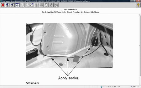

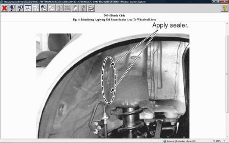

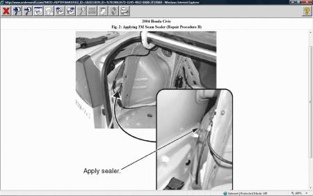

There is a Tech Bulletin on your year as follows: WATER LEAKS INTO THE TRUNK FROM A BODY SEAM TECHNICAL SERVICE BULLETIN Reference Number(s): 03-067,  Date of Issue:   February 18, 2005 HONDA:2001-2005 Civic CATEGORY:Body APPLIES TO: 2001-04 Civic 2-Door and 4-Door - ALL; 2005 Civic 2-Door - From VIN 1HGEM2...5L000001 thru 1HGEM2...5L030136; 2005 Civic 4-Door - ALL Superceded Bulletin(s): 03-067,  Date of Issue:   September 23, 2003 Related Ref Number(s): 03-067 ARTICLE BEGINNING SYMPTOM NOTE: Supersedes 03-067, dated September 23, 2003 Water in the trunk. PROBABLE CAUSE Lack of sealer at various seams. CORRECTIVE ACTION Apply 3M Ultra Pro Seam Sealer to the affected seam(s). PARTS INFORMATION 3M Ultra Pro Seam Sealer: 3M P/N 051135-08302 WARRANTY CLAIM INFORMATION In warranty : The normal warranty applies. WARRANTY CLAIM INFORMATION OP# Description FRT 857012 Remove the trunk side trim panel and trunk floor, then leak test A Repair procedure A 0.2 B Repair procedure B 0.2 C Repair procedure C 0.4 D Leak test to check the repair 0.2 0.6

it may be comming from the spots in the photos, ot the "B" pillar, thats the post between the front and rear doors. Remove the trim panels and if you have to, have a helper run a hose on it while you look inside for water infiltration.
