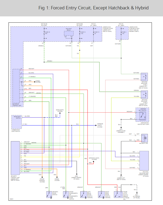

My car's key-less entry lock horn confirmation was suddenly put into silent mode. When I press the lock button on my remote, the car will lock and flashes the turn signals three times. But when I press the lock again, the confirmation lock horn honk was gone as it was supposed to honk after pressing the remote lock button twice. Even the seat belt reminder was in silent when driving at certain speed, does not beep anymore, but beeps by the time I put the key on the ignition.. How can I reactivate these features back to its factory default?

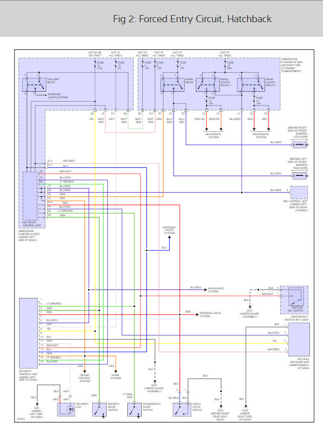

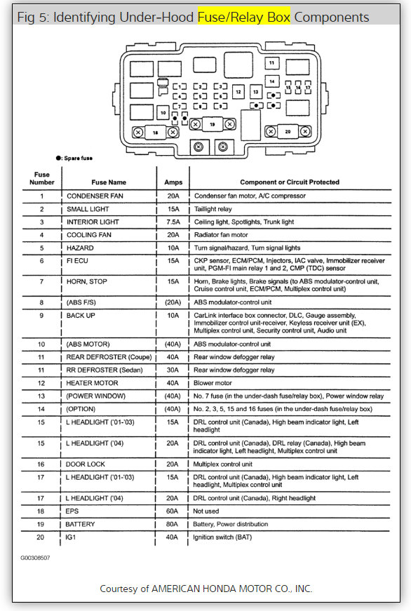

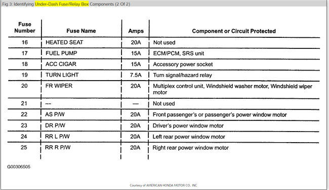

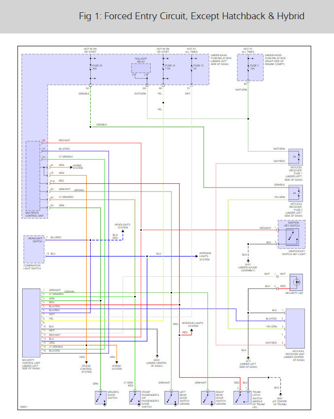

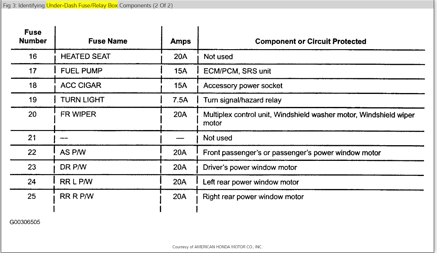

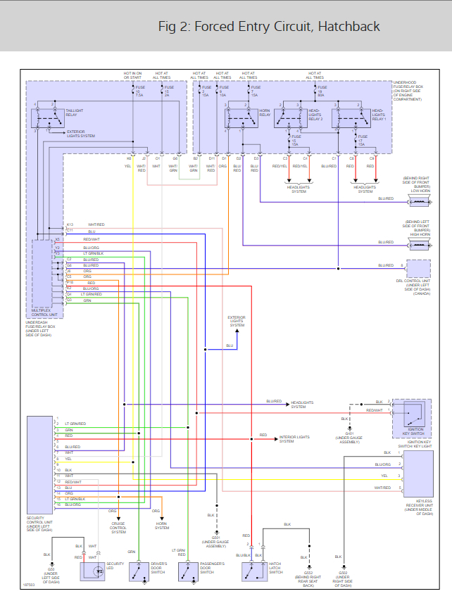

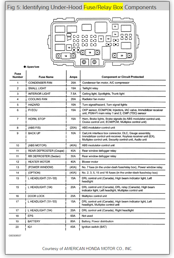

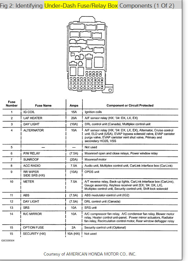

There are many fuses that run the system. Here is a security system wiring diagram so you can see each fuse and a guide to help you check them:
May 13, 2018 at 4:20 AM
BRADIX
  • 9 POSTS
Which fuses would I check?
May 13, 2018 at 4:30 AM
  • 55,456 POSTS
20, 12, 10, 15, and 2 if they are all okay it sounds like the alarm module is going out which will need to be programmed by a shop. Can you see the fuses in the wiring diagram or are they too small to see?

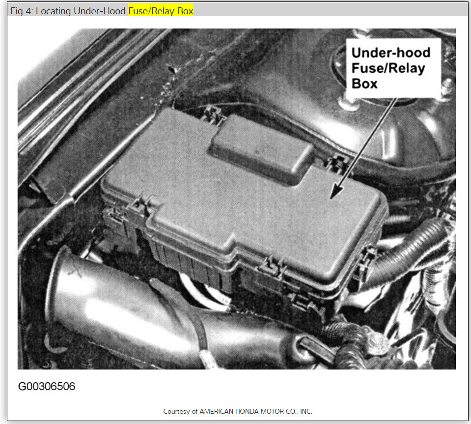

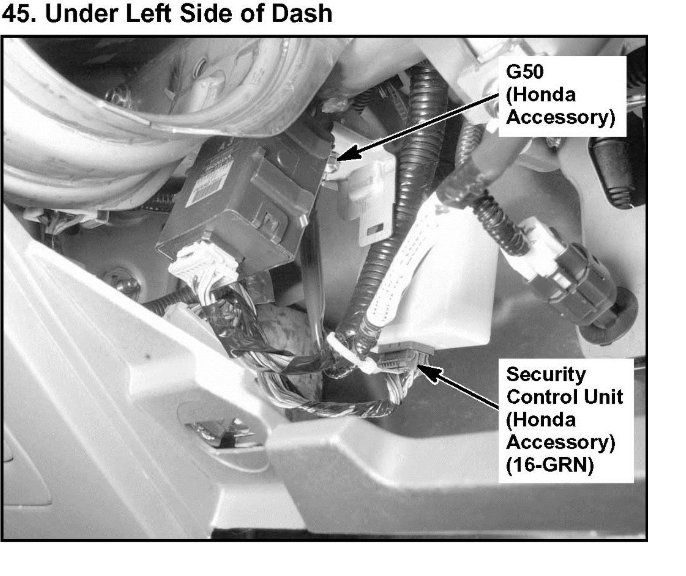

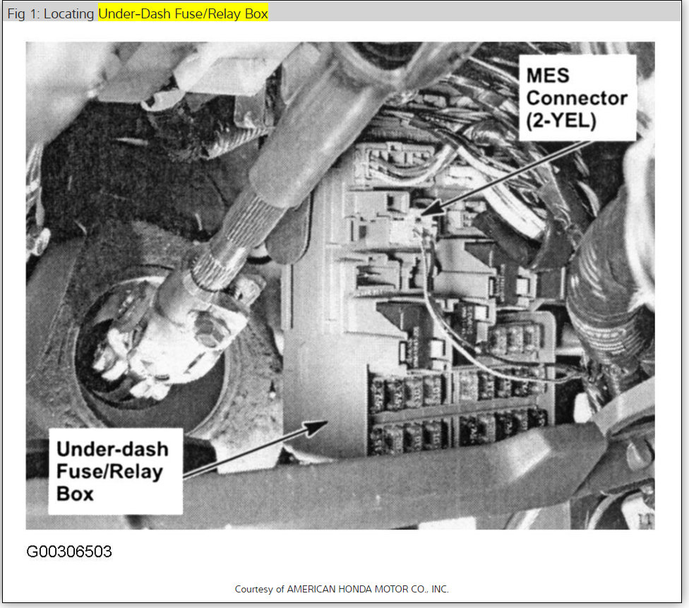

Here is the module location. Check out the diagrams (below).

BRADIX
  • 9 POSTS
I ended up disconnecting the harness of the security unit, central locking horn honk is now back again. but alarm disabled now. I guess it must have been disconnected the whole time after I got the car from the previous owner.

STEVE W.
  • 15,357 POSTS
I doubt it was disconnected as you had to disconnect it to get the system to honk. More likely is that something in the alarm unit failed and was blocking the horn signal.
Or one of the inputs to the alarm failed and wasn't turning it fully off.
