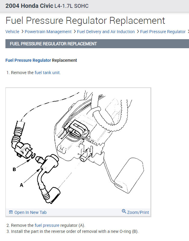

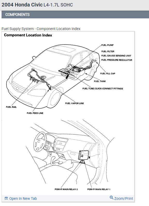

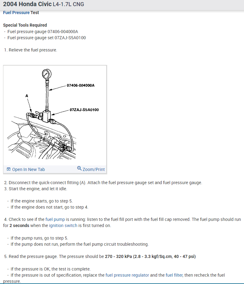

If the engine cranks over strong and fast but does not start till several tries to extra cranks then you could have an issue with the fuel pressure regulator. The fuel pressure regulator keeps constant pressure on the injectors. If the regulator is weak the the fuel can drain back to the tank and it will take few tries for the fuel to reach the engine and start.
This engine should have 40-47 PSI of fuel pressure with the engine off and key to the on position.
