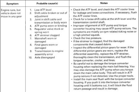

Helping my sister find out what's wrong with her civic. Yesterday was driving the car and it started slowing down even while her foot was still on the accelerator but the spedometer continued to read 45. She pulled over, turned it off, and when she restarted the car and put it in D it wouldn't move. She had the car towed and tried it again today and the car still slips when she puts it in D and won't move. Tranny fluid levels is ok. Any thoughts anyone? Thanks in advance
