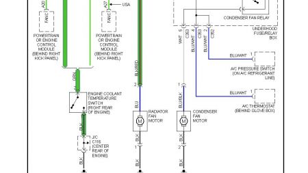

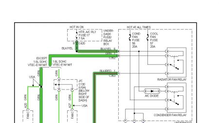

My Honda will run hot after sitting in traffic, I notice the fan to the radiator wont turn on, although the one to the ac works. I ran a wire from battery to fan wire directly and fan works. I switched the relay with condensor relay since both are the same and both work for the a/c fan but not cooling fan. I took a meter and tested the socket for ac relay and it read 12v, but the cooling fan socket didnt read, could the be a wire shortage, what would be the next step

Check fuse no. 57 20amp and test out the engine temperature switch-if circuit and switch is good its coming from the computer. See EWD
https://images.2carpros.com/forum/automotive_pictures/12900_cf1_8.jpg
https://images.2carpros.com/forum/automotive_pictures/12900_cf2_9.jpg
