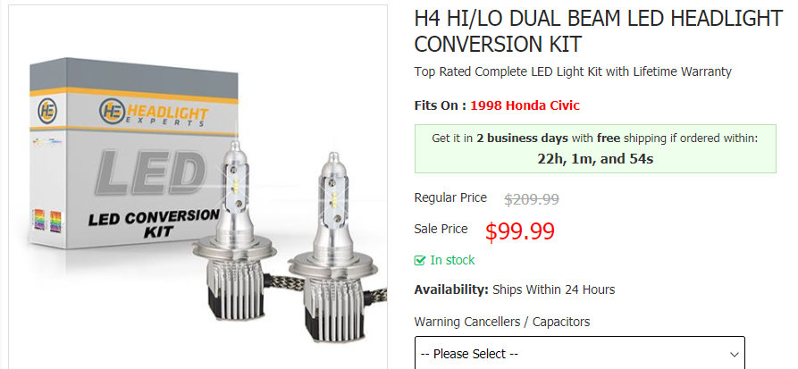

I am using Honda Civic 1998 model year car (back trunk, VTI engine), I noticed clarity of vision is not good when I drive. I decided to change all light's, headlight halogen bulb with LED light. Please guide me what's socket I choose? I am in doubt.

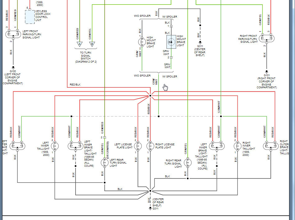

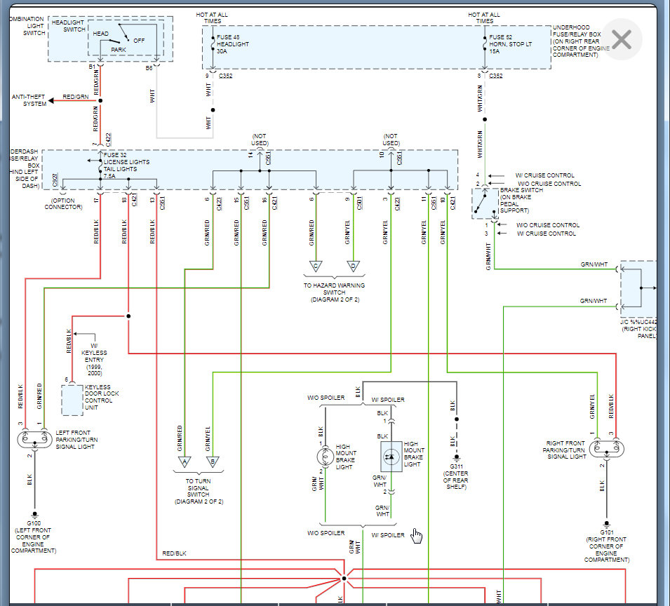

please also guide me parking light, brake lights, license plate light and dashboard light all me can replace with LED lights? And what's code or number? Waiting your answer
Wednesday, May 12th, 2021 AT 3:05 AM
This is not too complicated if you select the best kit for your vehicle.
Many people just purchase LED bulbs and plug them in and they don't work. LED bulbs have much lower resistance and don't work unless you compensate for that.
If you purchase a kit then it will come with built in resistors so that you should just need to plug them in and they should work. I attached the wiring diagrams and an example of a kit that would work.
Please let us know if you have other questions. Thanks
