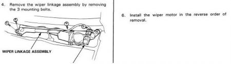

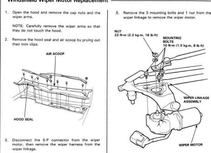

I agree with you. Now the problem I am getting is different. I looked at it and they are not sitting properly. I tired for 30 min and could not get it done. Can you just explain how they will sit in properly. They go inside but after I can't move them right or left. They don't move. I took out two bolts from top but I think there is no more in there. I don't know where is it. If I take it out its easier for me to fix it. It would be gr8 if you can expain it a bit. Thanks for your reply. I really appriciate.
Sunday, February 8th, 2009 AT 10:12 PM
F4I_GUY
  • 3,302 POSTS
I am having a hard time understanding exactly what the wiper blades are doing. Could you explain it better? From my understanding once they go down you cannot get them to wipe across the windshield again? If this is correct, you may have a wiper motor problem.
Have you taken the plastic trim off the vehicle yet to examine the transmission arms and linkages?
This is how you would remove the trim piece and linkages.
http://www.2carpros.com/forum/automotive_pictures/276698_wiper__motor_EG1_1.jpg
http://www.2carpros.com/forum/automotive_pictures/276698_wiper__motor_EG_2.jpg
