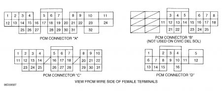

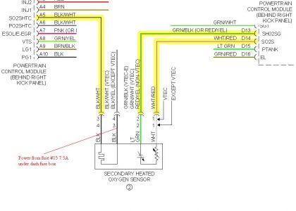

The guy that ran the codes on my car lives about 30 miles away and is not able to test my car, he also ran a test on another car so the my codes were not stored. Best he could give me was p0. Sorry.I talked to a mechanic I work with and he said it may be the wiring as well so im getting a voltage tester to test the wiring harness any suggestions on which wires to test. And if it is a wiring problem how much of a pain will it be to locate the bad wire?
Wednesday, February 11th, 2009 AT 8:24 PM
ZACKMAN
  • 4,202 POSTS
http://www.2carpros.com/forum/automotive_pictures/55316_97civicb1s2_1.jpg
http://www.2carpros.com/forum/automotive_pictures/55316_97civich02s_1.jpg
http://www.2carpros.com/forum/automotive_pictures/55316_97civicecm_1.jpg
Check continuity on all highlighted circuits. Repair any open circuit. If all circuits are good, replace the O2 sensor. It can be a major PITA to find bad wire. Just imagine you have to connect one end at the O2 sensor connector (under the car) and the other probe in the kick panel. Once you know the bad circuit to repair, ten you have to literally trace the wires. But it can be fun-filled, knowledge-seeking adventure.
Do you have an Autozone close by? They can can scan your ECM for free..
Wednesday, February 11th, 2009 AT 11:47 PM

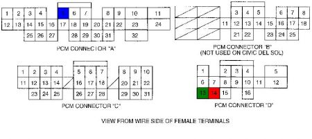

Unplug your rear O2 sensor (after the cat). Also unplug the corresponding connector plug on the PCM. CAUTION: Only unplug one harness at any one time. We are not testing the O2 sensor or the PCM, rather the wiring harness itself. So do not hook up the probes to the O2 sensor or PCM sides. Both probes have to be attached to the wiring harness plug.
Set your multimeter to resistance (ohm). Place one test lead to the connector end (at PCM) and the other at the O2 sensor.
1. PCM connector A5 (BLUE) and sensor side (black/white) wire.
2. PCM connector D13 (GREEN) and sensor side either green/black or red/yellow.
3. PCM connector D14 (RED) and sensor side white/red.
All 3 tests should result in 0 ohm reading. If you have any other number, that wire is bad.

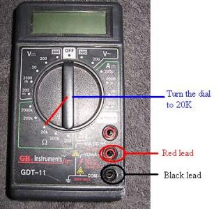

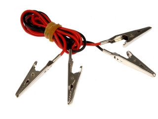

What I have is a GB Instruments GDT-11 so I can not test the ohm of the wires due to the fact that the wires on my tester are not long enough so I need an alternate way of testing the wire harness. Which wires do I test and what should they read?
Saturday, February 14th, 2009 AT 2:21 PM
ZACKMAN
  • 4,202 POSTS
http://www.2carpros.com/forum/automotive_pictures/55316_gbt11_1.jpg
http://www.2carpros.com/forum/automotive_pictures/55316_85654007_1.jpg
Attach extension wires such as Dorman 85654 to your test leads. Just make sure that they don't touch any metal of the car. "Zero" ohm means continuous wiring, "infinity" means bad or broken wiring.
