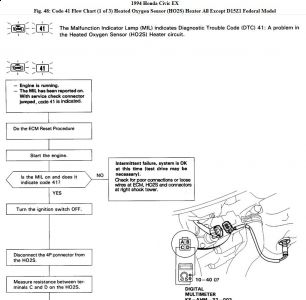

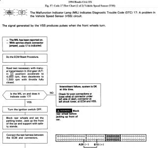

I have had an issue with my speedometer for sometime. Sometimes it shows my correct speed, then other times it just shows 0. I have replaced the Speed Sensor twice and it is still bad. Recently the CEL came on. The code was for the oxygen sensor. What do you think the issue is? Are the O2 and Speedometer problem related?

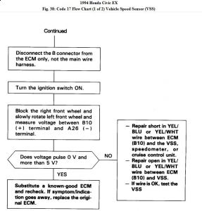

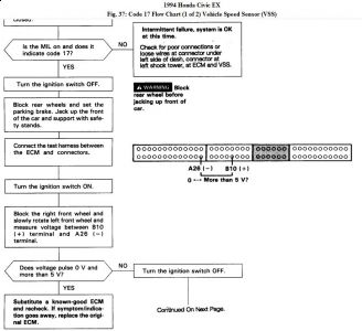

The VSS and O2 sensors are on different circuits so are not related.
After replacement of the VSS, did the problem go away for a short while before coming back?
If the VSS is not at fault, you would need to check the wire harness. Some connection might be poor somewhere causing the speedometer to fail intermittently.
What was the exact trouble codes retrieved for the O2 sensor?

After replacing the VSS the first time, the problem did go away but returned. However, after the last replacement, the VSS issue did not go away.

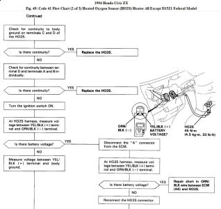

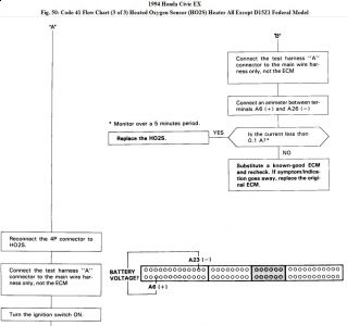

The code I am pulling is a code 41- primary O2 sensor heater malfunction.

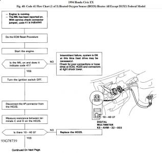

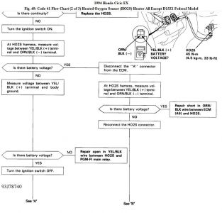

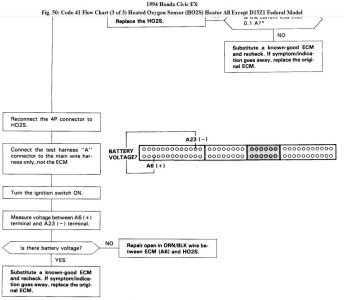

Used VSS might not be reliable and I would not rule out the possibility of a faulty unit. Here are the diagnostic procedures for the VSS and HO2S. Hope there are good if not let me know and I will send them in PDF format to your email.

https://images.2carpros.com/forum/automotive_pictures/192750_Code41_94CivicFig48a_1.jpg
https://images.2carpros.com/forum/automotive_pictures/192750_Code41_94CivicFig48b_1.jpg
https://images.2carpros.com/forum/automotive_pictures/192750_Code41_94CivicFig49a_1.jpg
https://images.2carpros.com/forum/automotive_pictures/192750_Code41_94CivicFig49b_1.jpg
https://images.2carpros.com/forum/automotive_pictures/192750_Code41_94CivicFig50a_1.jpg
https://images.2carpros.com/forum/automotive_pictures/192750_Code41_94CivicFig50b_1.jpg
