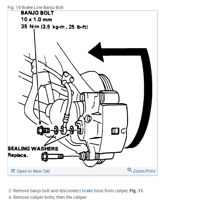

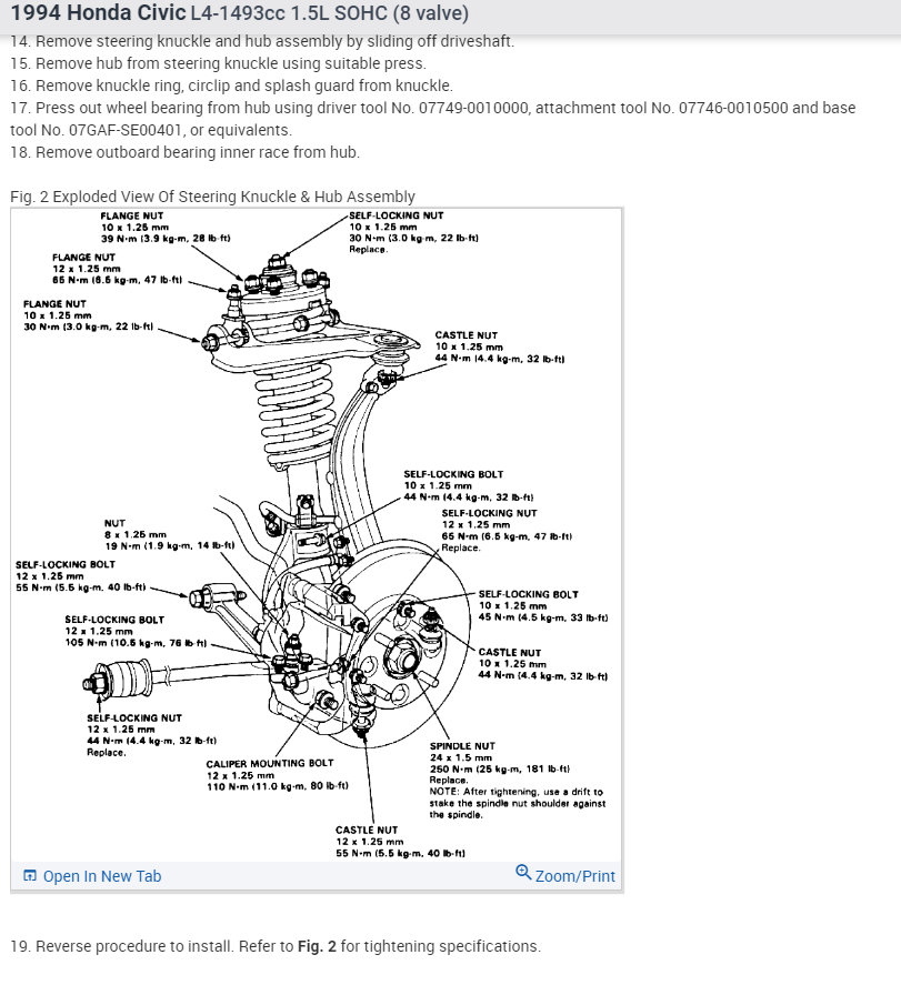

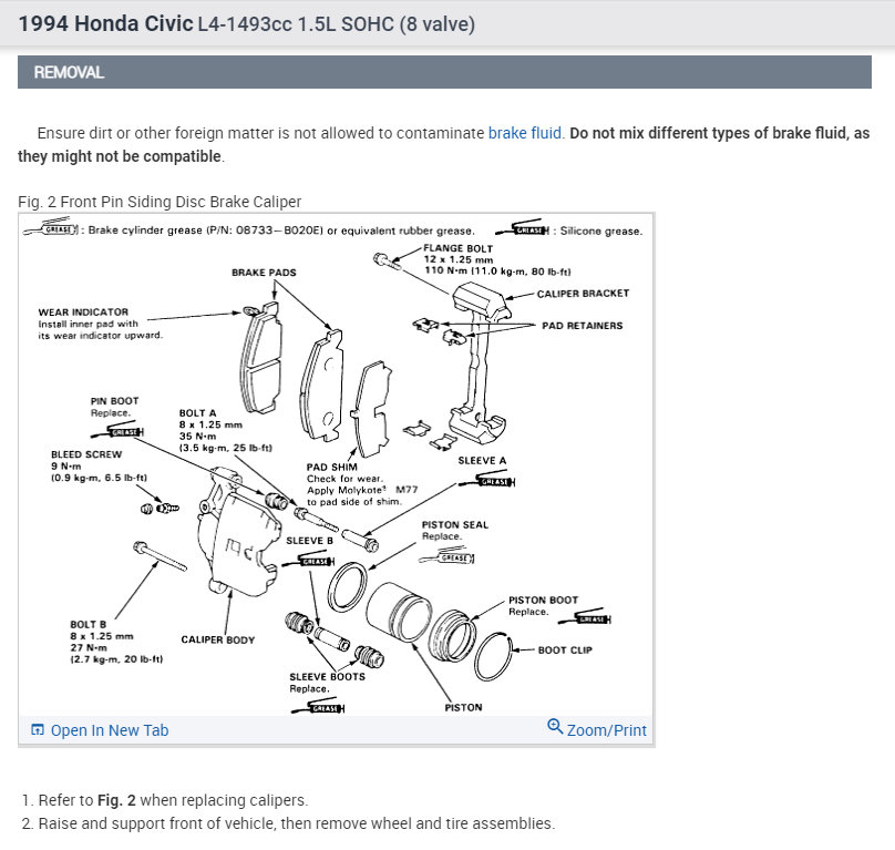

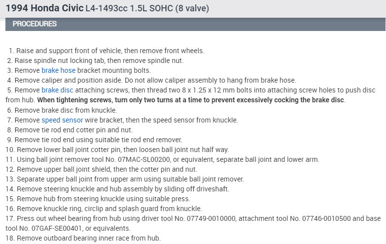

The rotor on this civic is not pressed on the hub.
If it is stuck on the hub after removing the bolts, then it is likely seized on the hub.
Simply tap the rotor with a hammer or mallet and it will come loose.
I have attached the replacement procedure for the rotors as well as pads for your reference.
